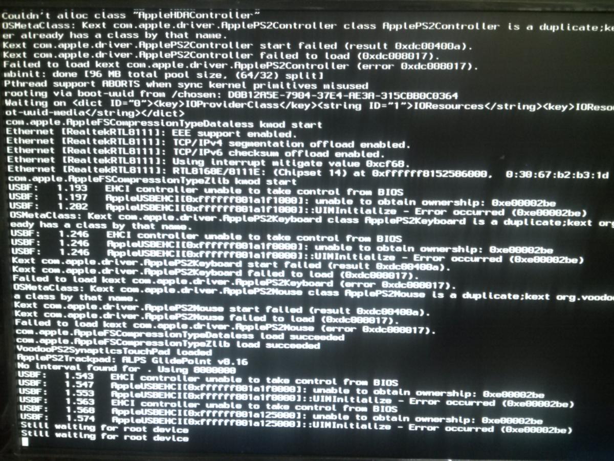

Boot problem. -still waiting root devices- message
install program doesn't work.
just 'still waiting root devices' message.
according to error message on screen, I think it's a problem about EHCI or PS2 mouse, Keyboard.
But in VMWARE, It works well.
Kext (PS2, fakeSMC, RTL8111) is in the USB for install.

have you used your usb installer only on one usb port? have you tried the other usb ports?
usb in legacy (mode)?
Share this post
Link to post
I have ran into the exact same issue while installing 10.9. 10.8 worked like a breeze, yet 10.9 would give me the "waiting for root device"
What worked for me was simply unplugging the USB dongle and plugging it back into a different USB 2.0 slot. It started carrying on.
