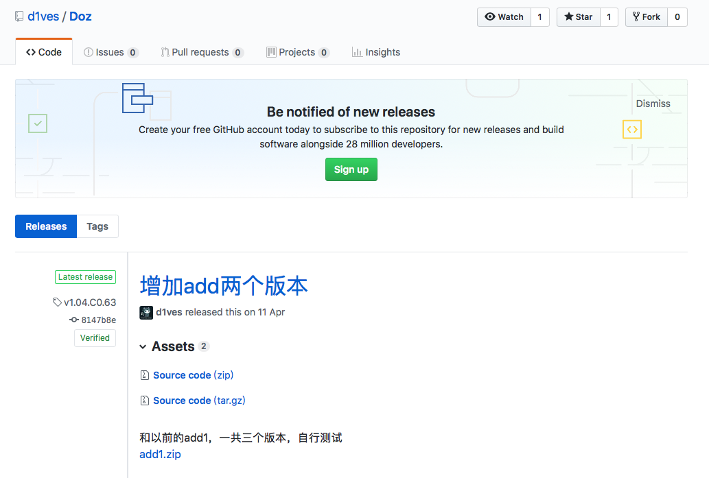

China's d1ves has developed doz can be compatible with 1151, I already in B250, Z270, Z370 can work, at present in Asrock, Gigabyte, Asus run very well, but this doz firmware requires KEY.PO key authorization, Create Series.po file in Efi:/efi folder, brush into Doz firmware to start get Series.po, this file is authorization file, need to use SERIES.PO to convert Key.po, then put Efi:/efi, restart activation doz,Unfortunately, each PC motherboard must be a separate key, otherwise it will not work
212598558_2018-08-176_19_39.png.4d05087041d003a20c404bd7f1f06348.png1883934471_2018-08-176_20_29.thumb.png.bc374c425c24ccdfdfe1256f3b5caad3.png
key.po
series.po
Share this post
Link to post
oh,it's archived,if you want to use it,sent your key to me with email or put here,i will give the key for you....
To be honest, compatibility is not very good, practicability is not very good, operability is not very good, personal entertainment works, difficult to ascend the hall of elegance.
good luck
god bless you
Share this post
Link to post
