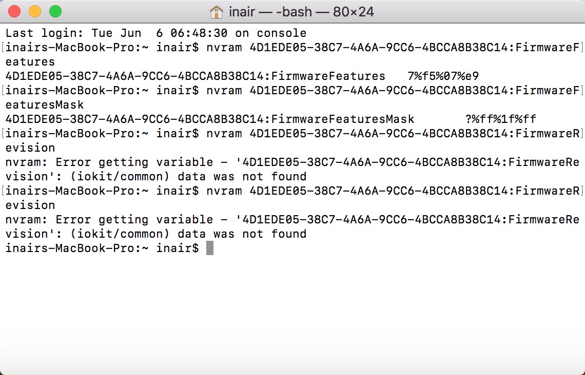

did you passed the OSInstall.pkg error with this FF & FFM? Should it work with iMac15,1? Ozmosis read it as strings?  :whistle:
Share this post
Link to post
no bro,Ozmosis read it as strings/data/number,i test them all
But it is of no damn use.

I can't tell if it makes that big of a difference but FirmwareFeatures /-mask, Revision and so on should be integer and a hex value... You can see it if you extract the OzmosisDefaults.plist from untouched but Ozm modified UEFIs after new Ozm releases in the past. It's also stated here: http://www.insanelymac.com/forum/topic/291655-ozmosis/page-159?do=findComment&comment=2192157and here: http://www.insanelymac.com/forum/topic/291655-ozmosis/page-95?do=findComment&comment=2062449
