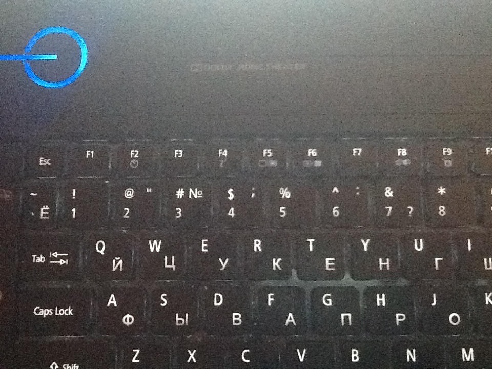

Alex009988 Posted August 18, 2013 Share Posted August 18, 2013 Do I have to shoot a video showing you how I can disable the touchpad from Fn+F3 and indicator light comes on only because of this custom PS2 map? Do you have Acer Aspire 8942G? Indicator is not usual key. It is connected with bios in powerful way. You maybe have a success on your equipment. But I have problem with wifi and touchpad indicator which almost impossible to solve on Mac. Wifi button works but without a light. Touchpad button works with light but it can be switched on/off only with the help of Windows. In conclusion, my F3 is clean! Link to comment https://www.insanelymac.com/forum/topic/291258-two-finger-scrolling/#findComment-1939706 Share on other sites More sharing options...

TimeWalker75a Posted August 18, 2013 Share Posted August 18, 2013 Do you have Acer Aspire 8942G? Indicator is not usual key. It is connected with bios in powerful way. You maybe have a success on your equipment. But I have problem with wifi and touchpad indicator which almost impossible to solve on Mac. Wifi button works but without a light. Touchpad button works with light but it can be switched on/off only with the help of Windows. In conclusion, my F3 is clean! If only you knew that keyboard controller works not only with keys that make up the keyboard layout but with extended keys as well. And your problem with LEDs comes from the same source where your ACPI sensor problem comes from - you can't be bothered to sit merely and decode your EC region, because everything related to keyboard controller (a.k.a. enhanced controller a.k.a EC) is published to EC RAM, which at most times is accessible from ACPI and via RWE. Link to comment https://www.insanelymac.com/forum/topic/291258-two-finger-scrolling/#findComment-1939709 Share on other sites More sharing options...
