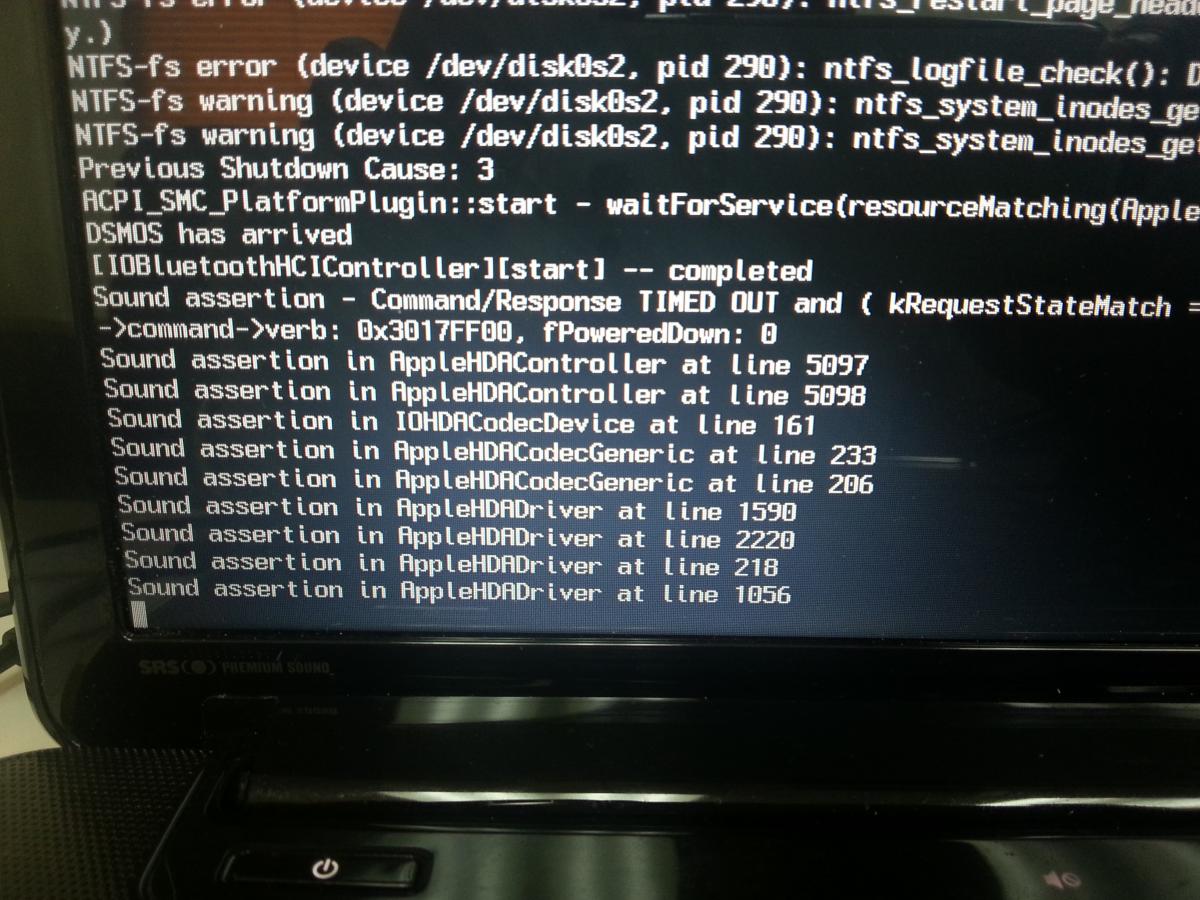

I can see two errors in verbose mode
1.- ACPI_SMC_PlatformPlugin::Start - waitForService(resourceMatching(AppleCPUPowerManagement) time out
2._ SuperIODevice: [Fatal] found unsupported ITE sequence ID=0xffff, Winbond sequence ID=0xffff (this appears one time before the installer begins to initialize filesystems, and then two times after IOBluetoothHCIController started)

I've tried to rebuild the kernelcache... man i don't know what the .... I did bacause my virtual machine got mess up big and got frozen, then it refused to boot. Thanks got I was just a VM... anyway... since I can not get a 'as vanilla as possible' OS X installation a gave Pandora's Box a try... but

Turns out it has something to do with the graphics :( while I was dowloading pandora i also was looking for info about kernelcache rebuild and found this tutorial
the troubleshooting Install section of that guide suggest that if the installer get stopped at boot or boot to a black screen then it's recommended to delete the following kext from /S/L/E
ATI = ATI*
Intel = AppleIntelHD* AppleIntelSNB*
nVidia = GeForce* NVDA*
Since my DV4 doesn't have a dedicated graphic card I just moved all the AppleIntelHD* and  AppleIntelSNB* to a backup folder, then tried to boot from USB and... Voila!!! Installer came alive... even was able to fire disk utility...
Now I need to research what's wrong with my Graphics... may be post-install link suggested by arthur-pt has something about it, the same site I mentioned above also has another troubleshooting section dedicated to graphics...

Forget about that, I'm starting to get something, My DV4 needs de Natit kext... right know I'm trying to find the right Framebuffer kext... I'm able to boot the installer but the screen is ?out of sync?
Regards
Tried varous Framebuffer from the guide mentioned above and my screen get scrambled every time, Good news.... I can use the original kexts that came with mountain lion installer... I just needed to add Natit kext in order to get the installer to boot
So far I need to inject this
DSDT.aml provided by Arthur-pt
Lattest FakeSMC
NullCPUPowerManagement
Natit.kext
Now, according to the guide natit.kext can be avoided by patching my DSDT... learning to do this is in my TODO list though

Got sound partially working (Speakers and both Front Headphones working, Internal Mic and Front jack not working) by patching my AppleHDA kext according to one of the guides suggested by Arthur-pt (Thanks dude)... Now, to be honest when I reached the part were layout12.xml and platforms.xml needs to be edited accordly to the inputs/ouputs of my code I got a brain melt and couldn't continue forward... fortunately for me this guy has same exact code as me and he managed to get its sound fully worked... I just replaced my layout12.xml and platforms.xml with the ones that are inside the kext he shared and voila... outputs are working.. Thanks dude... now I just need to figure out how to fix my microphone
Any help will be appreciated
