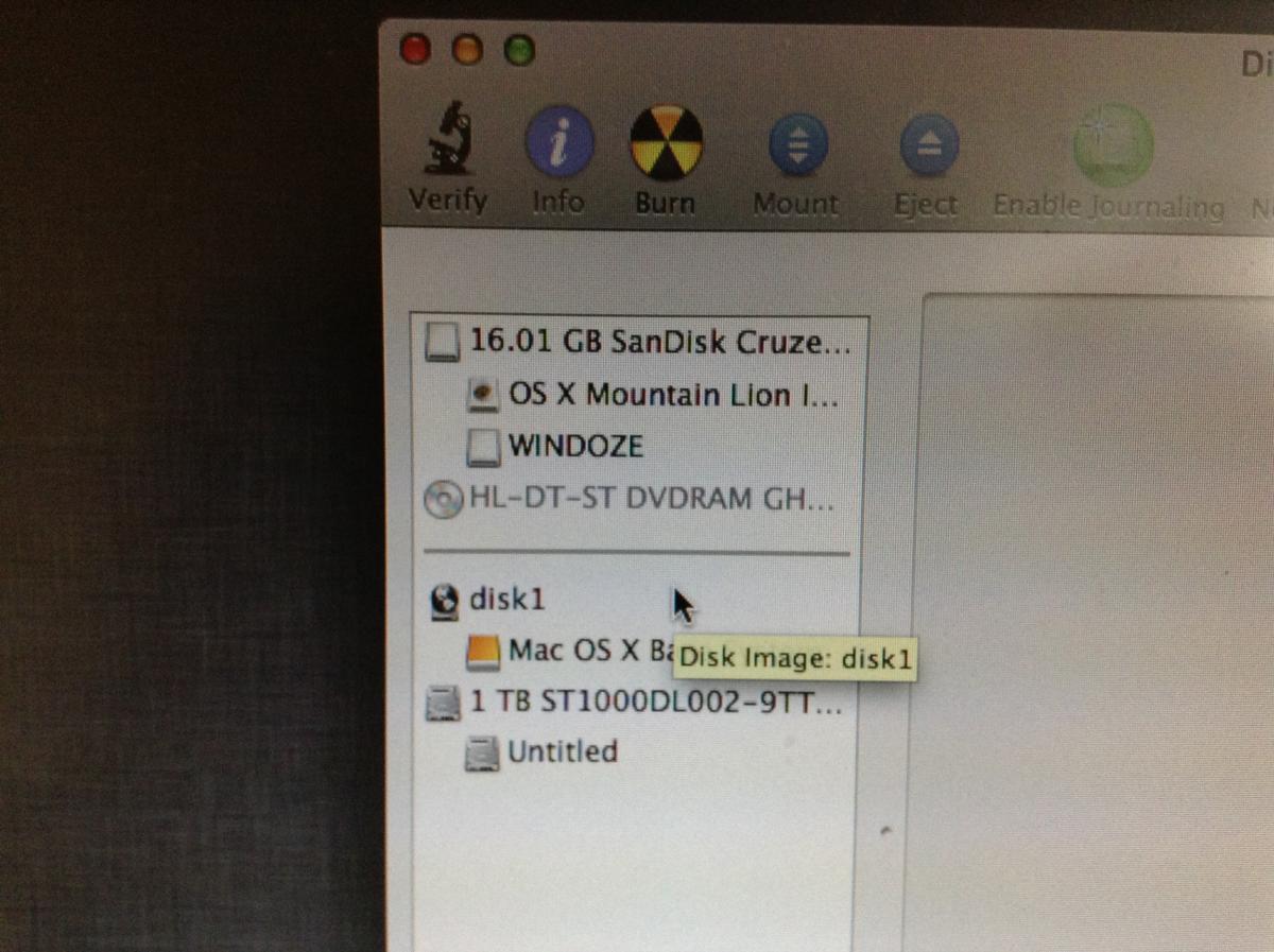

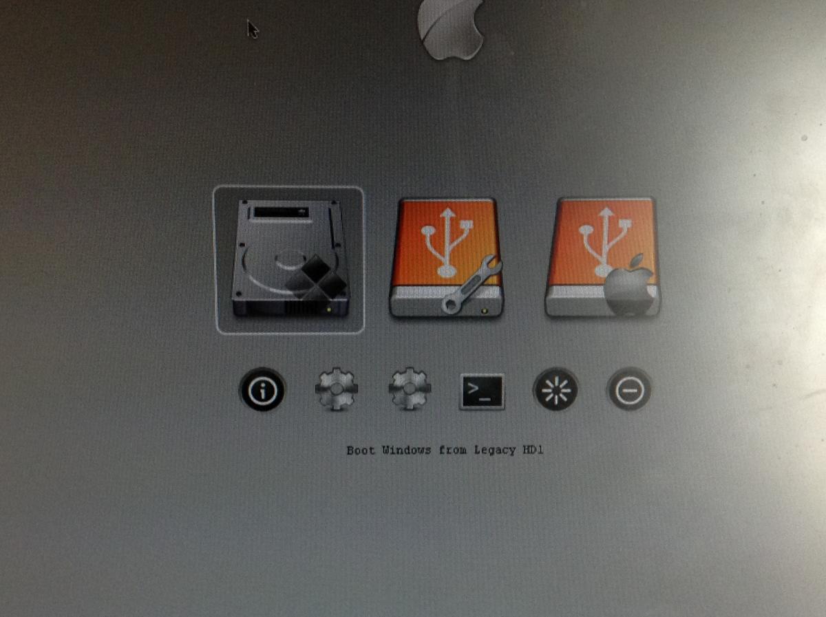

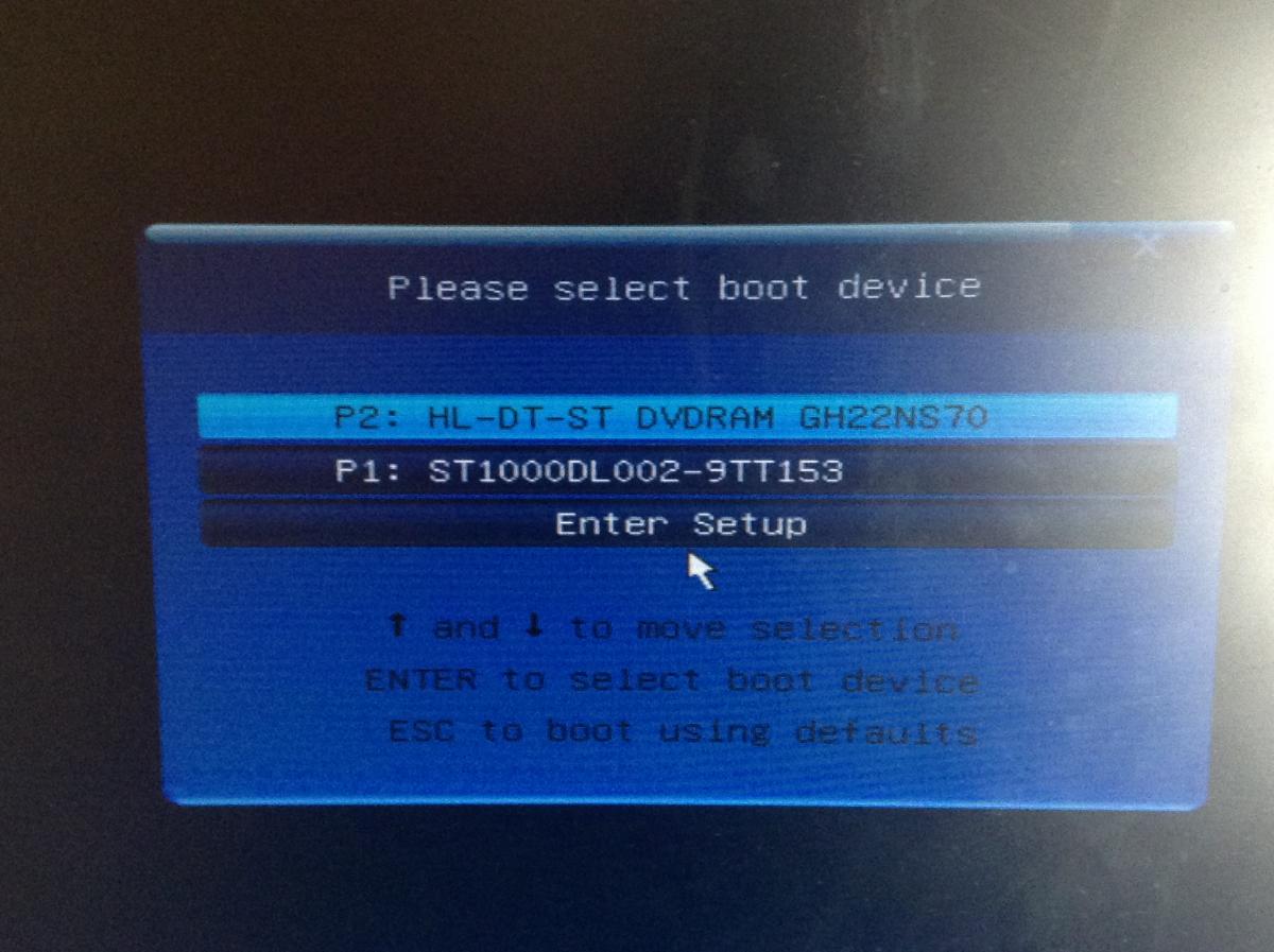

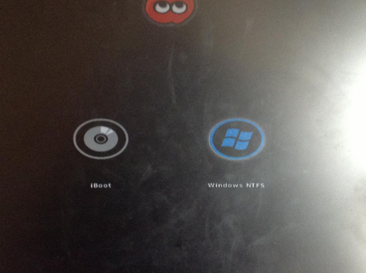

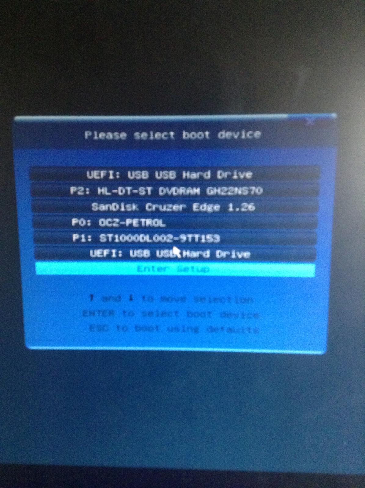

WilliamO7 Posted July 18, 2013 Author Share Posted July 18, 2013 I try to boot up my OSX SSD with my Bootable Clover USB Stick and it is nowhere to be found (there would normally be a hard drive icon with an apple by it): I am running the latest version of the bootloader, r1928 (at the time of posting) I then proceeded to boot into the Mountain Lion installer... Didn't show up in Disk Utility. I even tried to boot into it with iSoot to no effect: I then looked at the boot menu to see if it was there. It wasn't: Although last week a legacy option for the drive was available: And when I went to update the SSD firmware, it said there was no update available. EDIT: Tried reconnecting the SSD and booting it up with Clover. Wasn't shown. Went into disk utility on my USB stick... Disk Utility was so close to crashing, but it eventually managed to show the SSD... Clicked on it, and I couldn't erase or partition it. Link to comment https://www.insanelymac.com/forum/topic/290560-motherboard-refuses-to-boot-ssd-in-uefi-mode/#findComment-1933089 Share on other sites More sharing options...
