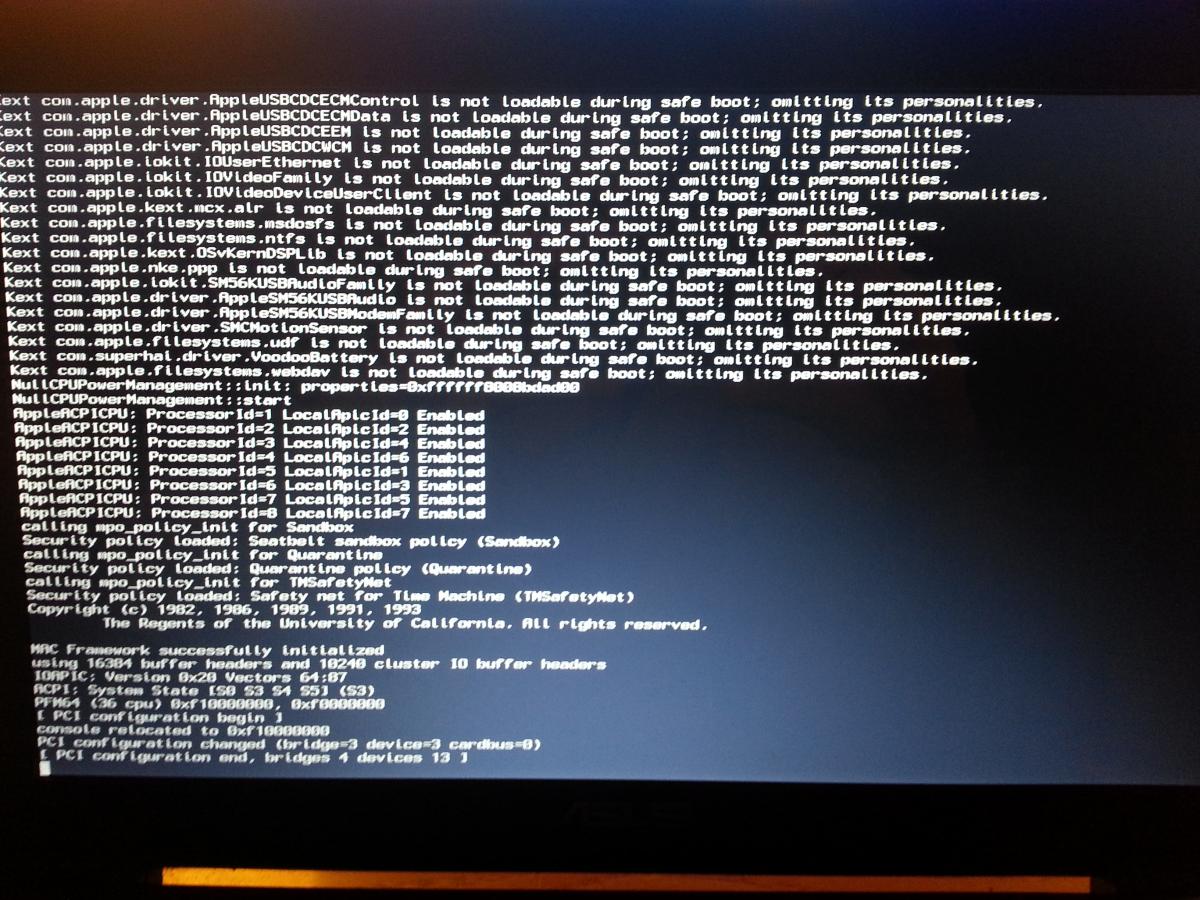

fabio8v Posted June 28, 2013 Share Posted June 28, 2013 hi guys I got this laptop, I tried to install M/L using My Hack and Pandora but nothing...of course I tried some switches.... this is the screen using Pandora Link to comment https://www.insanelymac.com/forum/topic/290216-asus-k55vd-i7-4g-intel-3000-nvidia-610m-ml/ Share on other sites More sharing options...
Rogiervd Posted June 28, 2013 Share Posted June 28, 2013 Need to download this and place into System/Library/Extensions/ http://www.osx86.net/view/16-nullcpupowermanagement_32--64-bit.html Link to comment https://www.insanelymac.com/forum/topic/290216-asus-k55vd-i7-4g-intel-3000-nvidia-610m-ml/#findComment-1928687 Share on other sites More sharing options...

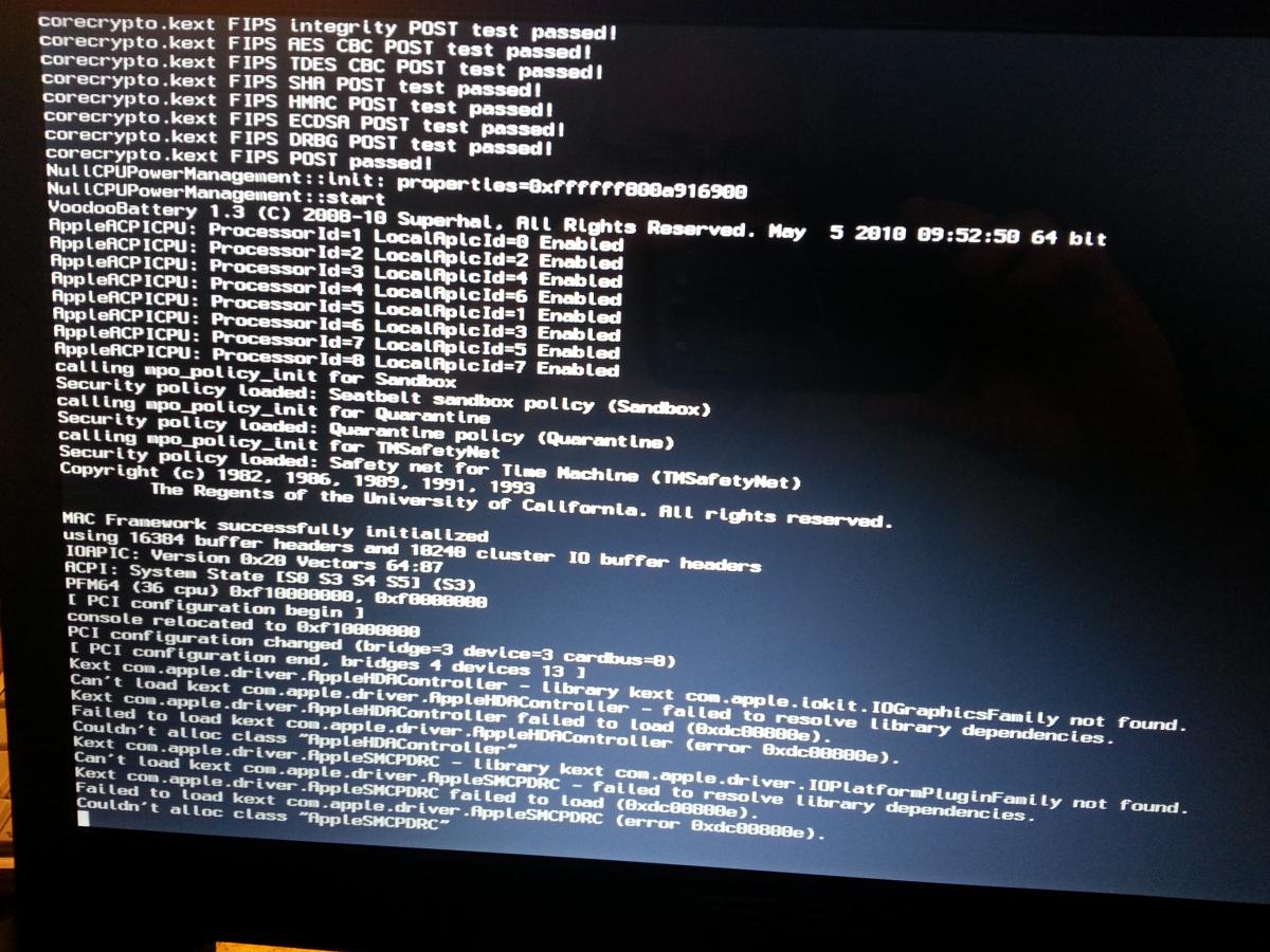

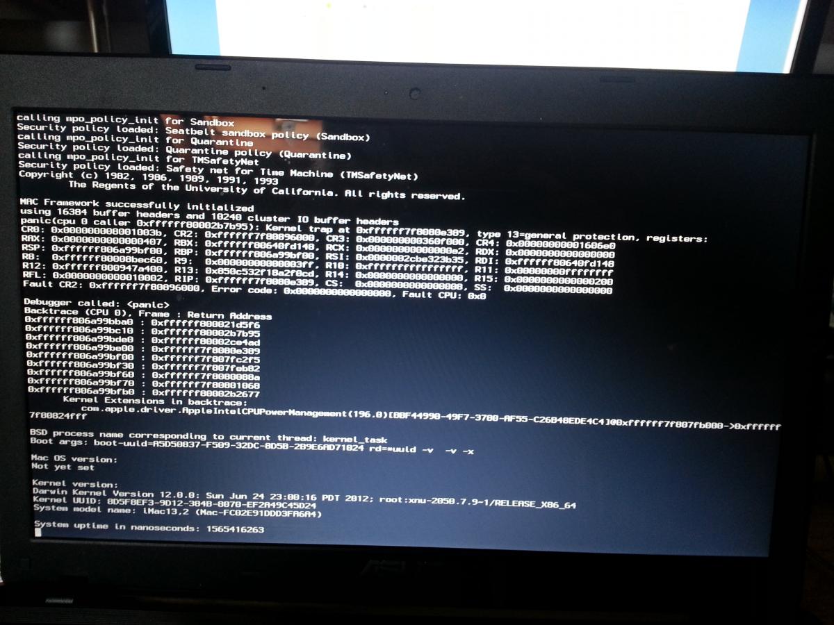

fabio8v Posted June 28, 2013 Author Share Posted June 28, 2013 Thank for your help...but now...still using -v -x it stops here.. if I start the pc just with -v he stops here if I start the pc just with -v he stops here oops...just the second one Link to comment https://www.insanelymac.com/forum/topic/290216-asus-k55vd-i7-4g-intel-3000-nvidia-610m-ml/#findComment-1928711 Share on other sites More sharing options...
Rogiervd Posted June 28, 2013 Share Posted June 28, 2013 I'm not sure. Try backup and delete the kext AppleSMCPDRC.kext from System/Library/Extensions and boot with -x -f -v Link to comment https://www.insanelymac.com/forum/topic/290216-asus-k55vd-i7-4g-intel-3000-nvidia-610m-ml/#findComment-1928737 Share on other sites More sharing options...
fabio8v Posted June 28, 2013 Author Share Posted June 28, 2013 there isn't any file with that name in s/l/e Link to comment https://www.insanelymac.com/forum/topic/290216-asus-k55vd-i7-4g-intel-3000-nvidia-610m-ml/#findComment-1928780 Share on other sites More sharing options...

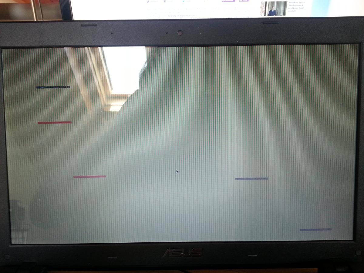

fabio8v Posted June 29, 2013 Author Share Posted June 29, 2013 at the end I got my M/L..just a problem..if I start using -x can go on the desktop otherwise the screen blinking as the vga is broken here is Link to comment https://www.insanelymac.com/forum/topic/290216-asus-k55vd-i7-4g-intel-3000-nvidia-610m-ml/#findComment-1928880 Share on other sites More sharing options...
Rogiervd Posted June 29, 2013 Share Posted June 29, 2013 For the 610m download the 2 kexts from here: http://www.osx86.net/view/3299-10.8.2_geforce_610m.html. If you get grey screen you need to add device properties for the card. U can create an efi string with this app: http://www.insanelymac.com/forum/topic/124911-osx86tools-final-release-is-here/. Link to comment https://www.insanelymac.com/forum/topic/290216-asus-k55vd-i7-4g-intel-3000-nvidia-610m-ml/#findComment-1928897 Share on other sites More sharing options...
fabio8v Posted June 29, 2013 Author Share Posted June 29, 2013 I got the solution...in the BIOS set the memory display to 64 Mb..not more Link to comment https://www.insanelymac.com/forum/topic/290216-asus-k55vd-i7-4g-intel-3000-nvidia-610m-ml/#findComment-1928898 Share on other sites More sharing options...
