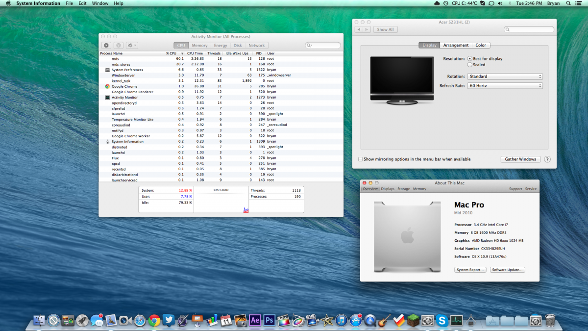

Bryan W. Posted June 11, 2013 Share Posted June 11, 2013 System: Asus P8P67 LE + Core i7 2600k Install Method: Used a MacBook Pro and a SATA to USB adapter to do a direct target install Used THIS Chameleon (2.2 svn r2246) Used THESE FakeSMC & AppleIntelCPUPowerManagement kexts BIOS is patched via Bios Repo Status: CPU: Works great. Benchmarks reveal no loss of performance GPU: Works out of the box. Full resolution + multi monitor support. Ethernet: Fixed with lnx2mac's RTL81xx kext. Audio: Fixed with AppleHDA.kext for ALC892. Apps: App store & messaging works out of the box. Sleep: Works out of the box even with NullCPU and no SleepEnabler. Due to patched BIOS. USB 3.0: Does not work out of the box. Link to comment Share on other sites More sharing options...
rockinron_1 Posted June 11, 2013 Share Posted June 11, 2013 Interesting your setup is very similar to one of mine which isn't completely working. I noticed you've got no framebuffer loaded for the HD6870, did you get it to boot with GraphicsEnabler=Yes? Link to comment Share on other sites More sharing options...
Bryan W. Posted June 11, 2013 Author Share Posted June 11, 2013 Interesting your setup is very similar to one of mine which isn't completely working. I noticed you've got no framebuffer loaded for the HD6870, did you get it to boot with GraphicsEnabler=Yes? Yes, as the 6870 is a native card, everything works with GraphicsEnabler=Yes. Link to comment Share on other sites More sharing options...
golephish Posted June 12, 2013 Share Posted June 12, 2013 Yeah I got the 6870 to work out of box as well. just having a sleep issue at the moment ;( Link to comment Share on other sites More sharing options...
rockinron_1 Posted June 12, 2013 Share Posted June 12, 2013 Hmmm.. Have you both managed to get framebuffers to load? In about this mac is should say your exact card model, not 6xxx? Link to comment Share on other sites More sharing options...
Bryan W. Posted June 12, 2013 Author Share Posted June 12, 2013 Hmmm.. Have you both managed to get framebuffers to load? In about this mac is should say your exact card model, not 6xxx? I'm thinking that might be a cosmetic issue as all QE/CI and ports work on the card with multiple monitors. Also, DVD player and Steam work as expected. Link to comment Share on other sites More sharing options...
