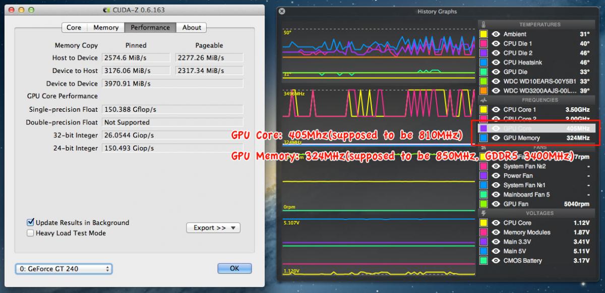

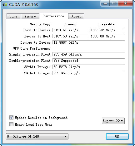

copperboy Posted April 24, 2013 Share Posted April 24, 2013 [updated]: I am thinking that Apple is doing something special to make the graphic performance of hackintosh staying half. I don't have many cards to prove this. If you guys are interested, please post CUDA-Z screenshot compared to CUDA-Z in Windows. CUDA-Z can be found here: http://cuda-z.sourceforge.net/ [Old Post] I thought I had built a perfect mackintosh, but I was wrong. The GPU kept running at half speed I changed smbios from MacPro 3,1 to iMac 12,2, and I noticed that AppleGraphicsPowerManagement.kext was loaded, but the GPU was still running half speed no matter I kept AppleGraphicsPowerManagement.kext or had it removed. Please see the pictures. Performance in Windows 7 is much higher than that in OS X. === Software === OS X: Mountain Lion 10.8.3 Method:Un1beast + Mu1tibeast + DSDT CPU Speedstep: Perfect Sleep, Wakeup, Restart, Shutdown: Perfect LAN, Audio: Perfect (Yes, even recording from mic) === Hardware === Gigabyte GA-EP43-US3L Pentium Dual Core E6300 Nanya 2GB DDR2-1066 *2 Gigabyte GeForce GT240 with 512MB GDDR5 WD 320G SATA HDD Link to comment https://www.insanelymac.com/forum/topic/288112-hackintosh-gpu-half-speed-proving-needed/ Share on other sites More sharing options...
copperboy Posted April 24, 2013 Author Share Posted April 24, 2013 I re-flashed the bios of GT240, nothing changed. I removed AppleGraphicsPowerManagement.kext in order to keep the gpu running at full speed, but it kept half of the speed it should be. I edited the plist file in AppleGraphicsPowerManagement.kext, the problem still exists. I am thinking that Apple is doing something special to make the graphic performance of hackintosh staying half. I don't have many cards to prove this. If you guys are interested, please post CUDA-Z screenshot compared to CUDA-Z in Windows. CUDA-Z can be found here: http://cuda-z.sourceforge.net/ Link to comment https://www.insanelymac.com/forum/topic/288112-hackintosh-gpu-half-speed-proving-needed/#findComment-1910138 Share on other sites More sharing options...
