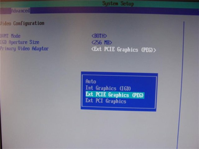

edipo2s Posted September 3, 2013 Share Posted September 3, 2013 I have flashed a modded BIOS that unlock the advanced menu. But in video configuration I don't understand how to disable the integrated. =/ Any idea? here the picture Link to comment https://www.insanelymac.com/forum/topic/287995-how-to-launch-ati-card-by-dsdt/page/4/#findComment-1943003 Share on other sites More sharing options...

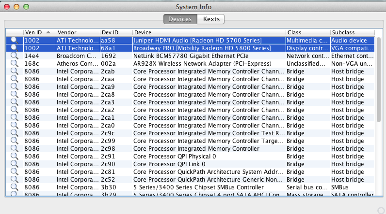

Alex009988 Posted September 3, 2013 Author Share Posted September 3, 2013 Oh. Greate! See Primary Video adapter to disable it, like this -------- Afterwards, Use this program to check on how many ATY devices you have. System Info.zip Link to comment https://www.insanelymac.com/forum/topic/287995-how-to-launch-ati-card-by-dsdt/page/4/#findComment-1943041 Share on other sites More sharing options...
edipo2s Posted September 8, 2013 Share Posted September 8, 2013 I have bad new man, after I change the Primary Graphic Adapter to 'Ext Graphics (PEG)', my notebook don't show more anything in the screen. I took out the battery and left out all night to see if it reset the bios settings but still the same. And there is the LED on the caps lock is just blinking at 5 times. With pen drive recovery bios (following this tutorial http://donovan6000.blogspot.com.br/2013/06/insyde-bios-modding-hp-brick-recovery.html) also did not succeed, put the USB drive, secure Win + B, push the button and turn, and after about 3 seconds, and is direct only beeping. I waited about two minutes but nothing changed. :'( Link to comment https://www.insanelymac.com/forum/topic/287995-how-to-launch-ati-card-by-dsdt/page/4/#findComment-1944141 Share on other sites More sharing options...
Alex009988 Posted September 8, 2013 Author Share Posted September 8, 2013 Year, problems with bios are serious. Bios is what a computer is. What you can try. Return old parameters of graphics blindly, if you remember each step. Dig the internet in order to find another solution. Restore bios with the help of progromator on your own or ask service center to do that instead. Link to comment https://www.insanelymac.com/forum/topic/287995-how-to-launch-ati-card-by-dsdt/page/4/#findComment-1944152 Share on other sites More sharing options...
