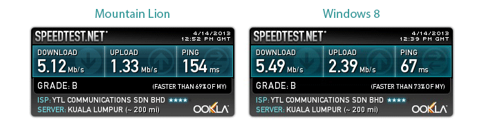

sdjiklafjsjfioejiaisjfioas Posted April 14, 2013 Share Posted April 14, 2013 Hello, I recently built a hackintosh and with it, bought a TP-Link TL-WDN400 which (according to Tonymacx86 users) should work OOB. I've got it working with no problems whatsoever, but the speeds seem throttled and I can't seem to find a way to fix this. Have others experienced the same problems? On my Hackintosh I get 9.51mbps down while I get 16.04mbps down on my MacBook which is sitting right beside my Hackintosh. (Hackintosh) (MacBook) I'm using a GIGABYTE Z77X-UP5 TH Motherboard, Intel i5-3570k processor. Thank you! Link to comment https://www.insanelymac.com/forum/topic/287881-tp-link-tl-wdn4800-slower-on-hackintosh-than-macbook/ Share on other sites More sharing options...
fau7i Posted April 14, 2013 Share Posted April 14, 2013 Definitely it works OOB in hackintosh. Fortunately I don't see any significant difference here when comparing the result from OS X and Windows. Link to comment https://www.insanelymac.com/forum/topic/287881-tp-link-tl-wdn4800-slower-on-hackintosh-than-macbook/#findComment-1906872 Share on other sites More sharing options...
sdjiklafjsjfioejiaisjfioas Posted April 14, 2013 Author Share Posted April 14, 2013 Definitely it works OOB in hackintosh. Fortunately I don't see any significant difference here when comparing the result from OS X and Windows. I've already tried reinstalling OSX and changing system definitions, with no success . Did you have to change any networking settings or was it just plug & play? Link to comment https://www.insanelymac.com/forum/topic/287881-tp-link-tl-wdn4800-slower-on-hackintosh-than-macbook/#findComment-1906877 Share on other sites More sharing options...
sdjiklafjsjfioejiaisjfioas Posted April 14, 2013 Author Share Posted April 14, 2013 OK, I *think* I've fixed the issue. Plugged the TL-WDN4800 in a PCIEX8 slot and voila! I have no idea why it did not work in the smaller PCIE slot, but it works now. Link to comment https://www.insanelymac.com/forum/topic/287881-tp-link-tl-wdn4800-slower-on-hackintosh-than-macbook/#findComment-1907007 Share on other sites More sharing options...
