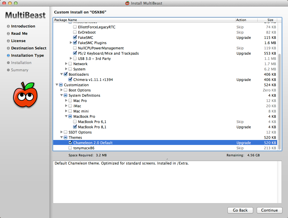

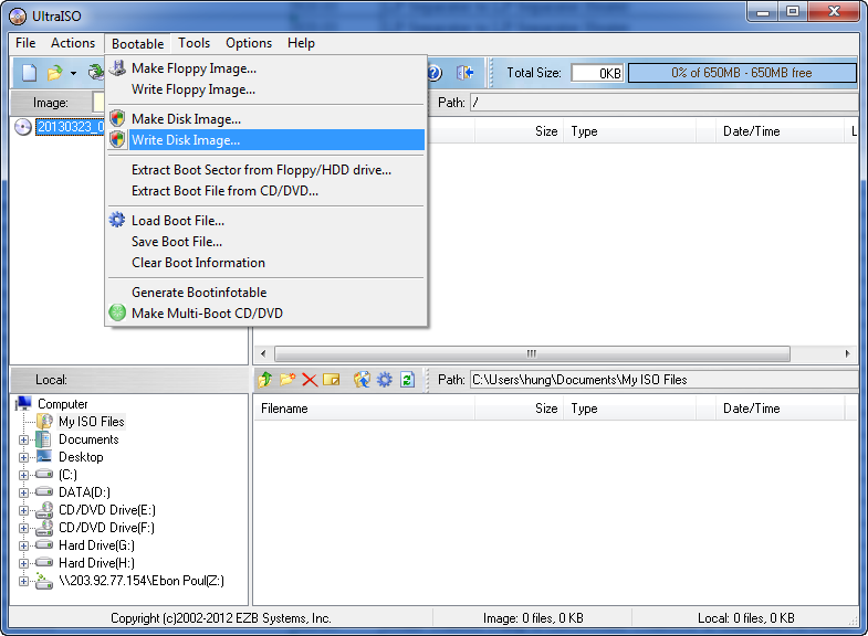

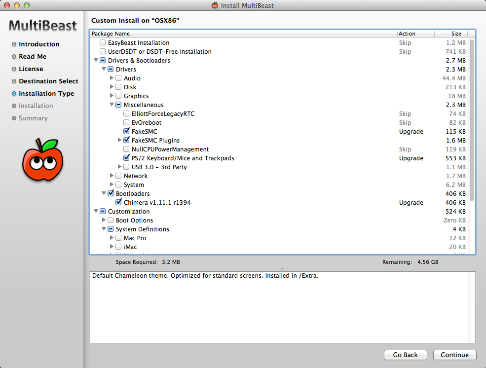

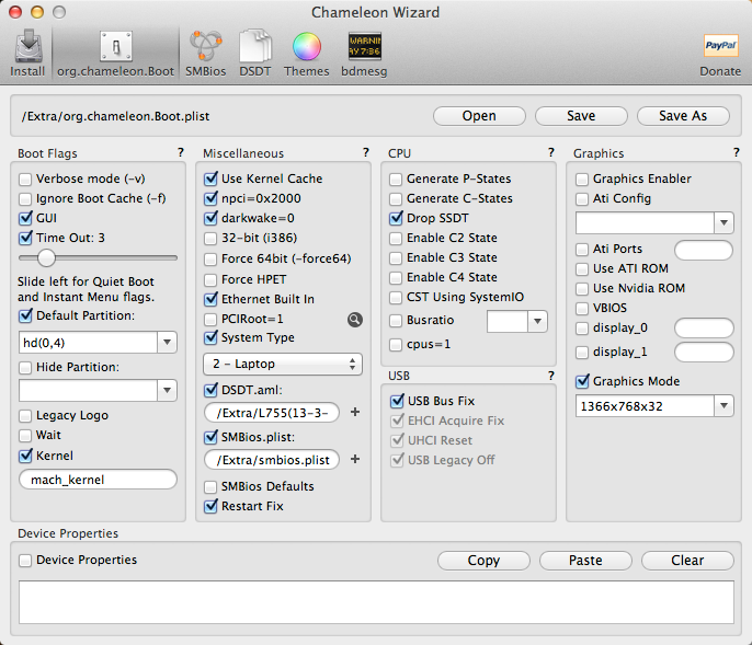

tranduyquang Posted March 23, 2013 Share Posted March 23, 2013 Install ML 10.8.3 from USB for Toshiba L755/L750 laptop (no need any Macintosh environment). Toshiba L755 spec: 1. Cpu i5 2450M: native speedstep with patched BIOS and SSDT 2. VGA GT 525M: DSDT, HDMI video 3. Sound Conexant Cx20585: DSDT, patched AppleHDA (HDMI audio not working) 4. Wifi AR9285: DSDT, no kext, QE/QI 5. Lan AR8151: kext 6. USB 3.0: kext 7. Fn key: able to adjust audio volume, brightness 8. Bluetooth: not working, no kext 9. Keyboard, touchpad: kext from mutibe*ast Requirement: 1. One usb 8Gb, one usb 1Gb (or more capacities) 2. ML install package 3. SUSE Studio Image Writer 4. GParted Live CD/USB/HD/PXE Bootable Image 5. Download ultilities for ML (multibe*at, kext wizard, kext ultility, chameleon wizard, chameleon) 6. Download necessary kext for Toshiba L755(patched AppleHDA, AppleSmartBatteryManager, AtherosL1cEthernet, IOUSBFamily) 7. Download AHCI patcher (need for case “Still waiting for root device…”) 8. Download “ extra ” folder for L755 laptop 9. Download UltraISO 10. Pached BIOS: native speedstep for ML Preparation: 1. In windows: a. Use Disk Management to creat one partition for Macos installation, recommend more than 20Gb capacity. b. Delete (unformat) that partition 2. In windows: a. Make an installation USB of Macos on 8Gb thumb drive: follow this guidance b. Make a bootable GParted Live USB: use UltraISO to open the downloaded Gparted ISO file. Bootable-->Write Disk Image… 3. In windows: Place all kext, tool, extra folder…into a folder in order to easily find out when we’re in Macos (E.g. I place at D:\macos\installation) 4. Patching BIOS: CodeRush a. Download Toshiba L755 BIOS newest (ver 3.6) : b. Patching tool c. Progressing: - After extract everything from downloaded bios, you will have this: sk1wv360\os2012321a_360\Madrid20R20RG_BIOS_WIN_V360\ x64 \ BIOS.fd - Unzip downloaded tool, rename folder to "PMPatch" and place at C:\ - Copy the original BIOS.fd to "pmpatch" folder (Note: My windows is 64 bit version. If you install x86 then chose BIOS.fd from x86 folder) - Open CMD, run command "cd C:\PMPatch" - Patch bios, run command "pmpatch C:\PMPatch/BIOS.fd C:\PMPatch/patchedBIOS.fd" - Rename patchedBIOS.fd to BIOS.fd and replace for the original once in "sk1wv360\os2012321a_360\Madrid20R20RG_BIOS_WIN_V360\ x64 \ BIOS.fd " (pls take note x86 or x64) - Flash your bios: run InsydeFlashx64.exe in "x64" folder (or InsydeFlash.exe in x86 folder). PLEASE ENSURE that you are on AC and your battery remain more than 50% power. Windows then auto restart. Done. 5. Boot from Gparted usb and format the “deteled/unformatted partition” that just prepared for Macos installation, format it as HFS+ 6. Boot from Macos Installation USB, use Disk Ultility to make “Journaled” said partition 7. Install ML 8. Install mutibeast: 9. Install chameleon wizard, copy things to extra folder Be careful that you have a correct SSDT for your CPU 10. Install kexts. Repare cache with Kext Utility. Credit: CodeRush Bcc9 Pernacabeluda Pere Zenith432 Shailua RehabMan Link to comment https://www.insanelymac.com/forum/topic/287314-guide-toshiba-l755l750-ml-1083-no-need-any-macintosh-environment/ Share on other sites More sharing options...
