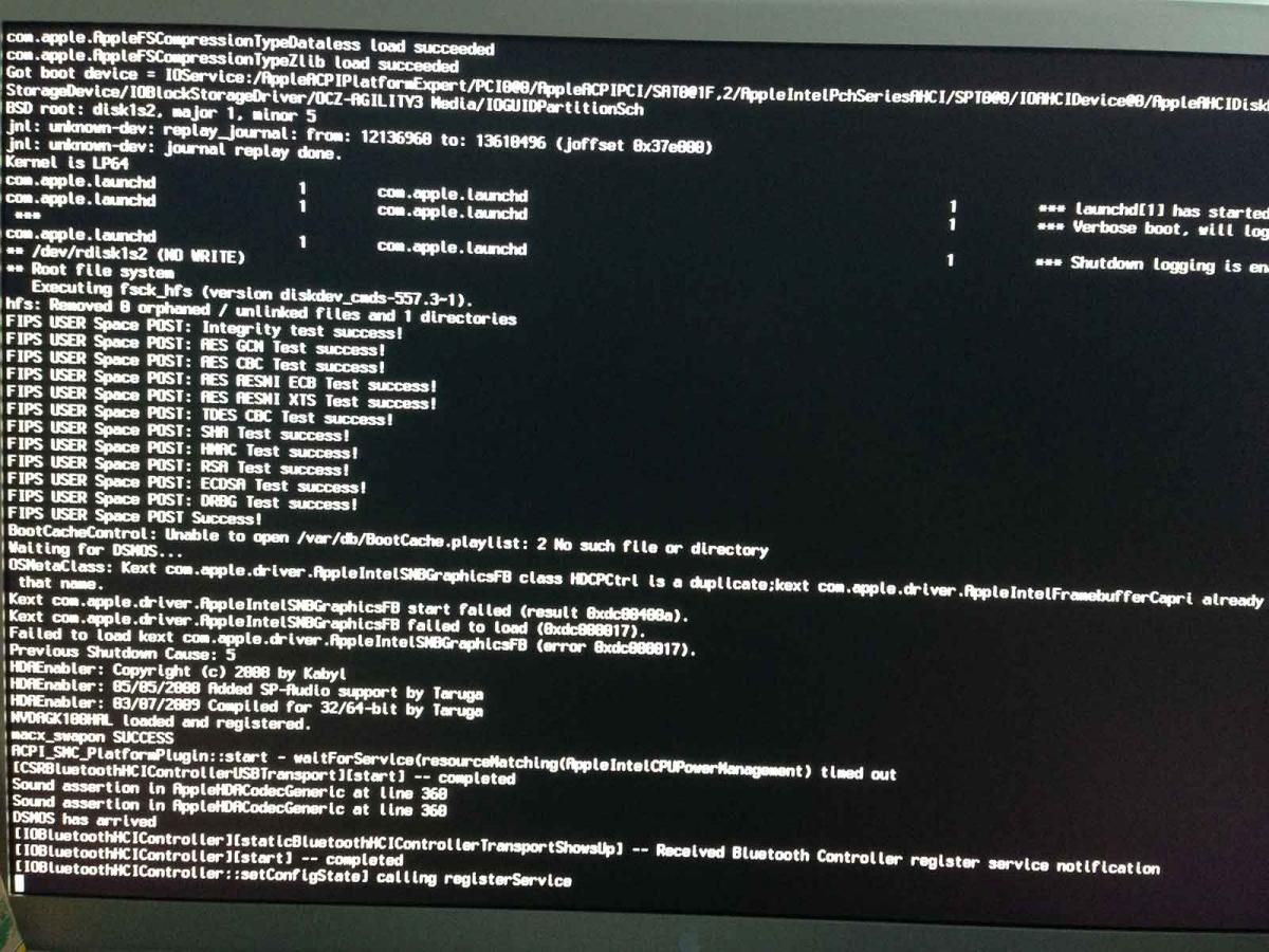

fresch Posted March 18, 2013 Share Posted March 18, 2013 Hi Guys. So im running Mountain Lion 10.8.2, with Chameleon Bootloader. Everything was great, until I got new hardware. I switched from: Mainboard: Asrock z68 GPU: Geforce 560ti to Mainboard: Asrock z77 Fatal1ty GPU: Geforce 660ti And now I cant boot my system anymore Im getting this error when booting in Verbose mode. Can anyone help me out? Link to comment Share on other sites More sharing options...
artur_pt Posted March 18, 2013 Share Posted March 18, 2013 hello remove from the installer all appleintelhd*.* or disable in bios u hd 4000 good hack Link to comment Share on other sites More sharing options...
fresch Posted March 18, 2013 Author Share Posted March 18, 2013 How do I remove that? In the Bios I cant Disable or Enable GPU. I can only select one of them - Currently the PCIexpress Port GPU (Geforce 660ti) is selected. Link to comment Share on other sites More sharing options...

theconnactic Posted March 19, 2013 Share Posted March 19, 2013 Did you try simply using GraphicsEnabler=No? If not, visit www.rampagedev.wordpress.com and check if there's some solution there for you. Perhaps a DSDT injection (but AFAIK Kepler graphics should work OOB). All the best! Link to comment Share on other sites More sharing options...
