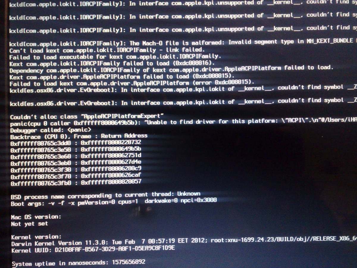

ZaDoR Posted February 28, 2013 Share Posted February 28, 2013 Good morning people, I have HP Pavilion G7 1239sg i3 2330m,Radeon HD6470M + HD3000, 4GB RAM 1333Mhz , my problem is when i starting to install a latest iATKOS distro or any other im geting panic. local APIC error , ESR:64\n"@/sourceCache/xnu/xnu-2050.18.24/osfmk/i386/lapic_native.c715 cpu was seted "1" Link to comment Share on other sites More sharing options...
iFIRE Posted February 28, 2013 Share Posted February 28, 2013 you need Lapic kernel for HP Users, change the kernel in your USBInstaller, or you can try boot with this flag: -f -v -x GraphicsEnabler=No cpus=1 npci=0x2000 The all-in-one guide to Vanilla OS X Mountain Lion + Chameleon + DSDT for beginners http://www.insanelymac.com/forum/index.php?showtopic=280756 1 Link to comment Share on other sites More sharing options...
ZaDoR Posted February 28, 2013 Author Share Posted February 28, 2013 i done installation with command which ignores panic, and sadenly im already forgot it it was starting like pm....=0 but after restart im stacks when its trying to load bluetooth devices which i doesnt even have does anyone know this command to ignore panic? Link to comment Share on other sites More sharing options...
iFIRE Posted February 28, 2013 Share Posted February 28, 2013 post a photo of the Kernel Panic, try the same boot flag: -f -v -x GraphicsEnabler=No cpus=1 npci=0x2000 2 Link to comment Share on other sites More sharing options...

ZaDoR Posted February 28, 2013 Author Share Posted February 28, 2013 solved !!!! 1st: changed kernel in distro 2nd: -v -x -f pmVersion=0 so i could proceed the installation. Thats all folks. trackpad working camera working usb working soundcard working Wi Fi doesnt Ethernet doesnt i dont tested yet HDMI and the second grafik card, resolution its too low even if i choosed 1600x900 and lower... Link to comment Share on other sites More sharing options...
ZaDoR Posted February 28, 2013 Author Share Posted February 28, 2013 (edited) so its becomes even worst, now i cant install nothing except Windows. i changed USBs , HDDs now it doesnt want to boot from anywhere not from DVD not from USB not from HDD. option 1: when its tryin to boot i gettin message that mac have to restart without installation option 2: changed media booting from DVD after i press enter the screen stays black option 3: before i wiped all USBs and HDD says cant find mach_kernel even when i re installed it few times. any idea ppl? Edited March 1, 2013 by ZaDoR Link to comment Share on other sites More sharing options...
