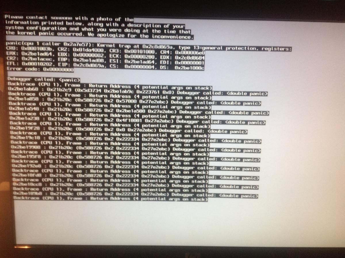

Naxx Posted February 20, 2013 Share Posted February 20, 2013 Hello everyone, I installed Snow Leopard 10.6.2 successfully but at Apple logo, after reboot, a kernel panic appears and it can't boot. I have: - Intel Pentium D Dual Core 925 3.0 Ghz - Motherboard Acer E415SM - NVIDIA GeForce 7500 LE 128 mb - RAM DDR2 1,5 gb Could someone help me? Do you need a picture of the error too? Thanks for any answer, Naxx Quote Link to comment https://www.insanelymac.com/forum/topic/286527-kernel-panic-at-apple-logo-hazard-1062/ Share on other sites More sharing options...
iFIRE Posted February 20, 2013 Share Posted February 20, 2013 Could someone help me? Do you need a picture of the error too? Yesss!!!! Quote Link to comment https://www.insanelymac.com/forum/topic/286527-kernel-panic-at-apple-logo-hazard-1062/#findComment-1890662 Share on other sites More sharing options...
Naxx Posted February 20, 2013 Author Share Posted February 20, 2013 Ok, here it is the picture! Ah, and when I turn the pc on, it says "EBIOS: Drive not ready" or something like that. Quote Link to comment https://www.insanelymac.com/forum/topic/286527-kernel-panic-at-apple-logo-hazard-1062/#findComment-1890669 Share on other sites More sharing options...

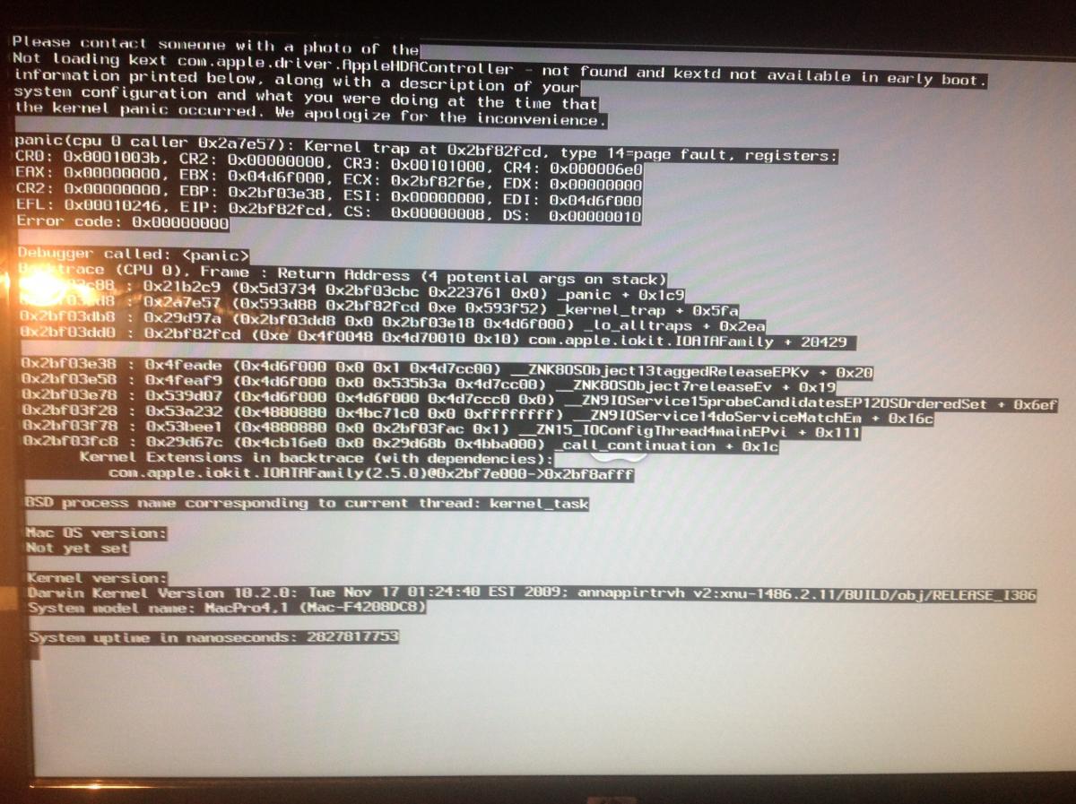

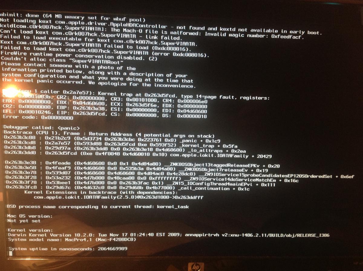

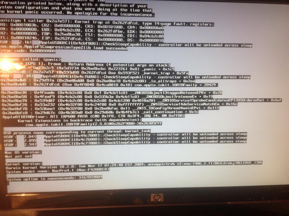

iFIRE Posted February 20, 2013 Share Posted February 20, 2013 the problem is with IOATAFamily.kext, you can delete this kexts in S/L/E and try boot with -f -x -v GraphicsEnabler=No Quote Link to comment https://www.insanelymac.com/forum/topic/286527-kernel-panic-at-apple-logo-hazard-1062/#findComment-1890671 Share on other sites More sharing options...
Naxx Posted February 20, 2013 Author Share Posted February 20, 2013 How can I access to S/L/E? Thanks a lot for helping! Quote Link to comment https://www.insanelymac.com/forum/topic/286527-kernel-panic-at-apple-logo-hazard-1062/#findComment-1890672 Share on other sites More sharing options...
iFIRE Posted February 20, 2013 Share Posted February 20, 2013 IF YOU HAVE WIN install MacDrive and go for s/l/e and delete the kext, or boot with -s mount / cd System/Library/Extensions rm -rf IOATAFamily.kext reboot -R now Quote Link to comment https://www.insanelymac.com/forum/topic/286527-kernel-panic-at-apple-logo-hazard-1062/#findComment-1890676 Share on other sites More sharing options...
Naxx Posted February 20, 2013 Author Share Posted February 20, 2013 If I try to boot with -f -x -v GraphicsEnabler=No I obtain this: Ok, i'll try to delete that kext! Ok, I stll get the same error even after I deleted IOATAFamily.kext's folder. Mhh, maybe I have to delete IOATAFamily.kext.orig too...? :/ Now I get this: Well, IOATAFamily error is gone now, but it still not boot... It doesn't give any error, but when the Apple logo comes out, a "stop" symbol appears... Quote Link to comment https://www.insanelymac.com/forum/topic/286527-kernel-panic-at-apple-logo-hazard-1062/#findComment-1890677 Share on other sites More sharing options...
