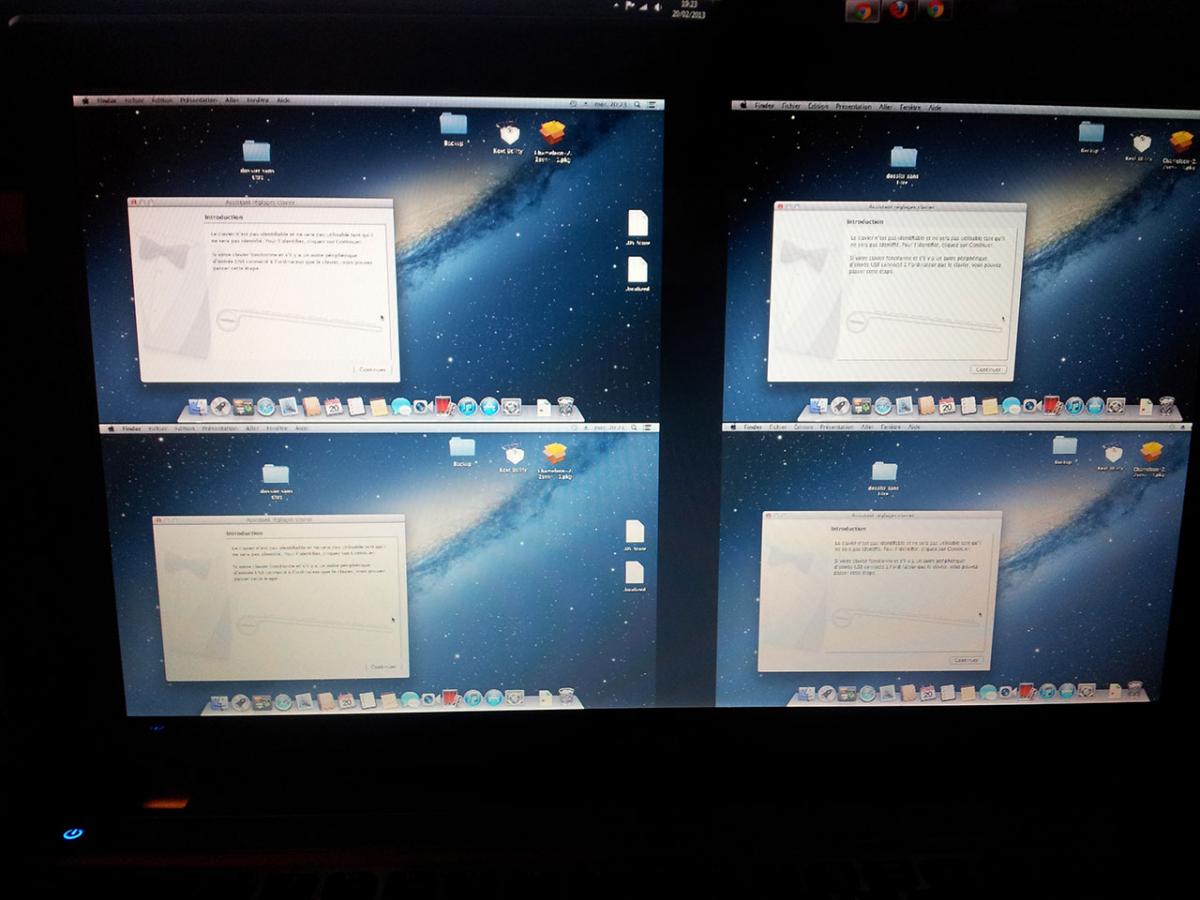

nomad83 Posted February 20, 2013 Author Share Posted February 20, 2013 Hi, I try your DSDT and HDA.kext right now. At boot I have this : Anyway, the sound doesn't work. I have some Sound assertion failed on boot. Thanks a lot for your help, in any case it's better than nothing. Regard. EDIT : ok, fixed that follow post #15 by Micky1979, thanks to you mate. Here's the trick : Replace : "AAPL,ig-platform-id", Buffer (0x04) { 0x04, 0x00, 0x66, 0x01 } with "AAPL,ig-platform-id", Buffer (0x04) { 0x03, 0x00, 0x66, 0x01 } Yes, just a little number. I've full acceleration, it's damn fast. Have to fix the Vram detection, it's 512 Mo actually. Stay tuned. Link to comment https://www.insanelymac.com/forum/topic/286507-acer-aspire-v3-571g-dsdtaml/#findComment-1890742 Share on other sites More sharing options...
WaldMeister Posted February 21, 2013 Share Posted February 21, 2013 I used the id that works for my system, it can differ, glad it works now Hmm, thought HD4000 does not have more than 512mb, anyway, don't know about a solution to that problem. About the sound, you can try VoodooHDA, be sure to remove the AppleHDA, else you will get a kernel panic at boot. Or patch your own AppleHDA, a guide on how to do this: http://www.projectosx.com/forum/index.php?showtopic=465 Link to comment https://www.insanelymac.com/forum/topic/286507-acer-aspire-v3-571g-dsdtaml/#findComment-1890873 Share on other sites More sharing options...
nomad83 Posted February 21, 2013 Author Share Posted February 21, 2013 Hey,thanks for support. I found a way for the wrong memory display, it's called "AAPL,ig-platform-id" Maybe you already know that ? There's differents values like 01660000, 01660001, 01660002, etc... Each for one spec. There's great informations about that on Google. It is bad to have 512mb, I have 8Gb of Ram I can easly handle it.. Plus you know what ? I just connect my HDMI Home Theatre to my laptpop and tada ! It's working very well, double desktop. It's just make a little strange noise from speackers, I don't care I don't plan to use HDMI. For the sound, I really want to make it working with DSDT, I think it's the cleanest way to achieve right ? I know VoodooHDA is working on my system but hey, it's too easy. Another important point it's the USB and Wifi. USB mouse working, the trackpad not. When I put a USB drive before start the laptop, the USB drive's on the desktop and I can use it, but if I insert a USB drive while the system running then the system freeze. Well, I'm good to go, another day in the world of MHackintosh. Link to comment https://www.insanelymac.com/forum/topic/286507-acer-aspire-v3-571g-dsdtaml/#findComment-1890879 Share on other sites More sharing options...
