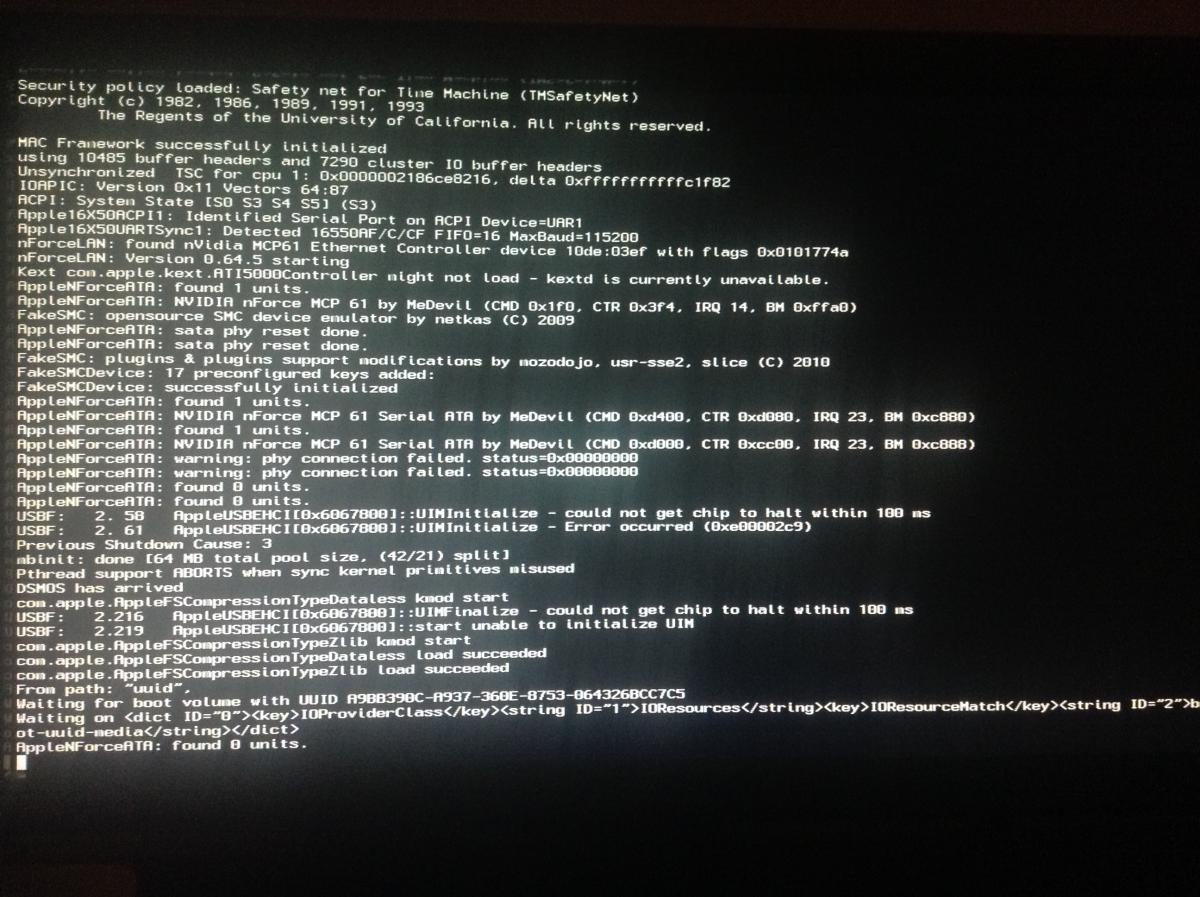

SheldonDDOS Posted January 21, 2013 Share Posted January 21, 2013 (edited) Greetings InsanelyMac Community! I'm trying to install Mountain Lion on to my computer. I had great sucess with Leopard / Snow Leopard with everything working except the GPU ( GTX 550 TI ) I heard that the GPU was to new for Leopard / Snow Leopard so i went for Mountain Lion. Those are my problems. When i try to boot up Mountain Lion ( I'm running a AMD Kernel from http://www.insanelym...testing-on-amd/ ) I get this message. And it's just stuck there. I am able to boot in to the system with -x. I got a Nforce Chipset. I hope you readers have a great day Best regards Fadel Edited January 21, 2013 by PookyMacMan Offering money will not get you help any faster. In fact, we do not tolerate it at all. Please do not do this again. Link to comment Share on other sites More sharing options...
fantomas Posted January 21, 2013 Share Posted January 21, 2013 Hi you can use the search feature, there are many topics!!! you can start with this thread I think you need imk's 64bit AppleNForceATA.kext (read this thread) Link to comment Share on other sites More sharing options...
Onixs Posted January 22, 2013 Share Posted January 22, 2013 Or use this flag idlehalt=0 Link to comment Share on other sites More sharing options...
Cr0wstuf Posted January 22, 2013 Share Posted January 22, 2013 I am having the same issues. I have been through every guide I can find here and none of them are resolving this issue. I have tried both lion and mountain lion guides, but I always get stuck at this point. I have put the applenforceata.kext 64 bit from imk in the s/l/e folder, booted up with almost every flag I have seen in this forum and still nothing. I was told by theconnactic to set my sata config to raid because my board doesnt support ahci. I did that, reformatted both my sata drives and still nothing. I am at a loss. Can anyone give some advice to this issue? <img class="UMSRatingIcon" id="ums_img_tooltip" /> Link to comment Share on other sites More sharing options...
Cr0wstuf Posted January 22, 2013 Share Posted January 22, 2013 Looking back on my last post, I can see that it is a bit scatterbrained without much info. I am... a bit frustrated. Heres my specs: Asrock n68c-s ucc nforce 630a chipset ati hd5450 512mb gfx 2 120gb sata2 drives heres a shot of what im getting: Link to comment Share on other sites More sharing options...
SheldonDDOS Posted January 22, 2013 Author Share Posted January 22, 2013 Or use this flag idlehalt=0 I will try it when i get home from work. Thank you so much, i'll get back to you if it helps. Hi you can use the search feature, there are many topics!!! you can start with this thread I think you need imk's 64bit AppleNForceATA.kext (read this thread) Greetings mate! I am using the AppleNForceATA.imk64bit.kext First time i was going to boot up my mac i got the waiting for root device. So i installed that kext. And now i got the Found 0 units error. I hope you will be able to help me out! Thanks Link to comment Share on other sites More sharing options...

verdant Posted January 22, 2013 Share Posted January 22, 2013 @ SheldonDDOS If only I were a "proper" developer, e.g. like Slice et al. ...... As regards OS X versions, the only issue is whether or not the MOBO Southbridge chipset "ATA" kext is 32bit only capable, or 32bit/64bit capable, or 64bit only capable since: OS X Leopard kernel is 32bit only capable OS X Snow Leopard kernel is 32bit/64bit capable OS X Lion is 64bit only capable OS X Mountain LIon is 64bit only capable As regards the original AppleNForceATA.kext and its later variants, it depends upon whether the Intel CPU MOBO or AMD CPU MOBO has a AHCI compliant nForce chipset or not..... If it is not fully AHCI compliant, then an AppleNForceATA.kext should work (subject to the OS X version constraints), whereas if it is fully AHCI compliant, then in most instances, the AppleNForceATA.kext will not work......see here for SATA and PATA Device IDs which work and do not work with the original MeDevil AppleNForceATA kexts..........hence, my Post #1 Note Bene 1, 2 and 3 here........ Finally, your BIOS settings need to be set up correctly for OS X, e.g. see my OS X BIOS settings templates for the nForce xxxi series of chipsets for Intel CPU MOBOs, which are linked to in my nForce topics on IM......they may be helpful for AMD CPU nForce chipset MOBO BIOS settings too...... Link to comment Share on other sites More sharing options...
Cr0wstuf Posted January 22, 2013 Share Posted January 22, 2013 @verdant I read in a few places that raid implies ahci. So if you set the configuration to raid on a non ahci compatible board.and install windows, get the raid controllers device I'd and enter it into the AHCIPortInjector.kext it should find the devices. Can you confirm this? I would try it myself, but I have already switched to raid, reformatted and lost my SL and windows partitions and tried to install lion and mountain lion twice... Thing is, I didn't know about the port injector at that point. I was just wondering if anyone could confirm that this may work before I wiped partitions for a third time. Thanks. Link to comment Share on other sites More sharing options...
verdant Posted January 22, 2013 Share Posted January 22, 2013 @ Cr0wstuf Yes, AHCI (Advanced Host Controller Interface) is a technical standard defined by Intel that specifies the operation of Serial ATA (SATA) host bus adapters. However, RAID (Redundant Array of Inexpensive Disks) is a much older technology that predates AHCI and SATA technology, but which nonetheless offers essentially the same feature set, i.e. functionality, that is available in AHCI making them identical in single hard drive applications. Which is why enabling RAID mode and the SATA controller in the BIOS of a non-Intel, i.e. non-AHCI MOBO, while disabling the individual SATA RAID channels in the BIOS, effectively enables the AHCI feature set as far as OS X and SATA devices are concerned. I hope this answers your question.........see my OS X BIOS settings template for nForce chipset MOBOs via the links in my nForce OS X Install Guide topics...... Link to comment Share on other sites More sharing options...
