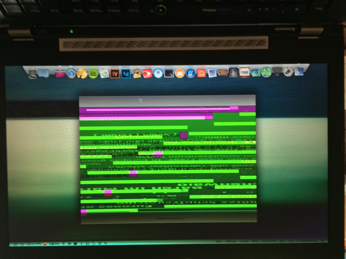

Ran into issues with my nvidia GPU. I am not able to have video running. This affects almost everything. I assume this to be related to QE/CI. Even when going to paypal.com on safari the whole thing crashes. e.g. have a look at the attached screenshot.
The picture is up site down, but i guess you get what I mean anyway...
Share this post
Link to post

@Cowboy Mike - i have zero experience with discrete/combo (nvidia/optimus) gfx.  but you could try disabling the nvidia in bios and run just HD 3000 to test things out. this may be due to way mac wants to handle the 2 gfx cards.
