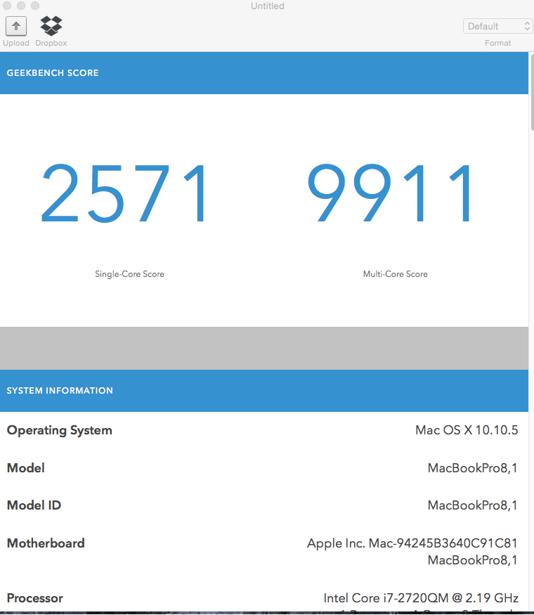

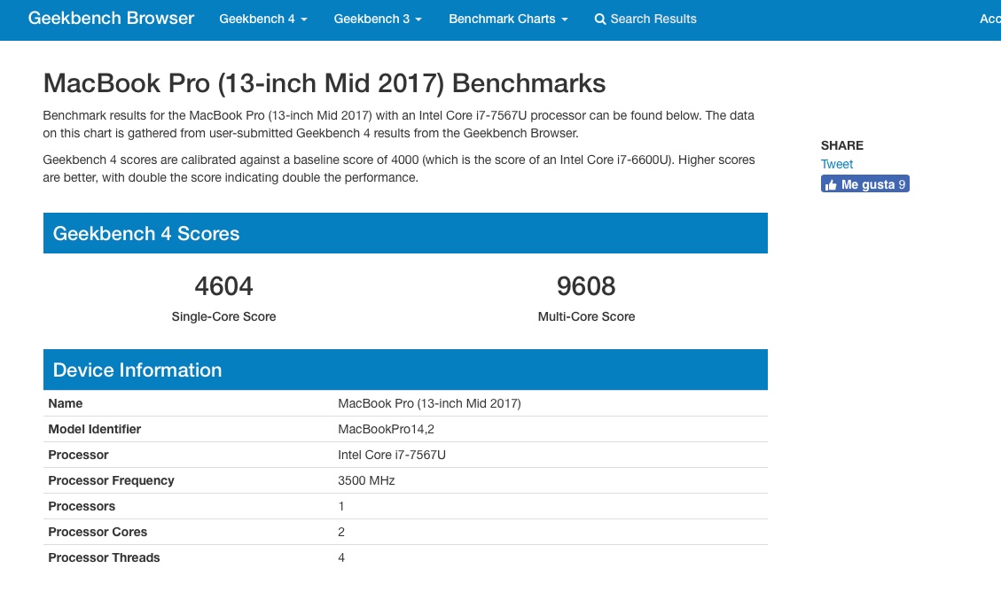

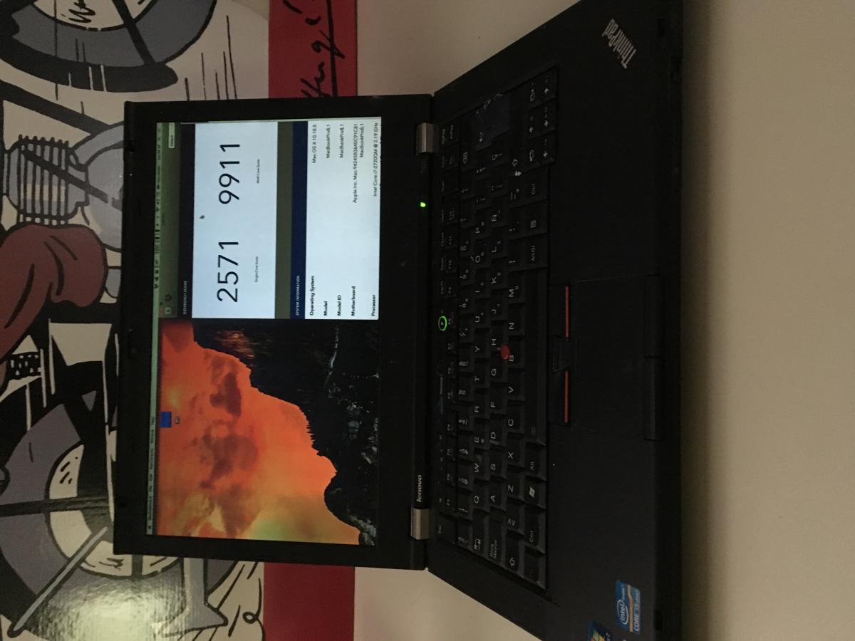

Not bad for an "old" Lenovo T420. More powerful than the actual Macbook Pro mid 2017, costing 2.105,59 €
mine got
Single-Core Score: 2585
Multi-Core Score: 5690
