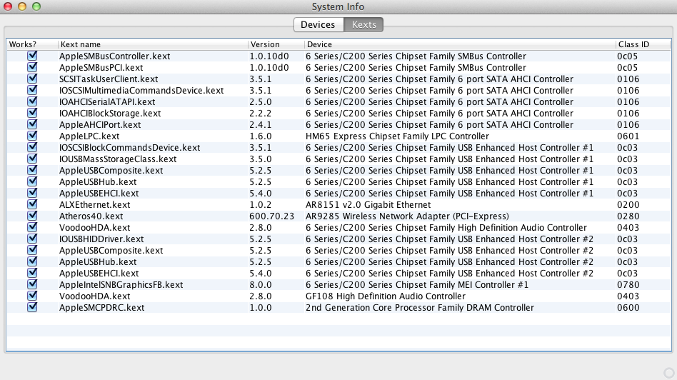

Torpedo Posted January 7, 2013 Share Posted January 7, 2013 Hi all,I installed Osx86 10.8.2 by iATKOS ML2 into my toshiba satellite l745 laptop.Everything is fine (sound (VoodooHDA 7.4.6), Wired, Wireless, VGA) .Except when I shutdown without unplug battery charger. It will not able to turn on.If only if I pull battery out. I will work again.So what should I do?Thank you Link to comment https://www.insanelymac.com/forum/topic/285507-shutdown-problem/ Share on other sites More sharing options...

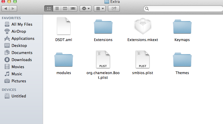

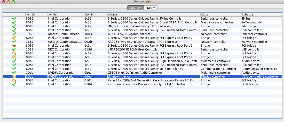

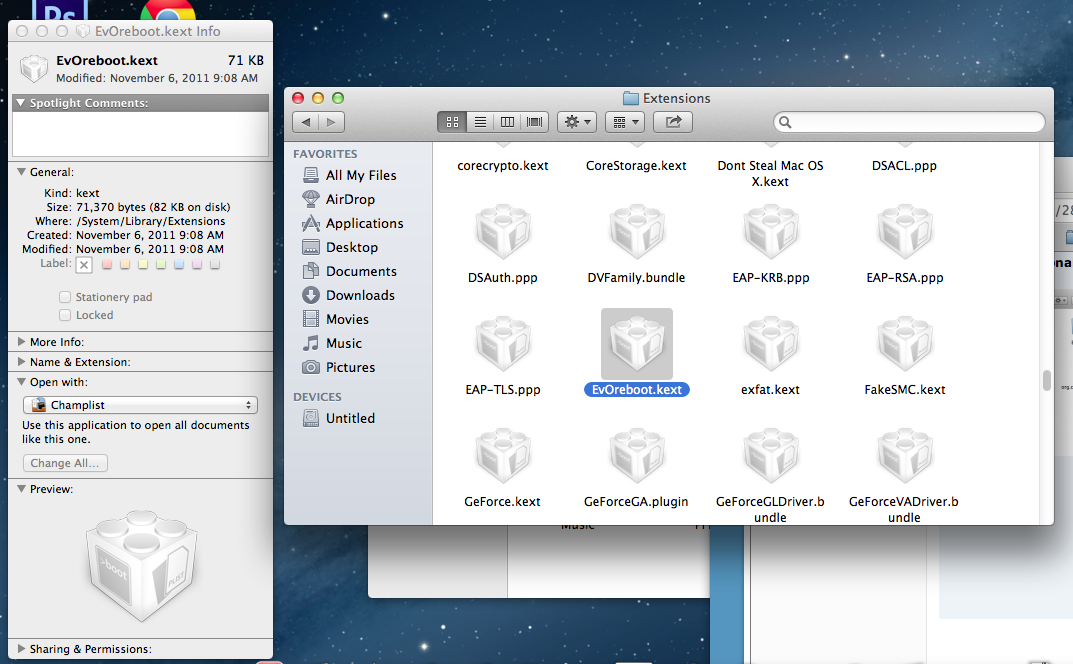

Torpedo Posted January 9, 2013 Author Share Posted January 9, 2013 It has been not working. FYI, my Extra folder is available and appear in mac os drive. There are a little files and folder there such as Keymaps, Themes, smbios.plist and so on. but there is no DSDT.aml. So I copy your DSDT.aml file to Extra folder. FYI, this my system information, extra folder, /s/l/e folder and EvOreboot.kext file. EvOreboot.kext.zip Link to comment https://www.insanelymac.com/forum/topic/285507-shutdown-problem/#findComment-1879178 Share on other sites More sharing options...

Torpedo Posted January 9, 2013 Author Share Posted January 9, 2013 FYI, I just realize that my laptop is not even shutdown after put your DSDT.aml in Extra folder. So I tried to remove DSDT.aml then I can shutdown properly again but It still remain a main problem which is a turn on problem. this is my Extra folder. http://www.sendspace.com/file/n8n8sa DarwinDumper_2.5.8_Chameleon_2.1_ML_tredsiam.zip Link to comment https://www.insanelymac.com/forum/topic/285507-shutdown-problem/#findComment-1879223 Share on other sites More sharing options...
buoo Posted January 9, 2013 Share Posted January 9, 2013 Remove AppleACPIPlatform1067.kext from the Extra/Extensions folder Replace org.chameleon.boot.plist and smbios (macbookpro8,1) rebuild the kernelcache with kextwizard and reboot org.chameleon.Boot.plist.zip smbios.plist.zip Link to comment https://www.insanelymac.com/forum/topic/285507-shutdown-problem/#findComment-1879228 Share on other sites More sharing options...
