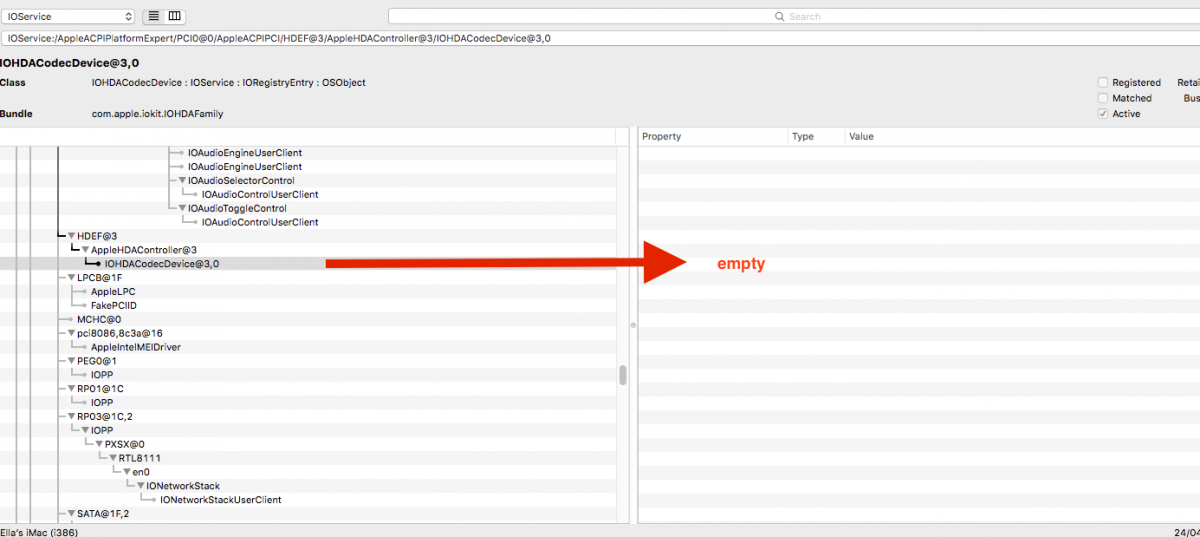

Found the bug... your PC or your OSX or your AppleHDA.kext!
if you look in your ioreg under HDEF->AppleHDAController->IOHDACodecDevice is totally empty, so nothing can be done by getcodecid.
Reason: unknown, btw is possible that your controller is not supported by AppleHDA.. although the driver should have also published the ids anyway.
No way to make it work with AppleHDA, sorry

Hi Mickey1979
As i have said, i am using Mirone's AppleHDA since Yosemite (probably even Mavericks) on this board with no issue. It just so happened that i came across this thread and gave getcodecid a try, only to find out it gives segmentation fault. At first, i didnt bother as long Mirone's patch works.
My setting in bios has always been the same... for a test, i tried the follwing:
1. used optimal setting then compared the ioreg to my custom settings in bios.
2. booted with and w/o DSDT
Both resulted to an EMPTY string just like the pic you attached.
I dont know if that EMPTY should result to a non-working sound. but my sound just works :D
its still empty after the dsdt fix though
pic.tiff
How to post a pic instead of attachment?
Edited by ellaosx
Share this post
Link to post
Glad that work now, but in the pict at  #103 only show one device HDEF, instead in the new pict you show us in the #108 you have two :ph34r:....
BTW you have solved, what matter :)

oh yes, i now have two :o
Maybe that became 2 after the dsdt patch which i didnt notice.
was this a HW conflict? Maybe yes :D
Mickey1979, again, Thank You! Sir :)
HDEF@3=HDAEnabler.kext/HDMI
HDEF@1B=DSDT injection/Onboard
I would have saved a good time
if I had looked at this topic before,but I can be wrong.

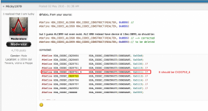

@Fabio, from your source:
#define HDA_CODEC_ALC898 HDA_CODEC_CONSTRUCT(REALTEK, 0x0898) //
#define HDA_CODEC_ALC899 HDA_CODEC_CONSTRUCT(REALTEK, 0x0899)
but I guess ALC899 not even exist. ALC 898 instead have device id 10ec:0899, so should be:
#define HDA_CODEC_ALC898 HDA_CODEC_CONSTRUCT(REALTEK, 0x0899// --> corrected
#define HDA_CODEC_ALC899 HDA_CODEC_CONSTRUCT(REALTEK, 0x0899// to be deleted
corrected:
corrected:
