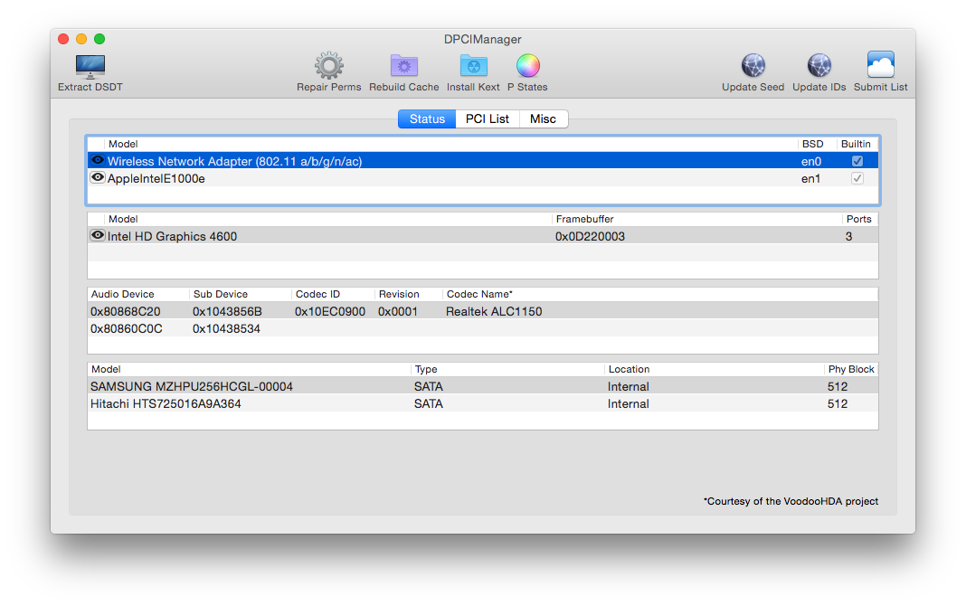

z871-deluxe/alc1150/10.10/Clover 2953
ssdt-1/HDEF/layout-id/0x02, 0x00, 0x00, 0x00
DPCManager/Codec ID/10EC0900
debug.log/5:123 0:003 HDA Controller [8086:8C20] :: PciRoot(0x0)\Pci(0x1B,0x0) => codec not detected
Clover is not detecting the 1150, suggestions?
me too toleda me too have this PciRoot(0x0)\Pci(0x1B,0x0) => codec not detected
and have alc 1150

There may be different reasons:
	if ((data32 & 0x1) == 0) {
		// this controller is not inited yet - we can not read codec ids
		// if needed, we can init it by:
		// - set Control reset bit in Global Control reg 08h[0] to 1
		// - poll it to become 1 again
		// - wait at least 521 micro sec for codecs to init
		// - we can check STATESTS reg 0eh where each running codec will set one bit
		//   codec addr 0 bit 0, codec addr 1 bit 1 ...
		return 0;
  //Slice - TODO check codecAdr=2 - it is my Dell 1525.
	// all ok - read Ids
	return HDA_IC_sendVerb(PciIo, 0/*codecAdr*/, 0/*nodeId*/, 0xF0000/*verb*/);
We already expected that the algo will not always work. For this case you have to set the value manually.
The same about BUS speed.
