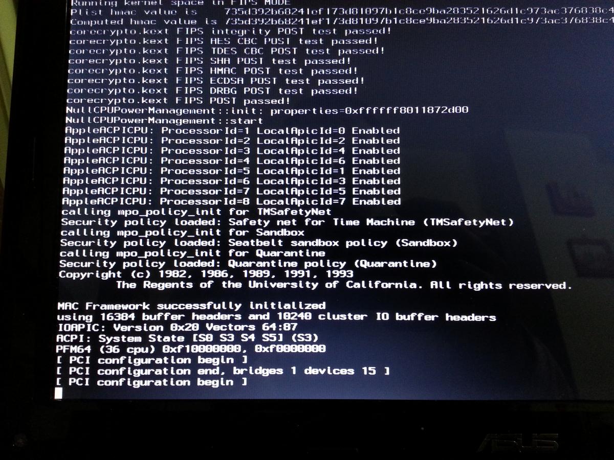

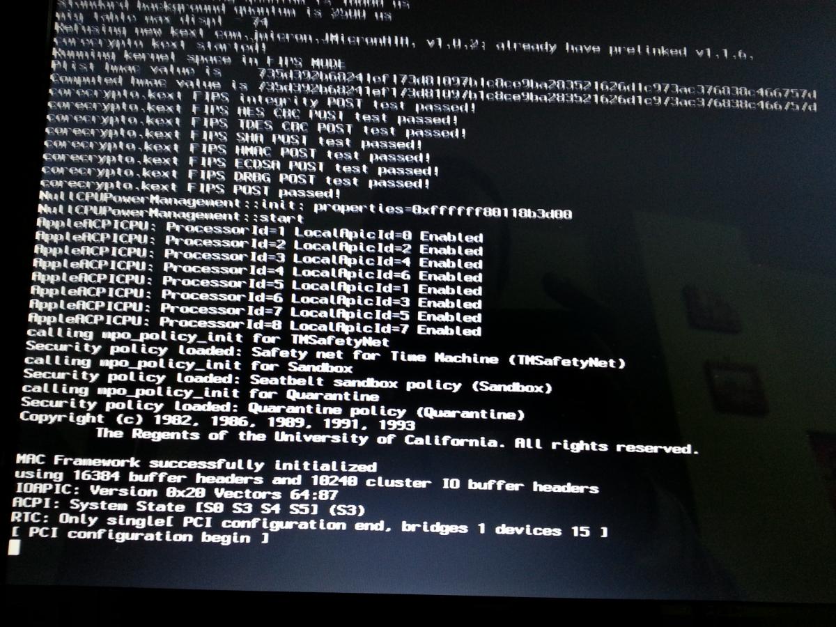

cannosdj Posted November 23, 2012 Share Posted November 23, 2012 ragazzi ho dei problemi nell'installazione di mountain lion, all'avvio si blocca mostrando questa schermata 1 mentre inserendo la stringa busratio=12 ho quest'altra schermata 2 il pc è un asus g51jx con questa configurazione Intel Core i7 720QM Intel HM55 NVIDIA GeForce GTS 360M 1 GB DDR3 8 GB DDR3 PC38500 533 mHz cosa mi propronete di fare? Link to comment https://www.insanelymac.com/forum/topic/284542-blocco-installazione-asus-g51jx-con-foto-schermate/ Share on other sites More sharing options...

iFIRE Posted November 25, 2012 Share Posted November 25, 2012 http://netkas.org/?p=1053 These of you who are stuck at [PCI Configuration begin/end] and npci=0×3000 doesnt help, you had to use 10.6.7 IOPCIFamily and AppleACPIPlatform and can’t try Mountain Dew Lion. Well, no more. NETKAS ported IOPCIFamily-115 kext to work with new AppleACPIPlatform. So, you can use it and no need to replace AppleACPIPlatform with old one, a bit better then having to replace both. Here is a link to a kext and sources - http://rghost.ru/36725147 Also, here is version for Mountain Lion, which allowed my lappy to boot 10.8 - http://rghost.ru/36725213 (both versions include fixes for ethernet and wifi on laptops lacking iomap addresses) Link to comment https://www.insanelymac.com/forum/topic/284542-blocco-installazione-asus-g51jx-con-foto-schermate/#findComment-1868810 Share on other sites More sharing options...
