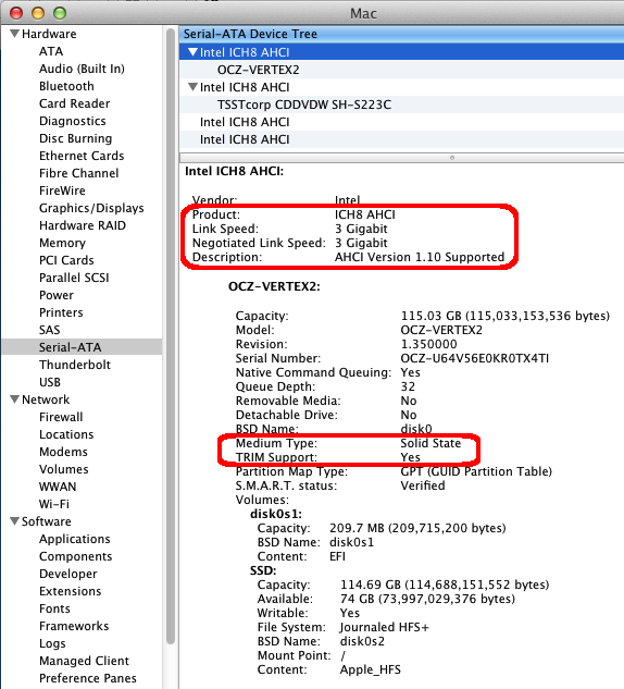

tepaks Posted October 11, 2012 Author Share Posted October 11, 2012 After countless hours of reading flaming Lion comments and clearing all ASL log error messages, average boot time was still 1:50 ( cold boot ). And than, jus like Sherlock Holmes said, "When you have eliminated the impossible, whatever remains, however improbable, must be the truth". Well only thing remaining was the hardware itself My second iHack running 10.6.8 mislead me all the time ( booting within < 60 sec with same MB & BIOS) So to cut the long story short, BIOS was the culprit, to be more specific the AHCI option. Soon enough i've found a good working modified BIOS and voila! This old fart boots within < 40 sec ( cold boot, kernel cache rebuild & enabled ) n.b. if everything went OK you shod see something like this in your system report: ( Steve Jobs R.I.P & Bill Gates go f**** Y'r self, pardon my french, i mean Eat My Dust! ) Link to comment https://www.insanelymac.com/forum/topic/283389-solved-strange-boot-delay/#findComment-1859866 Share on other sites More sharing options...
