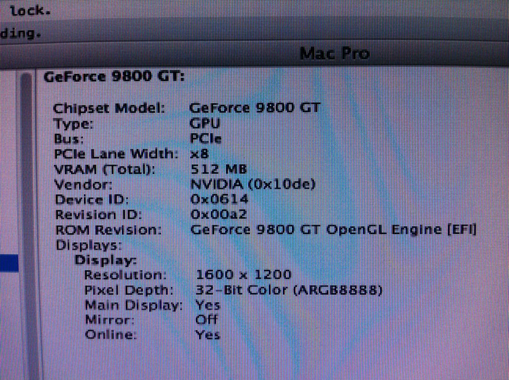

djfremen Posted October 1, 2012 Share Posted October 1, 2012 I've done a ton of leg work but still am coming up empty every time. From another forum a user with my same setup reported enable the 9800's full graphics potential. He can now change resolutions, view duel screens and has QE. Here's my setup: GA-EP45T-DS3R w/ F4c beta BIOS Sparkle 9800 GT, 512 DDR3 Quad Xeon processor @ 2.83 Post installation (used Tseug scripted method) I add EFI strings via OSX86 tools to org.chameleon.plist and also enable GE/yes. Then I replace (per success story) NVDANV50Hal.kext with a DP4 I downloaded. When I reboot it says the following in system profiler and has no video resolutions outside my default in org.chameleon.plist. (See screenshot) I have three HD's with various versions of working installs in this box (10.5.7, 10.6.8) but I keep hitting the wall here on ML with this video resolution issue. What makes matters worse, I use this system remotely (screen share) and the graphics issue causes the entire computer to choke. Really frustrating. Lastly, I've read about people adding device Ids to their Nvidia kext files but when I check console, it says it "removed personalities from kernel" and sure enough when I view "show contents" on the specific kext, it deleted the info.plist file! Why is this happening on a fresh install? Currently have two identically 10.8.2 installs (one of which I'm mucking up and then replace kext files again) Anyone have any thoughts please? Ugh! Double post. Sorry!! Hate this app. Link to comment https://www.insanelymac.com/forum/topic/283267-9800-gt-woes-nvenabler-efi-string-gey-and-disappearing-plists/ Share on other sites More sharing options...

mitch_de Posted October 2, 2012 Share Posted October 2, 2012 Dont use both : dsdt / EFI gpu injection together with chameleon graphicsenabler=yes. USe only one of them, because both try the same "thing" and you get bad results. 9800GT is 8800GT chipset which is very compatible / easy OS X handling and doent need any patch nor (in mots cases) dev iD addings in the .kext. First tell use which dev-id your gpu has (for checking chamleon graphicsenabler support). 0x605 is normaly dev-id for 9800GT and is supported by chameleon. (2030+) Link to comment https://www.insanelymac.com/forum/topic/283267-9800-gt-woes-nvenabler-efi-string-gey-and-disappearing-plists/#findComment-1857507 Share on other sites More sharing options...

djfremen Posted October 5, 2012 Author Share Posted October 5, 2012 New install worked! Now full Q/E with GraphicsEnabler=No in ML 10.8.2! Interestingly though, max resolution on both displays is 1600x1200. Thought the 9800 for sure would spit out 1920x1200. It's never good enough is it Link to comment https://www.insanelymac.com/forum/topic/283267-9800-gt-woes-nvenabler-efi-string-gey-and-disappearing-plists/#findComment-1858270 Share on other sites More sharing options...
