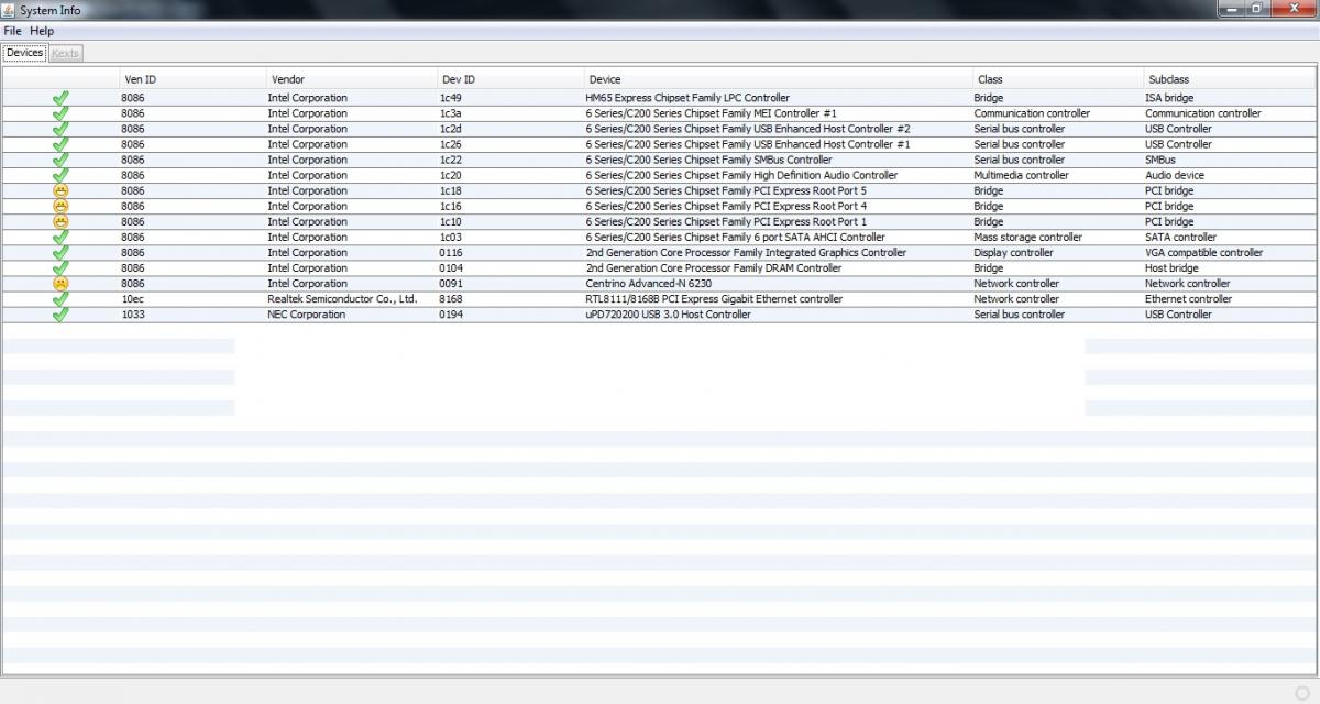

ok, is correct, but you are boot from USB 3.0!!!!! change for a Port USB 2.0 or this not work, your device id for your controller Sata is ok in AppleAHCI.kext see here: 8086 1c03 , your bios is set for AHCI !!!!!!!!!
