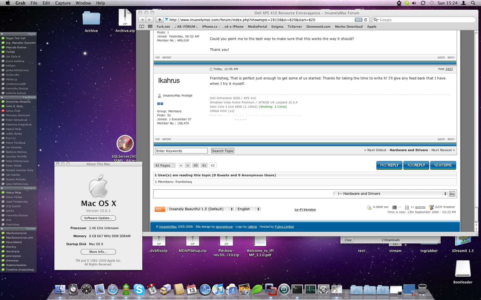

Rob G Posted September 13, 2009 Share Posted September 13, 2009 frantisheq thanks for posting that little guide. Im still having problems i did every thing u posted but im still getting waiting on root device. Can u post your Appleahciport kext please. Link to comment https://www.insanelymac.com/forum/topic/28138-dell-xps-410-resource-extravaganza/page/34/#findComment-1264673 Share on other sites More sharing options...

Rob G Posted September 15, 2009 Share Posted September 15, 2009 Now I get to the installer but I get an endless pin wheel at the disk selection screen Link to comment https://www.insanelymac.com/forum/topic/28138-dell-xps-410-resource-extravaganza/page/34/#findComment-1266678 Share on other sites More sharing options...
frantisheq Posted September 15, 2009 Share Posted September 15, 2009 disable DVD and secondary HDD in BIOS. in AHCI mode second HDD or DVD is working only if your Mac OS HDD is doing something like moving files for example. if the first HDD stops Mac OS is unable to work with second HDD and you'll most likely get the pin wheel. that's why will need to use IDE mode with driver from DuNe. Or some patched AHCI driver but i haven't seen any. until then no timemachine on second hdd, no DVD/CD Link to comment https://www.insanelymac.com/forum/topic/28138-dell-xps-410-resource-extravaganza/page/34/#findComment-1266741 Share on other sites More sharing options...
