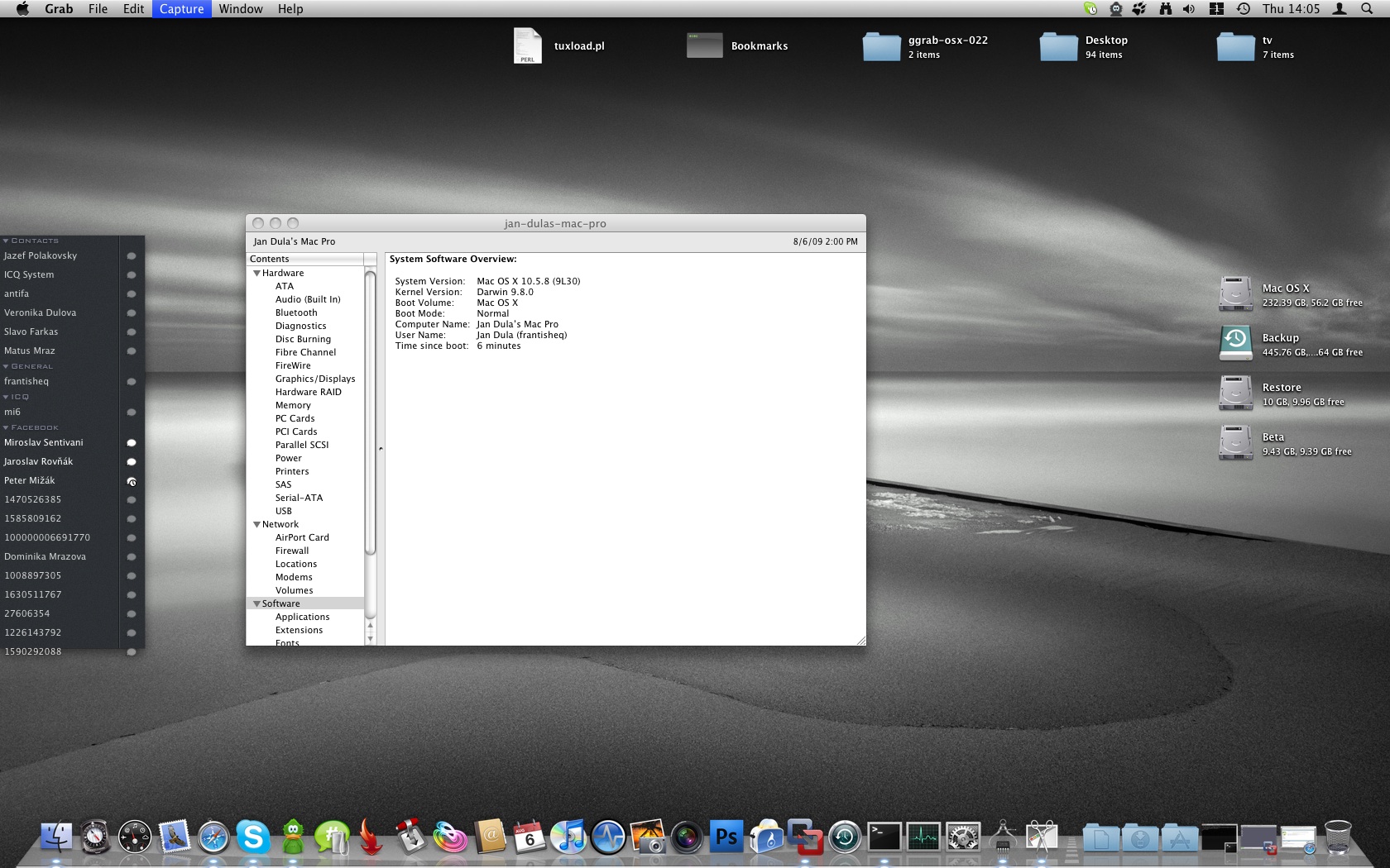

frantisheq Posted August 6, 2009 Share Posted August 6, 2009 just updated to 10.5.8 without any preparations like updating dsmos.kext and it all went perfect with chameleon2 RC1 on EFI Link to comment https://www.insanelymac.com/forum/topic/28138-dell-xps-410-resource-extravaganza/page/32/#findComment-1218269 Share on other sites More sharing options...

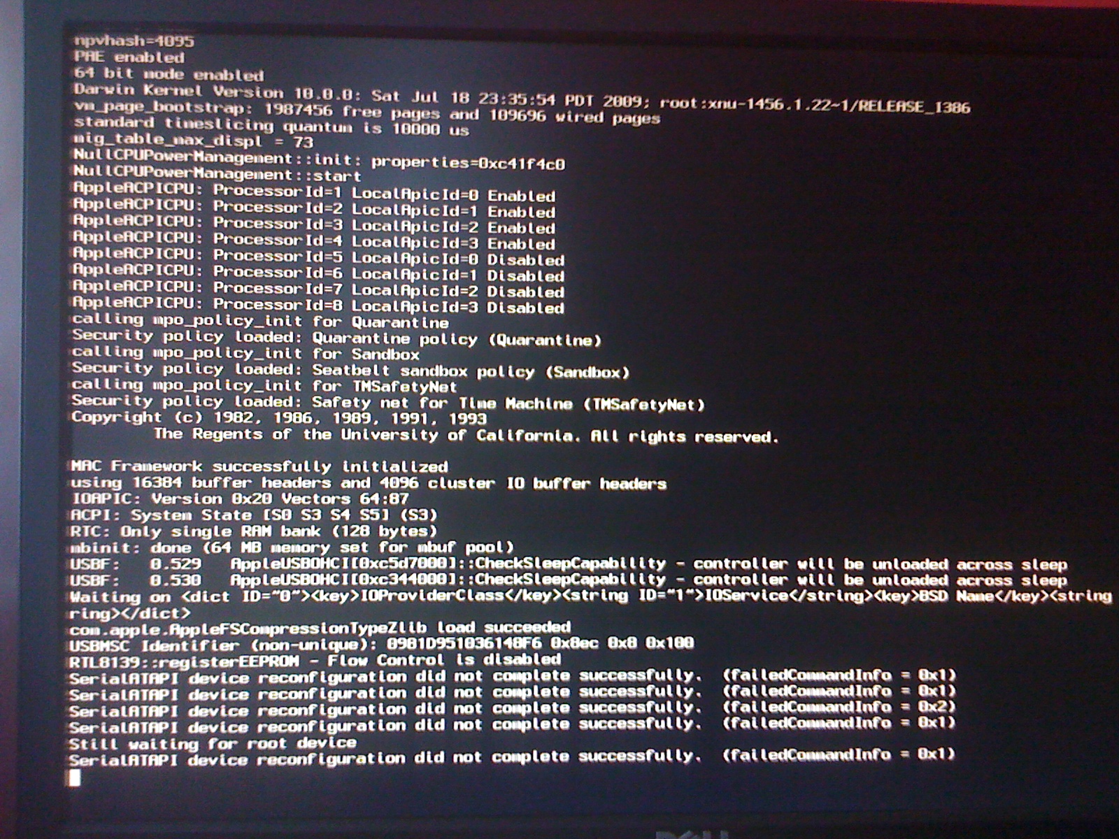

frantisheq Posted August 10, 2009 Share Posted August 10, 2009 10a380 was giving me Still waiting for root device error so i have downloaded 10a421 DVD and it's the same. 64bit mode gives me kernel panic and 32bit mode is waiting for root device. i have tried everything - patched kexts for leopard, added dev id's to snow leo kexts, kexts that are installed with Chameleon2 but it was always the same Link to comment https://www.insanelymac.com/forum/topic/28138-dell-xps-410-resource-extravaganza/page/32/#findComment-1221738 Share on other sites More sharing options...
frantisheq Posted August 10, 2009 Share Posted August 10, 2009 tried to boot 10a421 in AHCI mode after i have added dev id's to appleahciport.kext EDIT: good news! i was able to boot once in AHCI in 64bit. all i had was grey screen and moving mouse cursor but better than nothing. i can't make it boot again though EDIT2: i was able to boot once again in AHCI with: SMBIOSdefaults=No -x64 -x -v EDIT3: and another boot in IDE mode just with -v. booted fine in 64bit but again just gray screen and mouse cursor Link to comment https://www.insanelymac.com/forum/topic/28138-dell-xps-410-resource-extravaganza/page/32/#findComment-1222082 Share on other sites More sharing options...
Rob G Posted August 13, 2009 Share Posted August 13, 2009 tried to boot 10a421 in AHCI mode after i have added dev id's to appleahciport.kext EDIT: good news! i was able to boot once in AHCI in 64bit. all i had was grey screen and moving mouse cursor but better than nothing. i can't make it boot again though EDIT2: i was able to boot once again in AHCI with: SMBIOSdefaults=No -x64 -x -v EDIT3: and another boot in IDE mode just with -v. booted fine in 64bit but again just gray screen and mouse cursor What mods Are u making to the 10.6 DVD to boot it? Link to comment https://www.insanelymac.com/forum/topic/28138-dell-xps-410-resource-extravaganza/page/32/#findComment-1224529 Share on other sites More sharing options...
frantisheq Posted August 13, 2009 Share Posted August 13, 2009 chameleon2RC1 with latest boot from netkas dsdt with stellarola's CMOS reset fix AppleIntelPIIXATA.kext from netkas - i have added dev id 2820 because it wasn't there for AHCI just add 2821 to appleahciport.kext dsmos from netkas snow leopard 10a421 DVD restored to GUID partition 64bit NullCPUPowerManagement boot uuid in com.apple.boot.plist it boots randomly (10-20 resets and just one boot) and no installer Link to comment https://www.insanelymac.com/forum/topic/28138-dell-xps-410-resource-extravaganza/page/32/#findComment-1224724 Share on other sites More sharing options...
