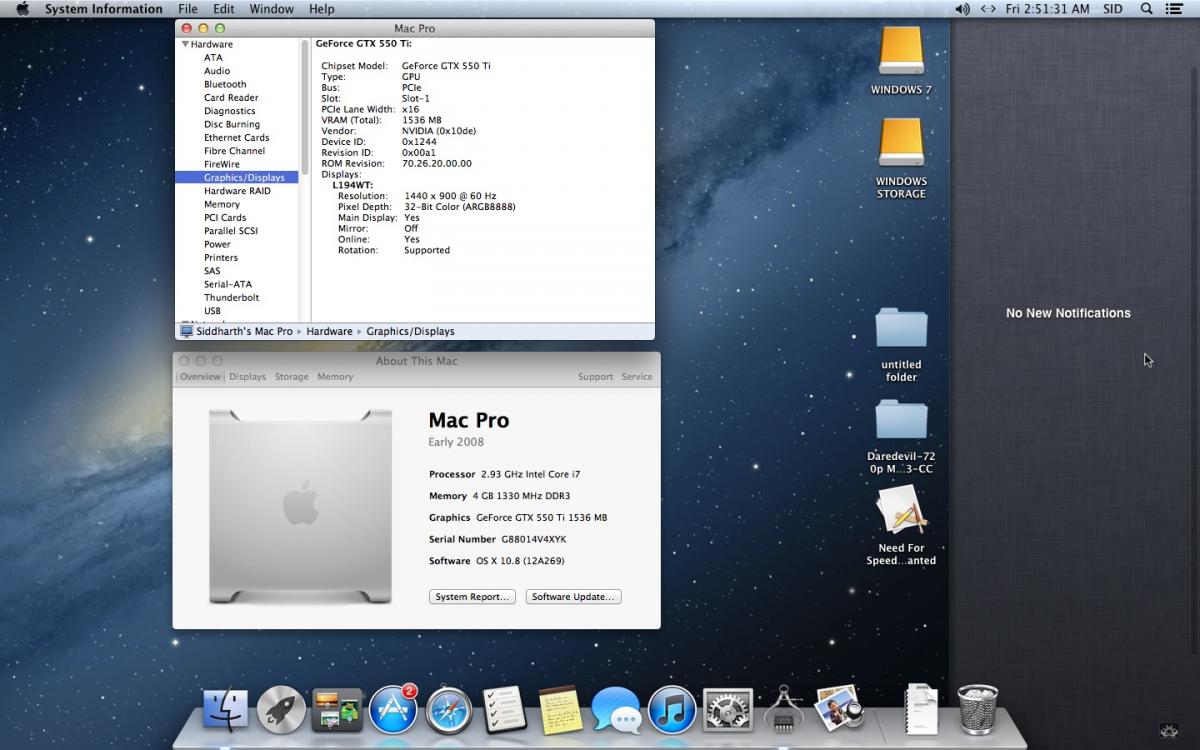

I am on full QE and CI on the retail Mountain Lion with asus gtx 550 ti...
When making the installer itself, I added the string in NVDAGF100Hal.kext and placed my smbios.plist from hardware acclerated OS X Lion in the extra folder on the disc. While in installation itself, I got full resolution....

Got QE on 550Ti....
how did u do this please i have the galaxy gtx 550 ti but no QE what installation method did u use
please PM if anything
Share this post
Link to post
Same method that I used to make the OS X Lion Installer....
Just One update I would like to add is, The Stock Mountain Lion doesn't have Geforce.kext present in Lion. Can everyone please try pasting this geforce.kext in extensions of your installed mountain lion, add the graphic card string in NVDAGF100HAL.kext, repair permissions, for safely, use netkas fakesmc (Found it completely working)....
ML has no PS2 support I suppose, So add appropriate kexts..(They differ from machine to machine.)...
Now cross your fingers and reboot. Please post your replies on my post. Hope this works for all of you.....

Guyz please post your results..!!
Only Neo got it working or everyone out here has...??????
Mine works 100%....
No blue screen when resolution is changed.....
