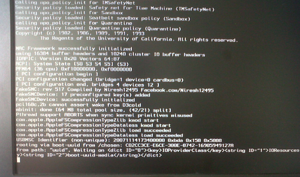

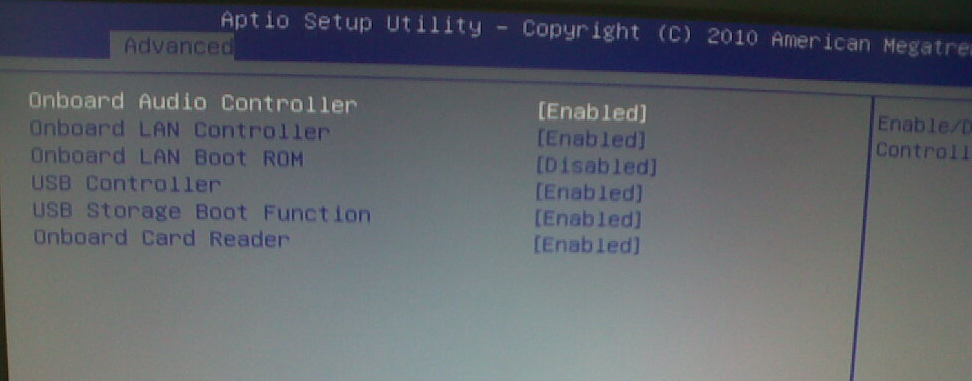

antares_mx Posted July 5, 2012 Share Posted July 5, 2012 Help to install MacOS X 10.7.3 on DELL Inspiron Lion 620s How about you all, I have the following problem, installing Mac OS X 10.7.3 Lion by Niresh12495, to boot the installation DVD hangs and only appears at the end of the legend “Still Waitin Root device” I tried several options to start, -v, -x –v, etc., without getting start the installation, there's one on the motherboard of the PC, the BIOS does not have the option to change channel SATA hard drive - IDE – AHCI. Then I show tola information from the PC: DELL Inspiron 620s Main Board: DELL Model 0GDG8Y Chipset Intel Southbridge Intel H61 Equipo: ACPI x64 Processor: Intel Core i3 2130 3.30 Ghz. Socket 1155 LGA Sandy Gridge Memory: Kingston PC3 DDR3 1333 4Gb. Hard Drive: Seagate ST500DM002-1BD142 ATA Device 500 Gb. 7200 rpm Video: Intel HD Graphics 2000 (GT1) Audio: Intel High Definition Audio (Conextan HD Audio) Network: Realtek PCIe GBE (RTL8111/8168B) Gigabit Wireless Network: Atheros AR9285 802.11 b/g/n I hope I can help with any alternatives Leon to install on my PC. Note: I leave my computer images. and Thanks for your help Link to comment Share on other sites More sharing options...
PippoX0 Posted September 5, 2012 Share Posted September 5, 2012 You need to Flash a patched Bios and To flash Bios you need Windows ... I have patched A04 Bios for DELL Inspiron 620S and i got AHCI option enabled ... I Have installed OSX Lion on my HDD and it works fine ... Original A04 Bios http://dell.to/HTcVvX Patched AHCI one http://www.sendspace.com/file/je91vr Best Regards PippoX0 ------------------ HINT If someone don't want flash Bios and want use IDE standard here IDE Kext for Lion ApplePCIIDE.kext for OSX Lion .zip Link to comment Share on other sites More sharing options...
Thunderbolt Posted September 5, 2012 Share Posted September 5, 2012 I have the same "still waiting for root device" so for temporary time I am using "UseKernelCache=No" Link to comment Share on other sites More sharing options...
