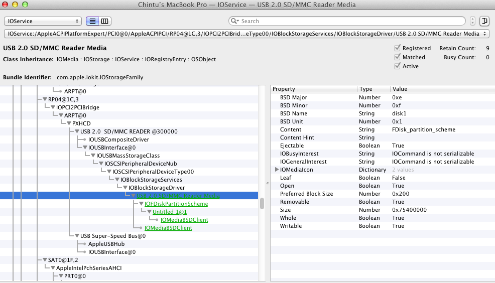

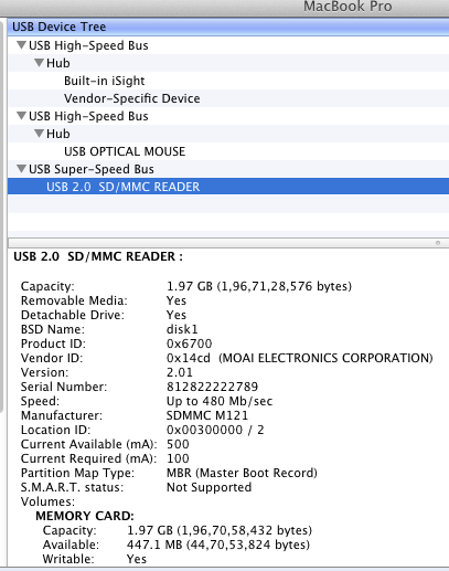

chinmaya__swarup Posted May 12, 2012 Share Posted May 12, 2012 My problem continues from the following topic. http://www.insanelym...pic=274591&st=0 The problem is that my USB3 ports only work after WAKE from sleep. It is renesas usb3.0 with latest firmware. PXHCD.kext is loading successfully. if i plug anything to my USB3 port the system freezes and i have to restart the system. my USB3 ports works only after the system is put to sleep and then WAKE from sleep. Then it continues to work OK. Its not a driver problem or IRQ problem. i have attached my DSDT and screenshots. please help me solving this problem. DSDT.aml.zip Link to comment Share on other sites More sharing options...

chinmaya__swarup Posted May 19, 2012 Author Share Posted May 19, 2012 I need the files i have ask you the on the post above yours... here are the files. Unfortunately, it seemed to me too, but unfortunately I can not even find errors in Console, and I can not give explanations If I leave only two IRQ under HPET, USB2 stop working I enclose also dsdt.aml vanilla, and patched by me, if you want to take a look ... I'd bevery happy every suggestion is precious, thanks Micky Hi Micky, Welcome. Are you sure you are having USB2.0 port problem and not USB3.0? Cause mine is USB3.0 port problem which i understood very late, after seeing mounting of USB device in PXHCD under RP04 (which is USB3.0) can you post your ioreg screen-shot after mounting of USB device as i have attached mine in here at starting...!!! ioreg.zip Link to comment Share on other sites More sharing options...
