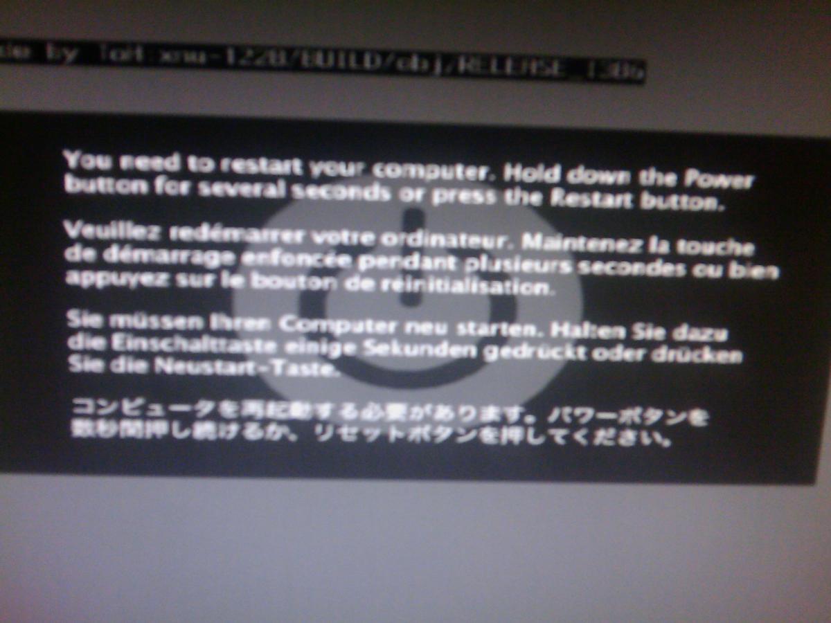

GileX Posted April 24, 2012 Author Share Posted April 24, 2012 Huh, this is what happen now: From Leopard opened Software Update, it found update to 10.5.8, I've started installation and after few minutes at about 20% it shown me message "You need to restart your computer...", of course I restarted it and on boot it got 'kernel panic' and shown same that message over the Apple logo as you can see on the photo below. What now? Link to comment https://www.insanelymac.com/forum/topic/278422-mouse-cursor-glitch-at-x1300/#findComment-1815772 Share on other sites More sharing options...
rlf Posted April 24, 2012 Share Posted April 24, 2012 Well, you can't use the Software Update for one thing, at least not to update old system software.It has been a while since I've had to do it, but you would reinstall Kalway 10.5.2. You would then copy the mach_kernel and the System.kext to your Desktop. You would download the 10.5.8 Combo update from Apple. You would install the combo update, but would NOT allow it to reboot. You would then reinstall the saved mach_kernel and System.kext, repairing permissions on them. Then you would reboot the computer holding your breath and crossing your fingers. Link to comment https://www.insanelymac.com/forum/topic/278422-mouse-cursor-glitch-at-x1300/#findComment-1815775 Share on other sites More sharing options...
GileX Posted April 24, 2012 Author Share Posted April 24, 2012 Again, same thing while installing update from Apple's website as I thought it will happen. Using terminal I've made backup of files you told me to backup, but when started installation soon it gave me same error. At boot first line said 'unsupported cpu..' so yeah, seem like kernel is overwritten already and I wasn't able to copy my backup back to root of partition. Gonna download iDeneb now and try with it, wish me luck Link to comment https://www.insanelymac.com/forum/topic/278422-mouse-cursor-glitch-at-x1300/#findComment-1815888 Share on other sites More sharing options...
