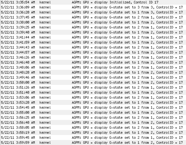

mitch_de Posted April 11, 2012 Share Posted April 11, 2012 OK. First test if AGPM is really loaded by kextstat (terminal command) You should see such an listing: ffffff7f81e95000 0xb000 0xb000 com.apple.driver.AGPM...... in the kextstat list. About your DEV-ID (in AGPM .plist) Is that really 1244(hex) ? If not, and your used 1244 is decimal then use HEX 04DC (Vendor10deDevice04DC ) I atttached screen which shows how AGPM log locks like in the console (select show all messages). Link to comment https://www.insanelymac.com/forum/topic/277984-solved-help-needed-evga-geforce-gtx-550-ti-choppy-animations/#findComment-1812786 Share on other sites More sharing options...
Hameer Abbasi Posted April 11, 2012 Author Share Posted April 11, 2012 First, I'm sure it is 1244 hex, confirmed by IORegistryExplorer. Kext Wizard shows that AGPM is loaded. Okay, apparently it was GFX0 instead of Vendor10deDevice1244 in AGPM.kext. Saving, and rebooting, and using your method, I see that AGPM was switching states even at the last boot, and it is at this boot (see attachment). But it doesn't go below G-state 0 once it has reached it, as you might see. So, two possibilities spring to mind: Something is using the GPU in the background for no reason (Activity Monitor shows hardly any activity, so this can't be the case). That G-state 0 doesn't exist for my GPU. I will edit the kext accordingly and report back. Update: The console seems to give the same three messages, even if I disable G-state 0, and immediately upon boot: 4/11/12 4:14:44.000 PM kernel: AGPM: GPU = GFX0 Initialized, Control ID 17 4/11/12 4:14:56.000 PM kernel: AGPM: GPU = GFX0 G-state set to 3 from 3, ControlID = 17 4/11/12 4:14:56.000 PM kernel: AGPM: GPU = GFX0 G-state set to 1 from 3, ControlID = 17 4/11/12 4:15:00.000 PM kernel: AGPM: GPU = GFX0 G-state set to 0 from 1, ControlID = 17 That can't be right. My SMBios is definitely iMac 12,1, confirmed by Chameleon Wizard, and I've disabled G-state 0 in AGPM: <key>Threshold_High</key> <array> <integer>0</integer> <integer>45</integer> <integer>75</integer> <integer>100</integer> </array> <key>Threshold_Low</key> <array> <integer>0</integer> <integer>0</integer> <integer>87</integer> <integer>98</integer> </array> Update 2: It's definitely a problem with GPU speedstepping. It changes to G-state 0 at the exact moment that the animations go choppy, according to something noticed at a reboot. Update 3: Okay, GPU Speedstepping now works. I was missing the this stuff in AGPM: <key>SensorOption</key> <integer>1</integer> <key>SensorSampleRate</key> <integer>4</integer> But the animations still aren't smooth, even if I fix everything to G-state 1. Console.tiff Link to comment https://www.insanelymac.com/forum/topic/277984-solved-help-needed-evga-geforce-gtx-550-ti-choppy-animations/#findComment-1812838 Share on other sites More sharing options...
