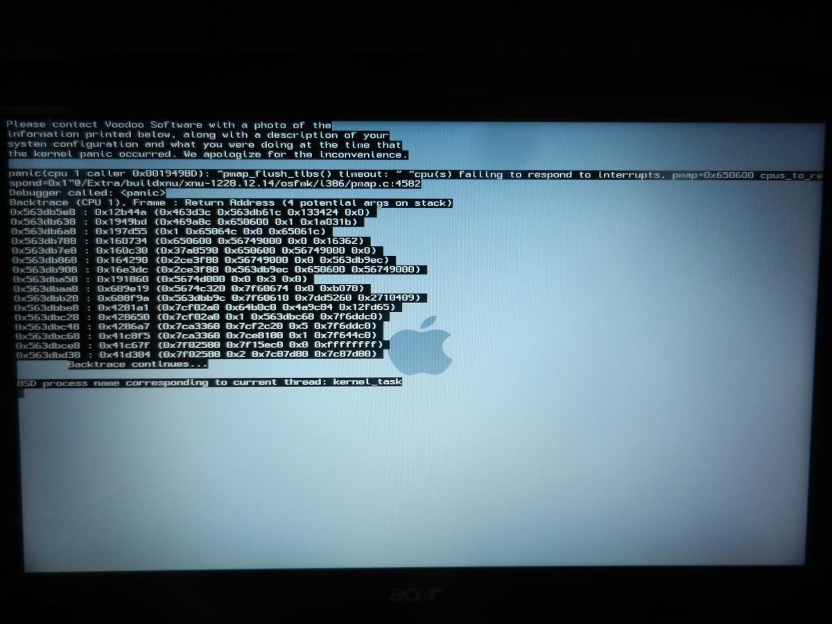

ablin1 Posted April 2, 2012 Share Posted April 2, 2012 what happened - i booted from my hard drive - it got to chameleon and i 'pressed any key for more options' - selected my hard drive which is where i installed mac os x and then this came up (attached picture with apple logo in background) expected output/action - to open mac os x actual output/action - the attached photo it is Mac OS X 10.5.1 computer specifications: Manufacturer: Acer Model: Aspire 5738zg Processor: Intel Pentium Dual Core @2.30GHz Graphics Card: ATI Mobility Radeon HD5470 - 512MB RAM: 4GB DDR3 below are 2 pictures of what came up (same screen just different angles) all i want is to use mac os x and if someone can suggest a different version that would work with my pc if i got it wrong any help is appreciated and thank you so much in advance Quote Link to comment Share on other sites More sharing options...
Acro_Design Posted April 2, 2012 Share Posted April 2, 2012 in chemeleon type -v Cpu=1 arch=i386 -v means show me whats going Cpu=1 <dont know but it works arch=i386 <boot in 32 bit mode Quote Link to comment Share on other sites More sharing options...
artur_pt Posted April 2, 2012 Share Posted April 2, 2012 hi why leopard ? no support for u graphics card only in snow leopard 10.6.5 and after good hack Quote Link to comment Share on other sites More sharing options...
Acro_Design Posted April 3, 2012 Share Posted April 3, 2012 I didnt notice the 10.5.x thats embarrassing, yes try snow leopard as said above. Quote Link to comment Share on other sites More sharing options...
