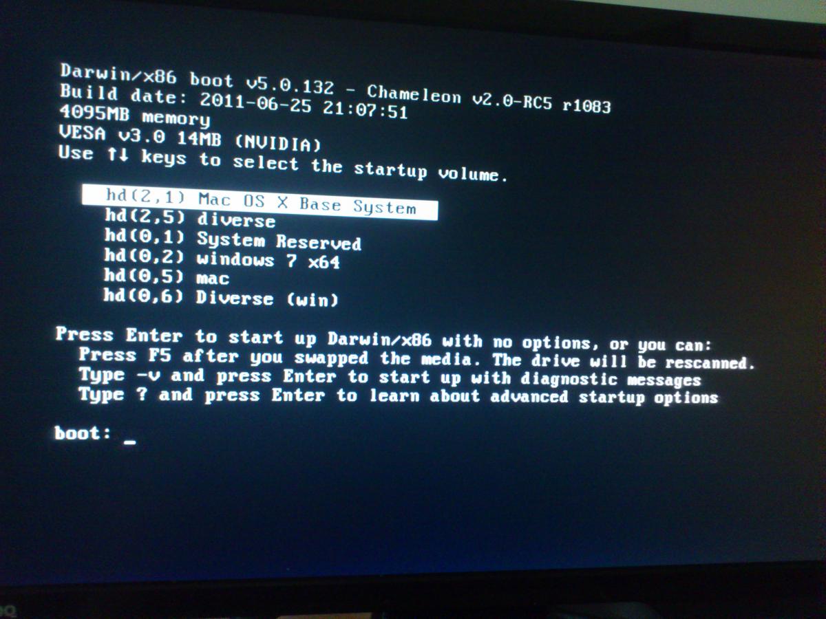

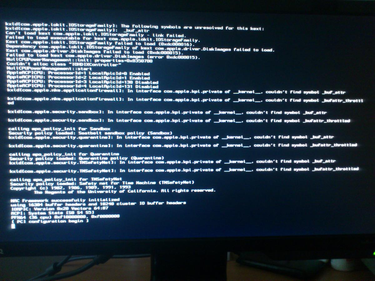

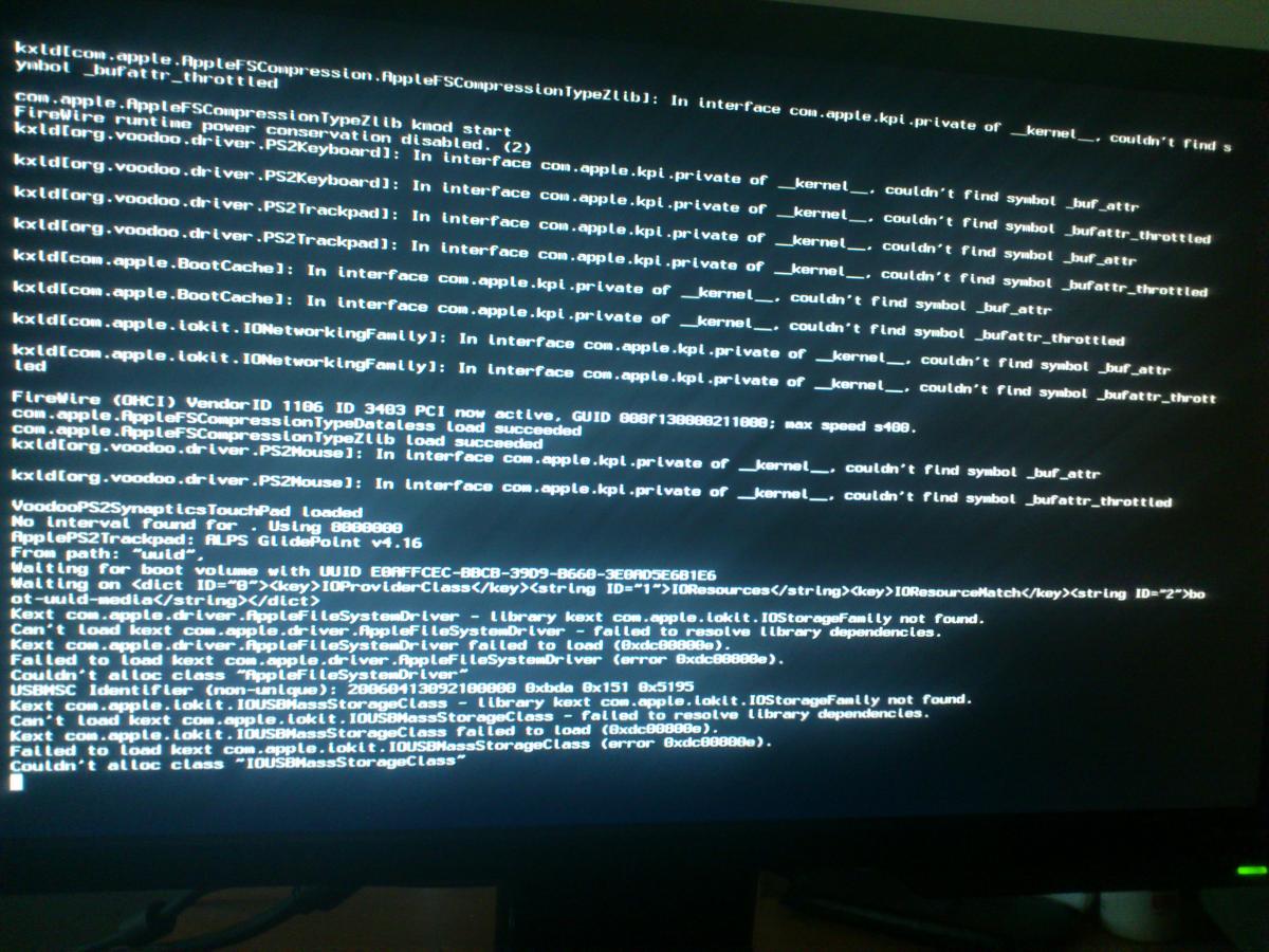

caguars Posted July 3, 2012 Share Posted July 3, 2012 I made a bootable usb flash stick, I use OSX Lion 10.7.4.dmg instead of 10.7, I boot up from the flash, chameleon screen appear, I choose Mac OS X Base system ( witch is my usb drive ), but it freeze at "PCI configuration begin". What is the problem ? Later edit: If I use "-v npci=0x2000" it freeze at "Couldn't alloc class IOUSBMassStorageClass". Link to comment https://www.insanelymac.com/forum/topic/277531-asrock-p5b-de-sleep-and-shutdown/#findComment-1831035 Share on other sites More sharing options...
caguars Posted July 3, 2012 Share Posted July 3, 2012 I made another usb flash with OSX Lion 10.7 ( I follow the tutorial you provided ), boot with -v npci=0x2000, but disk utility doesn't see any of my hdd drives ( I have 2 sata hdd drive ). He see only usb flash drive. I replace ioatafamily.kext with yours and disk utility see just one hdd ( the fisrt sata hdd ). I install macosx, but after restart hangs with "stiil waiting for root device". It seems that my computer only work with Iatkos L2 version ) Link to comment https://www.insanelymac.com/forum/topic/277531-asrock-p5b-de-sleep-and-shutdown/#findComment-1831072 Share on other sites More sharing options...

caguars Posted July 17, 2012 Share Posted July 17, 2012 I made another usb stick with retail OSX Lion 10.7, install was fine, boot was fine. But when I put your dsdt, same {censored} happens, it hangs on "pci configuration begin". -v npci=0x2000 flag doesn't help. Link to comment https://www.insanelymac.com/forum/topic/277531-asrock-p5b-de-sleep-and-shutdown/#findComment-1834653 Share on other sites More sharing options...
Fedd Posted July 31, 2012 Author Share Posted July 31, 2012 I made another usb stick with retail OSX Lion 10.7, install was fine, boot was fine. But when I put your dsdt, same {censored} happens, it hangs on "pci configuration begin". -v npci=0x2000 flag doesn't help. Try to repair the permissions when you put the DSDT. Also, make sure on the BIOS you have enabled these settings : Enhanced Sata,ACPI HPET,Speedstep,Enhanced Halt State,USB 2.0,Hyper Threading Edit: The hang at "pci configuration begin" depends on your Graphics card. Try "npci=0x3000" instead of "npci=0x2000" Link to comment https://www.insanelymac.com/forum/topic/277531-asrock-p5b-de-sleep-and-shutdown/#findComment-1839330 Share on other sites More sharing options...

Fedd Posted November 6, 2012 Author Share Posted November 6, 2012 The same panic regarding IOAtaFamily? Try my IOAtaFamily kext, from my second post. (Is in the archive) Install it with kext utility or kext wizard and reboot. (Make backup of your first) Link to comment https://www.insanelymac.com/forum/topic/277531-asrock-p5b-de-sleep-and-shutdown/#findComment-1865337 Share on other sites More sharing options...
