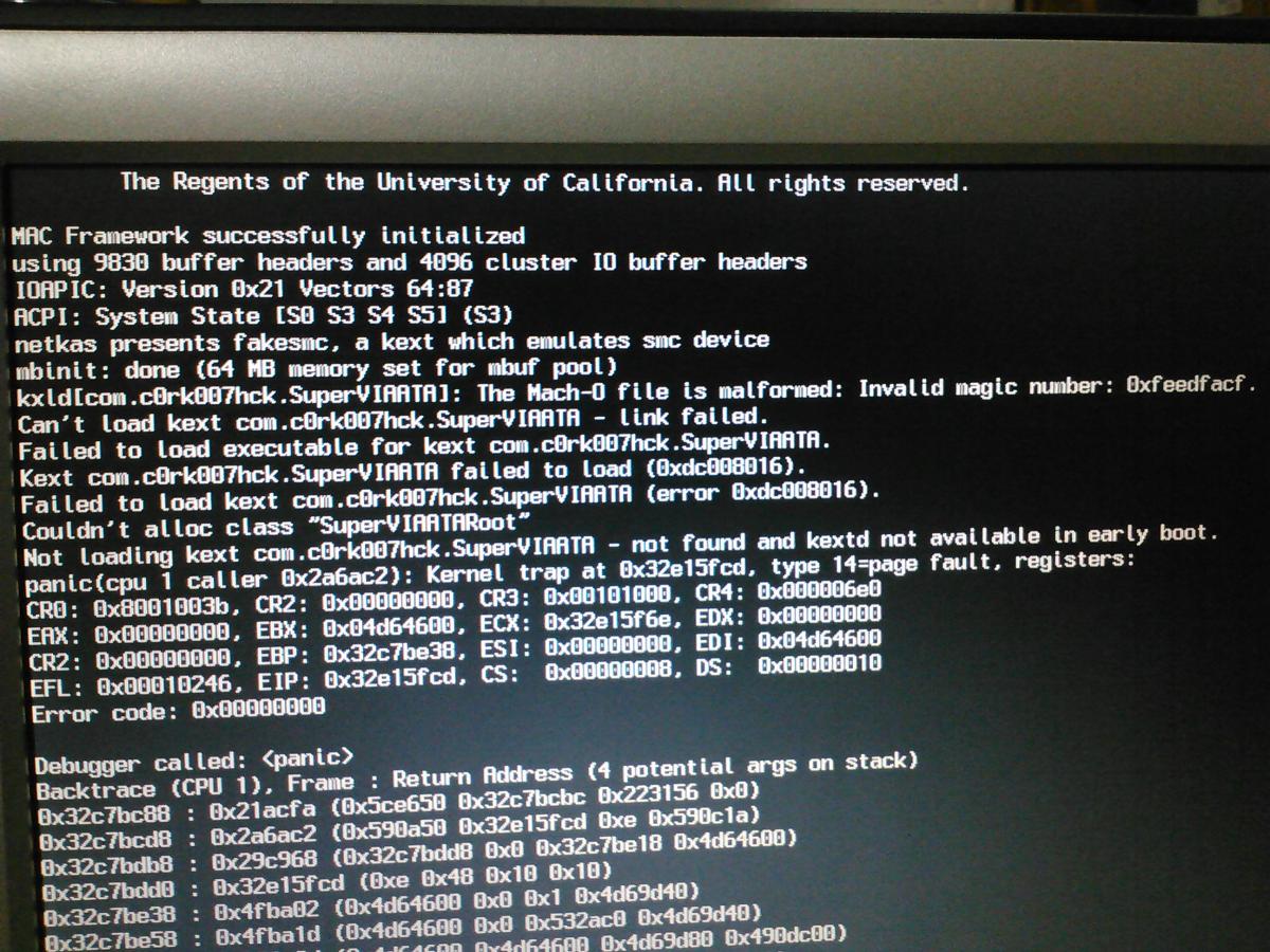

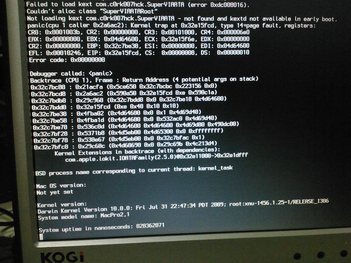

73grandam Posted March 21, 2012 Author Share Posted March 21, 2012 I saw that post and i cant find the guide he is using and the specs are Processor: AMD Athlon 64 X2 Dual-Core 4000+ processor 2.1 GHz 1 MB L2 cache 2000 MHz front side bus chipset: ATI Radeon® XPRESS 1150 RAM: 2 GB 800 MHz DDR2 SDRAM Graphics: Integrated ATI Radeon X300 graphics with VGA and DVI-D Hard Drive: 80 GB 7200 rpm RAID SATA 3.0 Gb/s Network: Integrated Broadcom 5755 Gigabit Ethernet Audio: Integrated High Definition audio with Realtek 2 channel ALC260 codec (all ports are stereo) I think thats everything. I dont have AHCI support on this motherboard. I don't know if that means i can't do it This is what i get in verbose from PCUniversal Link to comment https://www.insanelymac.com/forum/topic/277029-please-help/#findComment-1807371 Share on other sites More sharing options...
Gringo Vermelho Posted March 21, 2012 Share Posted March 21, 2012 SuperVIAATA.kext is loading for your hardware but it's obviously not cutting it. Use an install method that uses ATIATA.kext or SB700.kext instead of SuperVIAATA.kext for your hard drive controller. Link to comment https://www.insanelymac.com/forum/topic/277029-please-help/#findComment-1807374 Share on other sites More sharing options...
73grandam Posted March 21, 2012 Author Share Posted March 21, 2012 How would i go about doing this? sorry im kind of a noob. all my otherr installs work right away Link to comment https://www.insanelymac.com/forum/topic/277029-please-help/#findComment-1807375 Share on other sites More sharing options...
Gringo Vermelho Posted March 21, 2012 Share Posted March 21, 2012 Use the retail Snow Leopard 10.6.3 DVD and build your own Chameleon boot CD that has ATIATA.kext or SB700.kext on it. Or track down one that has it. To learn how to make your own Chameleon boot CD, go to the VoodooProjects forum, find a post by me and follow the link in my signature. Link to comment https://www.insanelymac.com/forum/topic/277029-please-help/#findComment-1807379 Share on other sites More sharing options...

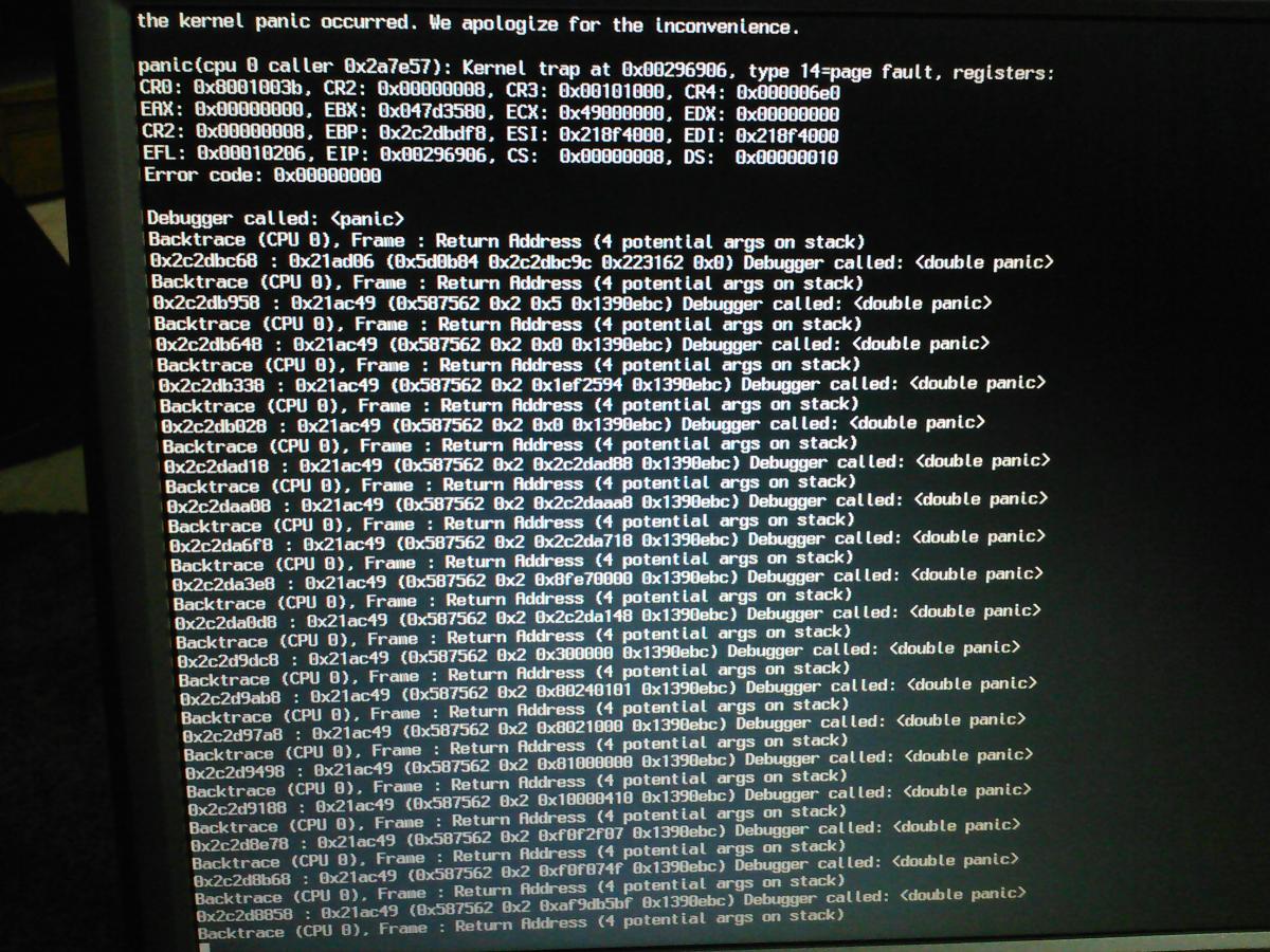

73grandam Posted March 27, 2012 Author Share Posted March 27, 2012 alright i got the whole system to work using snow leopard universal cd but i can only boot into safe mode using -x, when i dont i get a kernal panic, ill keep messing with it but in safe mode i cant get it to read my usb to install the ATIATA.kext or SB700.kext that i have Link to comment https://www.insanelymac.com/forum/topic/277029-please-help/#findComment-1808983 Share on other sites More sharing options...
rlf Posted March 28, 2012 Share Posted March 28, 2012 What does the kernel panic say (use -v)? Link to comment https://www.insanelymac.com/forum/topic/277029-please-help/#findComment-1809008 Share on other sites More sharing options...
73grandam Posted March 28, 2012 Author Share Posted March 28, 2012 when i type -v i get a bunch of backtrace errors. Link to comment https://www.insanelymac.com/forum/topic/277029-please-help/#findComment-1809107 Share on other sites More sharing options...
rlf Posted March 28, 2012 Share Posted March 28, 2012 I'm sorry, there is no information there that gives me a clue as to your problem. If you really want to, you can try to modify the iAtkos install DVD. The reason it is waiting for root device is that OSX cannot find a usable driver to boot the dvd. Drivers are stored in /System/Library/Extensions directory. But to speed things up, a compressed version is kept which is called Extensions.mkext. It is stored in /System/Library/Caches/com.apple.kext.caches/Startup/Extensions.mkext. The process to modify the DVD is to convert it to a read/write image. Grab the Extensions.mkext and expand it. Modify it to add needed drivers. Compress it and put it back into the read/write image. Then create a DVD from the modified read/write image. Here is a guide to help with some of it: http://www.insanelymac.com/forum/index.php?showtopic=67713 Other than that, I have nothing more to offer you. Link to comment https://www.insanelymac.com/forum/topic/277029-please-help/#findComment-1809119 Share on other sites More sharing options...
