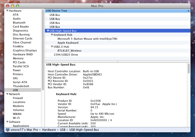

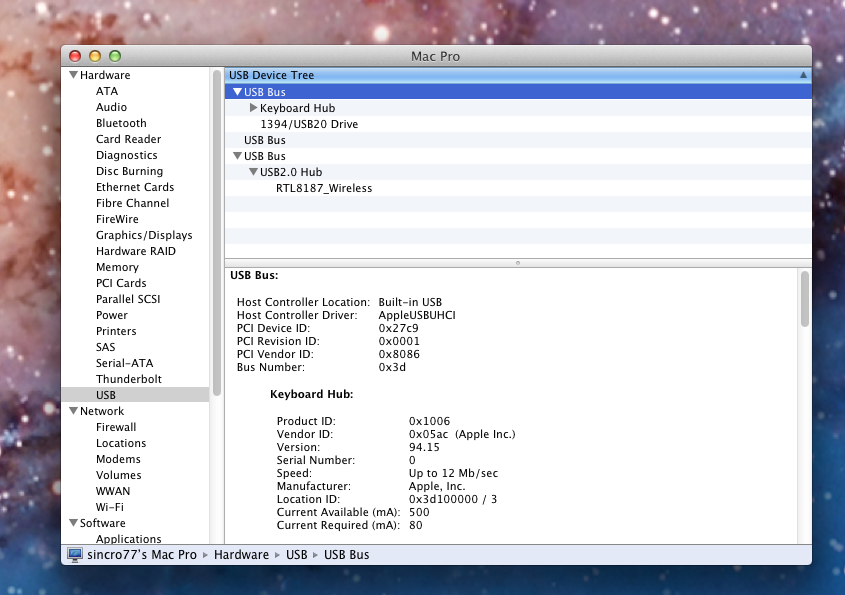

Guest sincro77 Posted February 23, 2012 Share Posted February 23, 2012 okay i managed to boot using cache.. but it took $#%*@ 5 minutes. here is why.. usb was stuck in 1.0 uhci see screenshots. its a usbehci uim initialize error if i try to boot with caches,, i waited it out.. the second screenshot shows usb high speed is enabled ehci ..( thats without using cache. i dont care.. I just bought a 80gigsata drive at computer store for 10 bucks so im gonna clone ML onto sata ahci HD and im sure that will solve it.lol i dont usually run an OS off usb anyways,, i was testing ML... cheers. __________________________________________________________________________ Boot duration: some people time the boot using a stopwatch or whatever... me, I just count the spins of the mac boot spinning wheel. (non-verbose).... im getting 25 spins with ML , lion-19spins., snow-15spins., leopard.8 spins. It seems like each new Cat takes a bit longer to boot..? i like ML.... but i also like the 'instant on' i get booting leopard.! my 2 cents Link to comment Share on other sites More sharing options...
Guest sincro77 Posted February 23, 2012 Share Posted February 23, 2012 pinpointed the usb ehci issue . . . any "Low-Speed" device on the bus at handoff/initialisation buggered things. . . & wouldn't you guess it? . . . the Low-Speed device in question [a mouse] was made by none other than the Microsoft Corporation wierd that these usb issues only happen if i use the cache. and this board has flaky usb detetction issues in osx.. Asus P5wdh deluxe. sometimes certain ports dont work.etc. yes,, ive tried with and without a dsdt.aml. also with and without hpet option. Link to comment Share on other sites More sharing options...

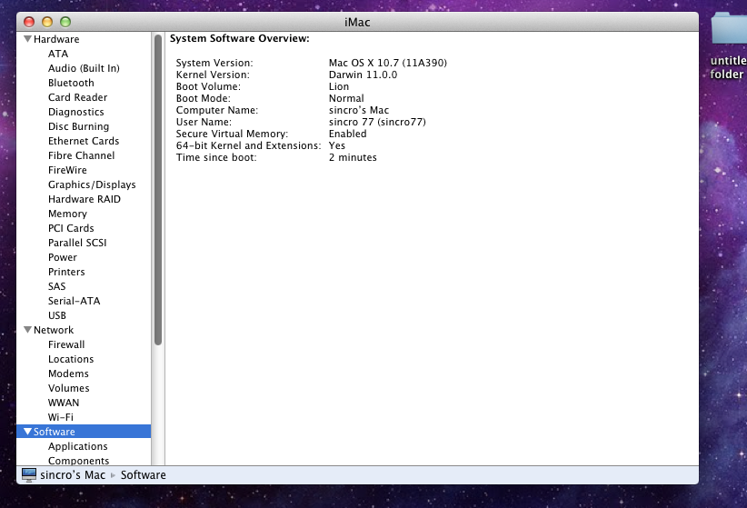

Guest sincro77 Posted February 24, 2012 Share Posted February 24, 2012 yep.. still doesnt boot the kernel in full 64bit .. userspace is 64 but not kernel... i really dont care.. but someone might though.//? let them figure it out,. see look: . the same machine in full LP64 bit with10.7 Lion..(see screenshot): cheers my Mountain Lioneers, ) Link to comment Share on other sites More sharing options...
