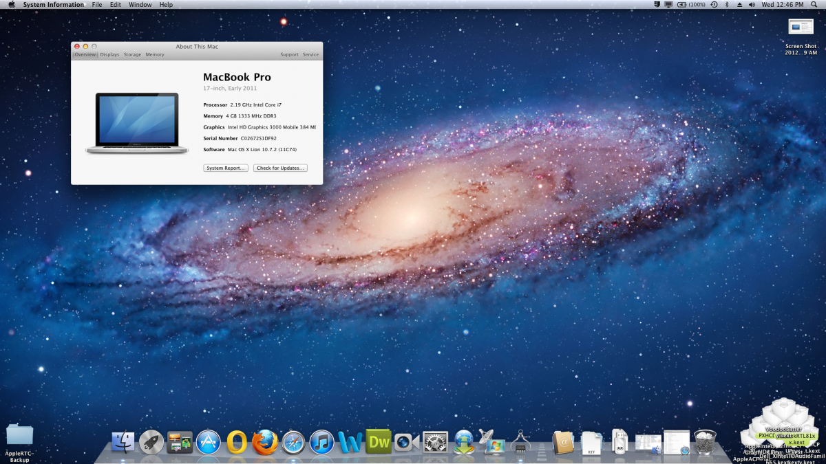

Jszekely Posted January 25, 2012 Author Share Posted January 25, 2012 I will also upload my DSDT.aml, currently using it successfully under Lion 10.7.2 with Dell BIOS A16 installed. I haven't put my second RAM stick back in yet (as I tweak things I boot into the [url="http://www.insanelymac.com/forum/topic/279450-why-insanelymac-does-not-support-tonymacx86/"]#####[/url] USB drive and image my working boot to an external partition as a backup), but I have all USB ports working and functional, both 2.0 and 3.0. eSATA works, as does audio, function keys on the keyboard (haven't tried brightness control, but backlit key brightness works, as well as volume), and bluetooth. Intel HD 3000 graphics are recognized, thought it only shows 384mb RAM. It works, just haven't had time to mess with it (besides being afraid I might mess up what I have working so far). I haven't had any perceptible problems with the new BIOS; in fact, it seems I've gotten the most success after I installed it with the most recent build. As I said previously, I have it dual-booting from a single (GPT) partitioned drive (WD 750 GB), MACBOOT as the first partition, formatted Mac OS, Journaled. WIN7BOOT is the second partition (partition 3), formatted NTFS. I know nothing about C+ programming, so if anyone sees anything of note in this DSDT, or makes useful changes to improve it, please let me know or re-post it. Thought I'd also provide this screen shot, in case it gives any further helpful information. If you think it will help, let me know if you'd like to see my System Information. **UPDATE** After reinstalling the second 4GB RAM stick, the system now shows 512mb VRAM for the Intel HD 3000 graphics. Dell_XPS_L702X_A16.aml.zip 1 Link to comment https://www.insanelymac.com/forum/topic/274474-dsdt-for-dell-xps-l702x-with-core-i7-2670qm-220-ghz-cpu-no-3d/#findComment-1789463 Share on other sites More sharing options...
