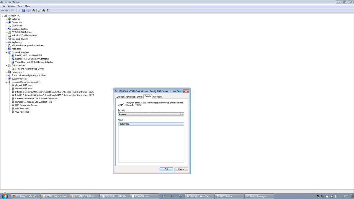

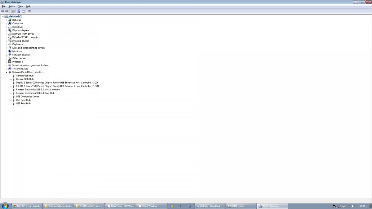

mackyreddy Posted March 6, 2012 Author Share Posted March 6, 2012 @ Jupiter Moon Can u just let me know ur USB Dev-ids, check the pics my USB-Dev-id's are 1C26 and 1C2D. And after this i need the Addresses of the USB Dev-id's as well, which can found in this way. 1. Just double click the Intel® 6 Series/C200 Series Chipset Family USB Enhanced Host Controller - UR Dev-id 2. Then go to details tab, Now in Property drop down menu select ADDRESS and please let me know the value, please do the same to the other USB host controller as well, just let me know the 2 USB Dev-ids and their Addresses. Link to comment Share on other sites More sharing options...

mackyreddy Posted March 6, 2012 Author Share Posted March 6, 2012 Ok here u go Updated with USB Dev-id's.Let me know whether it works or not. XPS 17 3D Core i7 DSDT.rar Link to comment Share on other sites More sharing options...
jupitersmoon Posted March 6, 2012 Share Posted March 6, 2012 @ Jupiter Moon Can u just let me know ur USB Dev-ids, check the pics my USB-Dev-id's are 1C26 and 1C2D. And after this i need the Addresses of the USB Dev-id's as well, which can found in this way. 1. Just double click the Intel® 6 Series/C200 Series Chipset Family USB Enhanced Host Controller - UR Dev-id 2. Then go to details tab, Now in Property drop down menu select ADDRESS and please let me know the value, please do the same to the other USB host controller as well, just let me know the 2 USB Dev-ids and their Addresses. Same 1C26 - 001D0000 1C2D - 001A0000 Link to comment Share on other sites More sharing options...
jupitersmoon Posted March 6, 2012 Share Posted March 6, 2012 Download the DSDT from the previous post, i just added ur USB Dev-id's to the DSDT, recompiled and attached a new DSDT. cheers, i just saw that after posting usb specs. i tried it and my usb is working with it but my audio isn't working now. I know its not the ideal but i just installed voodooHDA and my sound is back and better than ever. More bass and is also recognising HDMI audio. I think I'm good to go. Thank you for all your help. VoodooHDA-2.7.3.pkg.zip Link to comment Share on other sites More sharing options...
