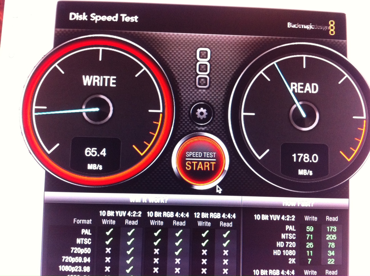

qbaser Posted October 10, 2011 Share Posted October 10, 2011 I've finally got Lion installed on my PC, running pretty well. Just that I did a speedtest on the SSD the read speed is half of the speed when its in my 2011 MBP, and the write speed is around one third. (see attached images). Is there some way to fix the speed to closer to 240+Gbps? Thanks Al Link to comment Share on other sites More sharing options...

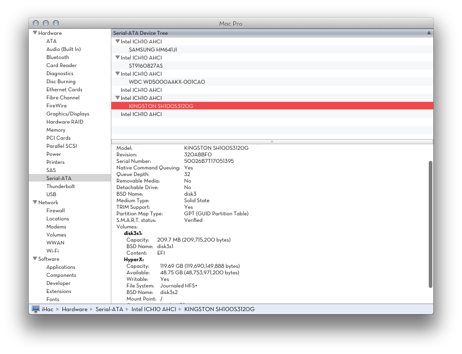

TH3L4UGH1NGM4N Posted October 10, 2011 Share Posted October 10, 2011 Unless the Vertex 2 doesn't support trim at all in OS X it should workout for you because on my HyperX SSD trim works fine. As for enabling it you could just try this little app attached reboot and check in system pref if it is enabled. As for the reason why you're not seeing speeds about the 280mb/s range is because of your ssd being a SATA II although your MBP supports SATA III you won't get near those speeds with your current ssd because of architecture limitations (SATA II vs SATA III). In my case, my Kingston HyperX is a SATA III SSD so I get the rated speeds of ~520 read and ~510 write give or take a few mb/s here and there. So yeah buying a sata 3 ssd will get you the real speeds you wanted from your MBP. @KariNeko for a vert 2 why are you speeds so low? TRIM_Enabler.zip Link to comment Share on other sites More sharing options...

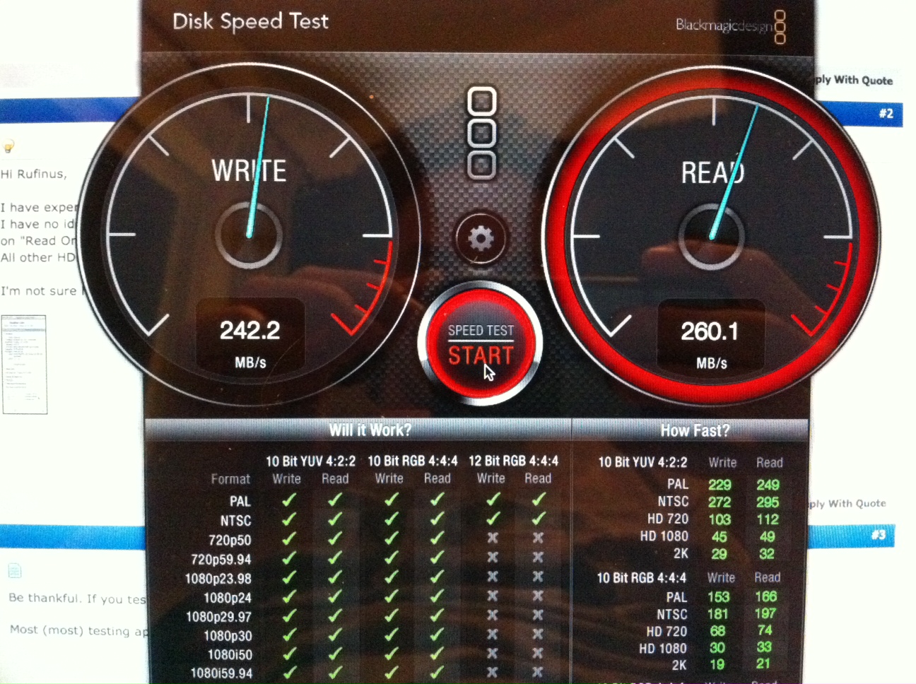

qbaser Posted October 10, 2011 Author Share Posted October 10, 2011 This is strange, Here is screen shot from my 2011 MBP running the same Vertex 2 drive (ok its double capacity but...). Its not running Trim, yet its achieving the 260GBs speeds. So trim isnt a factor then? Is my Hackintosh MOBO ASUS P6Tse even capable of the same speeds as the MBP? Compare the two screen shots, my Hackintosh SSD and my MBP SSD Hope someone can help. Al Untitled.tiff Link to comment Share on other sites More sharing options...
