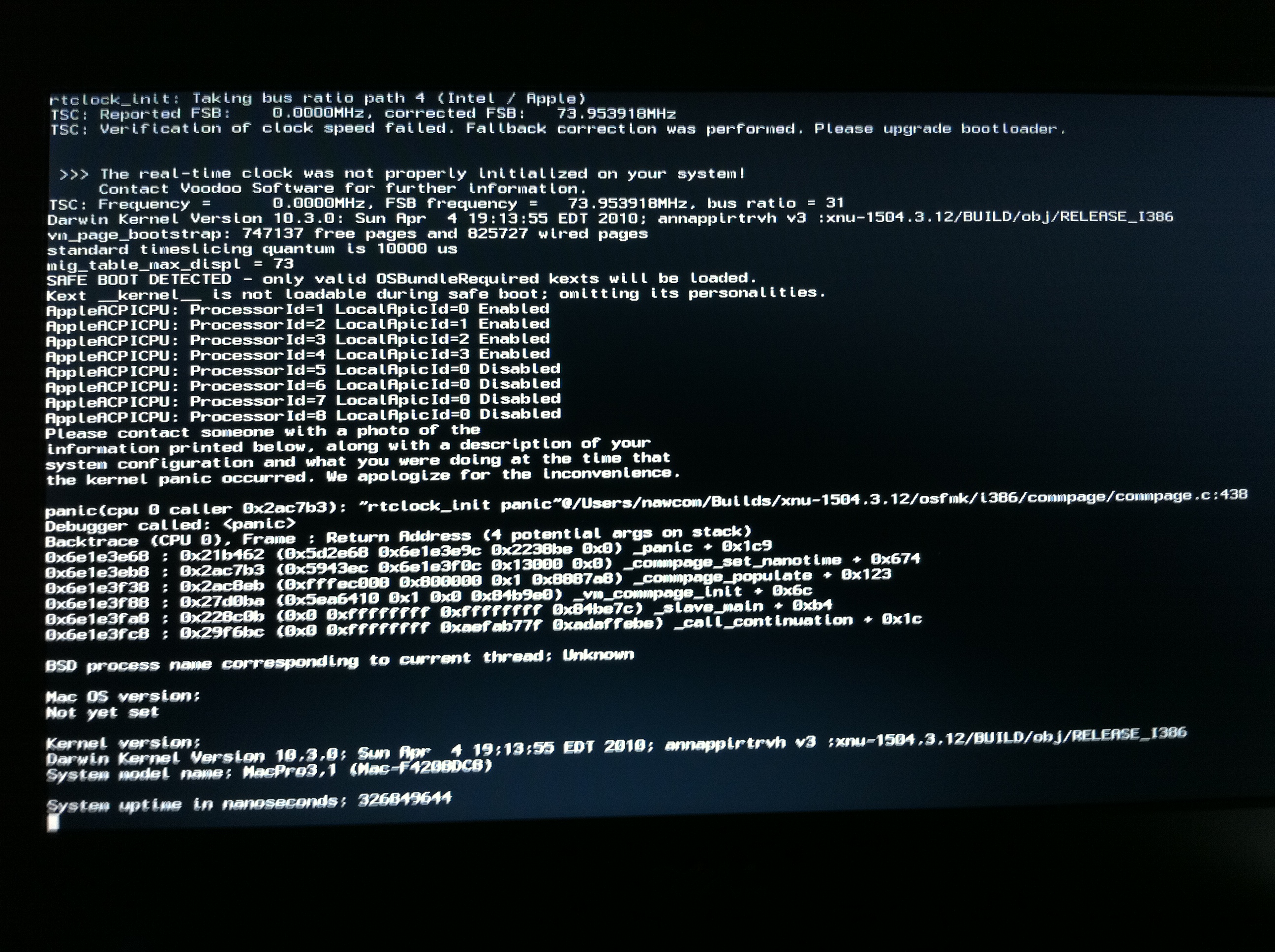

LatinMcG Posted October 8, 2011 Share Posted October 8, 2011 kernel panic picture link might help. Link to comment Share on other sites More sharing options...
OtaK Posted October 9, 2011 Author Share Posted October 9, 2011 Here it is I booted with -x -v args, as I was doing with my main computer. Link to comment Share on other sites More sharing options...
LatinMcG Posted October 9, 2011 Share Posted October 9, 2011 so u have issues with RTC and u need also VoodooTSCSynch.kext also notice how 1/2 of the cpu is used. (disabled) Link to comment Share on other sites More sharing options...

OtaK Posted November 19, 2011 Author Share Posted November 19, 2011 Update : Used iATKOS L2 (Lion 10.7.2) and it works. Just one point, the AMD HD6630m is not recognized (causes system not to boot) and I'm looking to force MacOS to use the HD3000 inside my i5, any ideas ? Link to comment Share on other sites More sharing options...
dexz Posted December 9, 2011 Share Posted December 9, 2011 Update : Used iATKOS L2 (Lion 10.7.2) and it works. Just one point, the AMD HD6630m is not recognized (causes system not to boot) and I'm looking to force MacOS to use the HD3000 inside my i5, any ideas ? I have same model with you and install iatkos L2. HD6630 not yet support on mac I think. i managed to boot mac os x lion. What i did was after finish install iatkos L2 then reboot it but make sure you insert rBoot LE cd then from the boot menu chose your mac osx with/without -v then i run [url="http://www.insanelymac.com/forum/topic/279450-why-insanelymac-does-not-support-tonymacx86/"]#####[/url] 4.1.0: Lion Edition.. install [url="http://www.insanelymac.com/forum/topic/279450-why-insanelymac-does-not-support-tonymacx86/"]#####[/url], systems utilities, bootloader & etc etc.. after that reboot. reboot without rBoot LE cd. Good luck! Link to comment Share on other sites More sharing options...
OtaK Posted December 13, 2011 Author Share Posted December 13, 2011 Did the same, Installed L2, rebooted, modified smbios.plist through windows (or via terminal on L2's disc) to a MacBook Pro 8,2's one, then it booted, had to install PS/2 kext to have keyboard / trackpad (without multitouch though, acts as a mouse, if you have better, just let me know, because I tried the other driver around, and it doesn't work at all, even if it loads). Wifi (Intel 1030) doesn't work, had to buy a wifi dongle (TRENDnet TEW-648UBM, they have drivers for MacOS, just install the ones for SL, they work under Lion). The big problem is the battery, 4h at most with my 9cells... :/ I'm pretty sure it's because the 6630m is still working, even while being disabled. Link to comment Share on other sites More sharing options...
