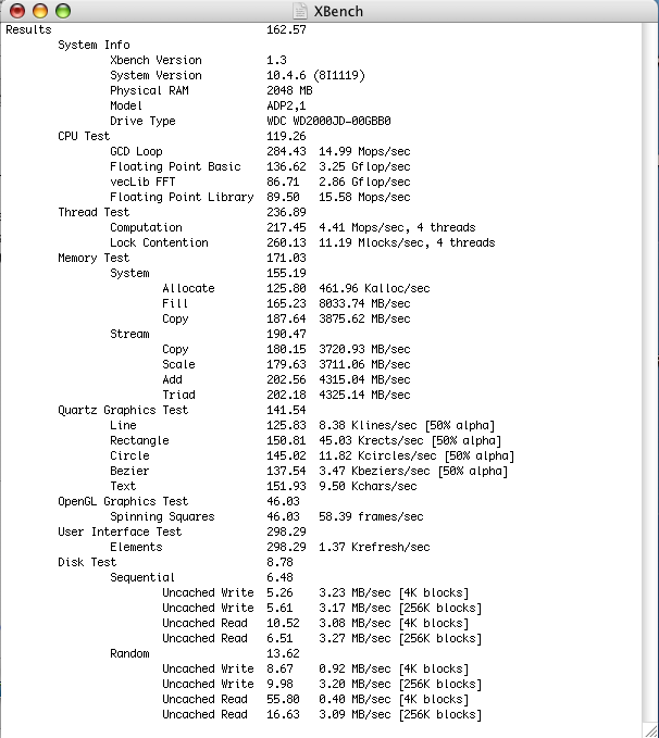

I ran XBench on my system to see how everything performed, i dont know wat any of it means compared to others that have ran it but ill attach the screen shot of the resuts for you all to see
Anyhow, thanks all for the help with everything, ill b keeping an eye on this post and helping out whenever i can to return the favour
