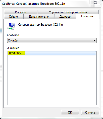

Mynzhasar Posted September 16, 2011 Share Posted September 16, 2011 My Wi-Fi doesn't work. I'm using 32-bit of Lion Link to comment Share on other sites More sharing options...
LatinMcG Posted September 16, 2011 Share Posted September 16, 2011 AR5B91 or BCM94321MC cheap. we need wireless device details lspci -vn Link to comment Share on other sites More sharing options...
Mynzhasar Posted September 17, 2011 Author Share Posted September 17, 2011 Thanks for reply! It is BCMXXX Link to comment Share on other sites More sharing options...

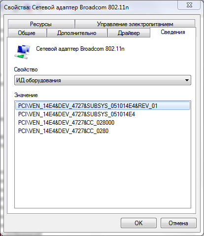

LatinMcG Posted September 18, 2011 Share Posted September 18, 2011 BCM4313 with PCI ID 14e4:4727 lots of people cant get it to work. change it. Link to comment Share on other sites More sharing options...
Mynzhasar Posted September 18, 2011 Author Share Posted September 18, 2011 What should I change? Link to comment Share on other sites More sharing options...
LatinMcG Posted September 19, 2011 Share Posted September 19, 2011 the wireless card. but lenovo puts a lock for subsystem id of wireless in bios. so u have to flash bios with whitelist removed. (so u can use any brand wireless like AR5B91 or BCM94321MC) to get whitelist u have to make a forum post at website forums.mydigitallife.info with link to bios Link to comment Share on other sites More sharing options...

Black SER Posted November 7, 2011 Share Posted November 7, 2011 Latin..can you please help me. I also have this same card and don't care for my warranty. I checked my card with the pics of the original OP it it matches perfect. Are you telling me I have to fully remove my card and install a new one? I will try to see if I can unlock my bios with whitelist. Link to comment Share on other sites More sharing options...
LatinMcG Posted November 7, 2011 Share Posted November 7, 2011 Latin..can you please help me. I also have this same card and don't care for my warranty. I checked my card with the pics of the original OP it it matches perfect. Are you telling me I have to fully remove my card and install a new one? I will try to see if I can unlock my bios with whitelist. device id 4727= yes replace nobody got it to work. Link to comment Share on other sites More sharing options...
Black SER Posted November 7, 2011 Share Posted November 7, 2011 device id 4727= yes replace nobody got it to work. Latin..Thxs for your help. I have a Lenovo i5 with the BCM 4313/4727. Where would I start at getting a whitelist bios. Do you know if this has already been done for this computer? (a link). I know you posted a link to another forum, but i'm clueless on where to begin. Link to comment Share on other sites More sharing options...
LatinMcG Posted November 8, 2011 Share Posted November 8, 2011 Latin..Thxs for your help. I have a Lenovo i5 with the BCM 4313/4727. Where would I start at getting a whitelist bios. Do you know if this has already been done for this computer? (a link). I know you posted a link to another forum, but i'm clueless on where to begin. bios-mods.com or forums.mydigitallife.info you will need the model and type for lenovo.(sticker under it) Link to comment Share on other sites More sharing options...
