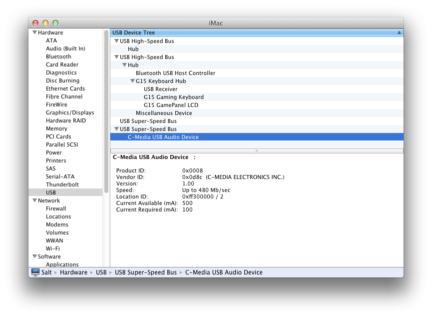

The main dilemma I am encountering right now is the inability to use my headset (USB). I have a Tritton AX Pro headset connected to a Dolby Digital mixer (the only device my headset will attach to), which is connect via USB to my on-board sound card.

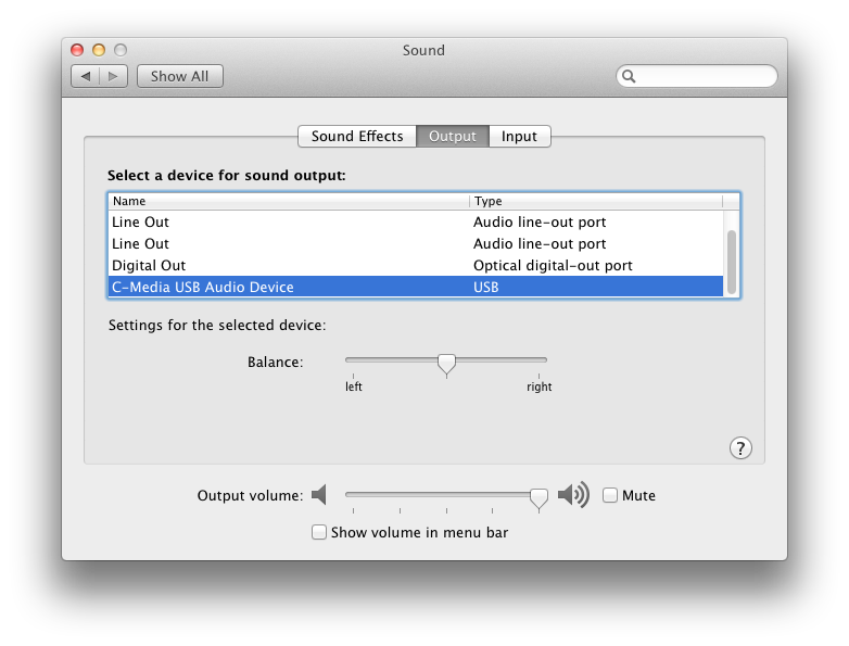

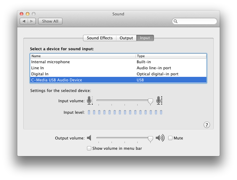

As shown in the attachment, the selected devices (C-Media USB Audio Device) for both input and output seem to be recognized but have no functionality. I cannot hear any sound nor can the microphone indicator pick up any audio at all. I've searched countless hours for this is the only remaining issue that really matters to me at this point. I use my headset for Skype/miscellaneous communication and my external speakers for liesure.

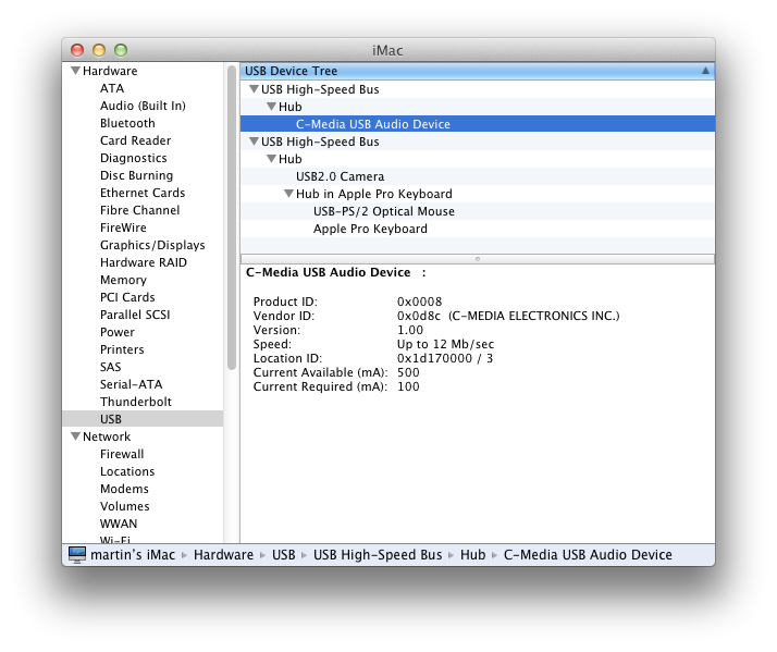

I have a C-media USB headset. Never had any problems with it. Worked OOTB without any special drivers/kexts.
Never tried it in Lion, though. Will try today and report back. :wacko:
Update: Tried in Lion (SystemOne in my sig) - no probs @all. Working fine. Maybe you should try to revert everything back to vanilla?

Seems I was foolish and didn't even consider it could have been the USB port that the headset was plugged into.
As shown, it was attached to a USB Super-Speed Bus as compared to the USB High-Speed Bus. I plugged it into a High-Speed port and it worked fine. The speed of a High-Speed Bus is only 12 Mb/sec, though, as the Super-Speed Bus is 480 Mb/sec (obviously preferable :)). I'm probably missing kexts to use my Super-Speed Bus ports I would assume. That's going to become really annoying..
I'm not too familiar with USB ports or their infrastructures, especially their compatibility with Mac, so what is to be done about these Super-Speed Bus ports?
