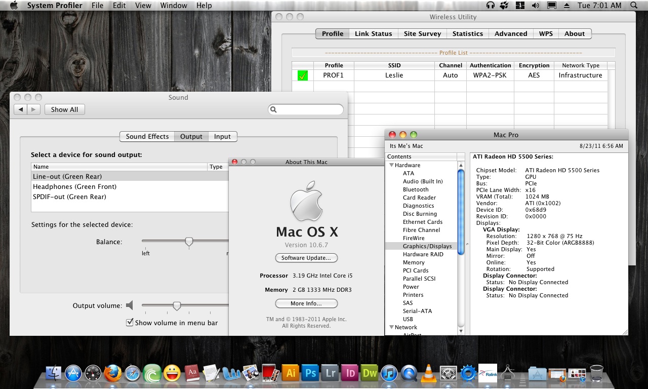

Just recently bought this new HP Desktop and surprisingly everything seems to work.

"Nawcom's Boot CD" is the real deal. This Boot cd along with Retail Snow disc did the job for me.
After updating to 10.6.7 using 10.6.7 Combo Update, graphics worked out of the box. For Wi-Fi, I used original software on Ralink website. VoodooHDA 0.2.56 works perfectly on this machine.
The major boot flags are cpus=1 busratio=24. After install, in order to boot from hard drive, add "maxmem=2048".
Will be upgrading to LION very soon! This computer is very good, GET ONE!
