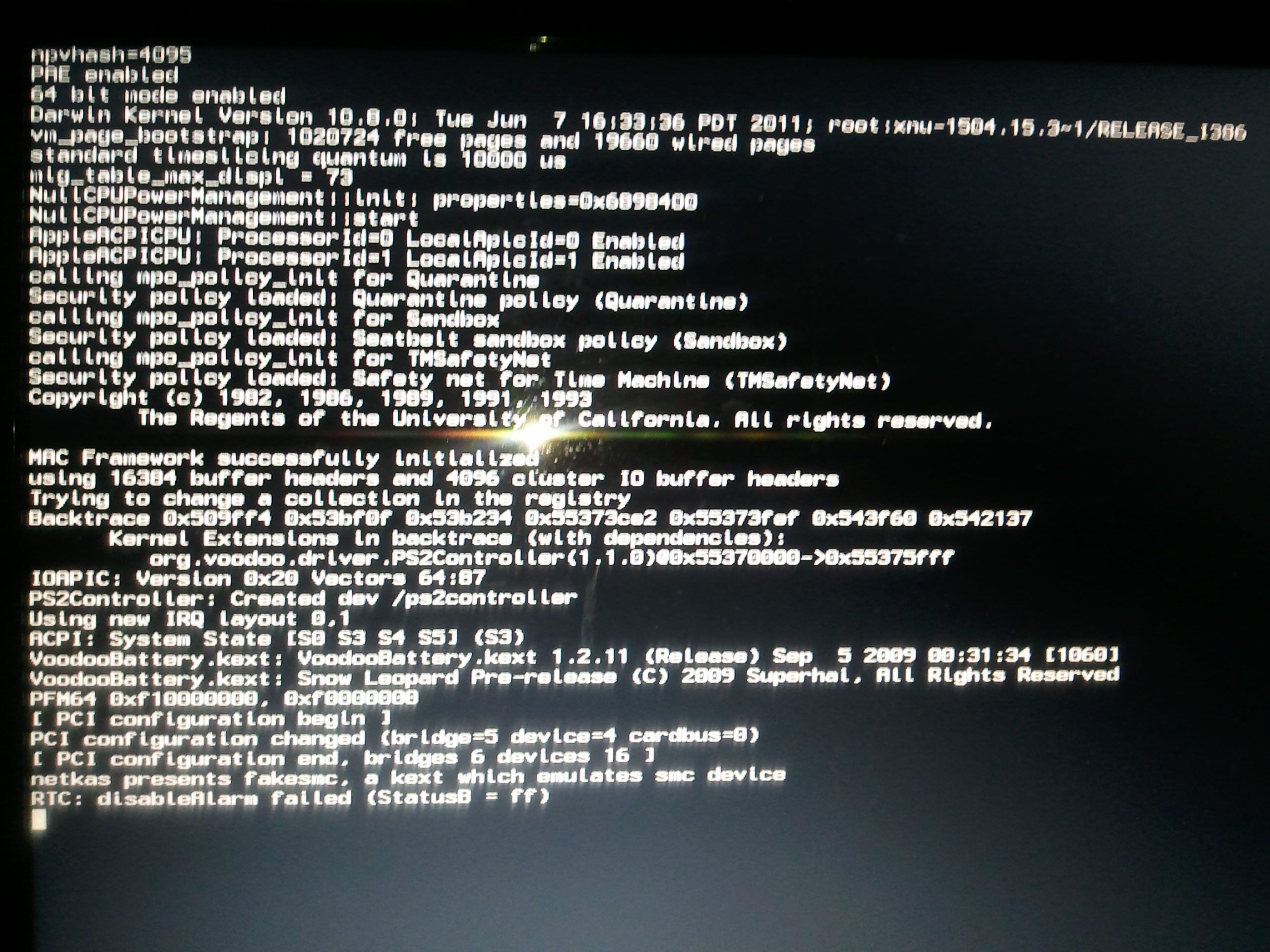

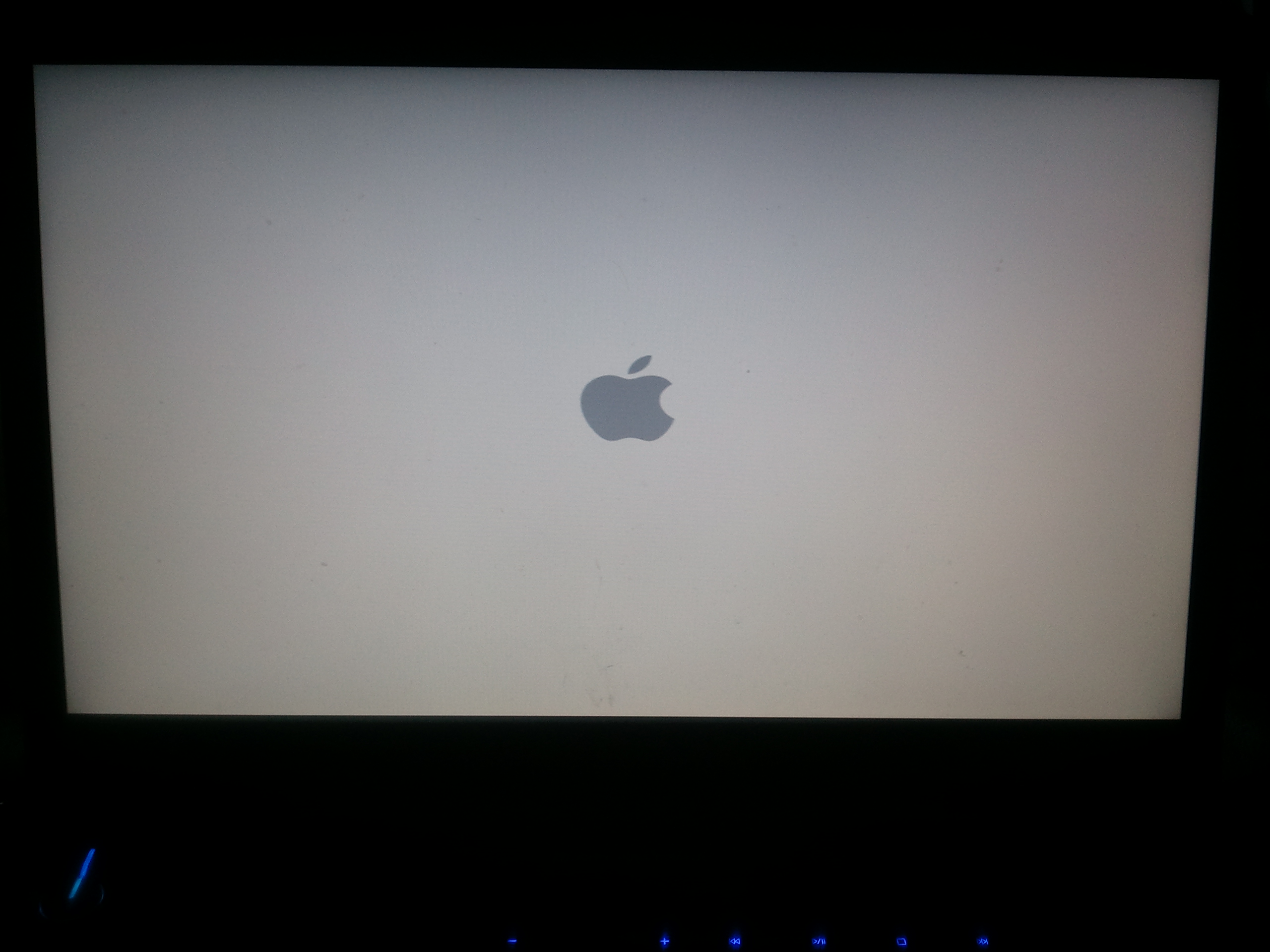

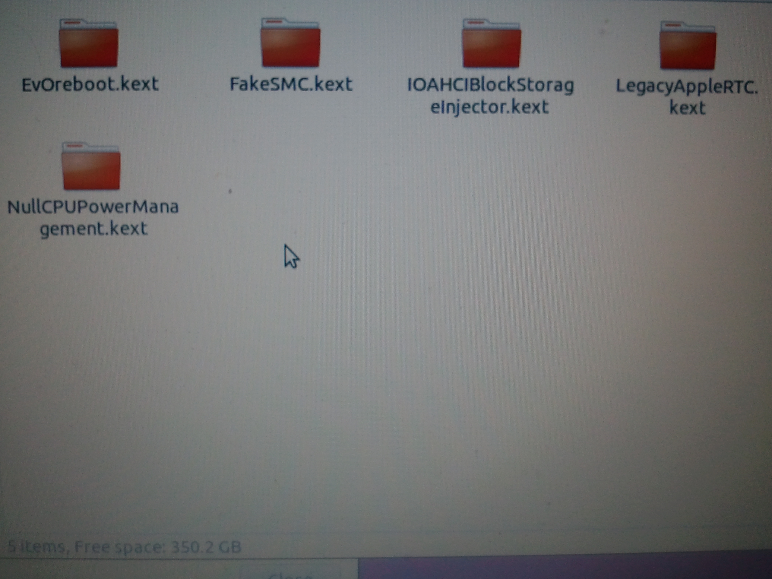

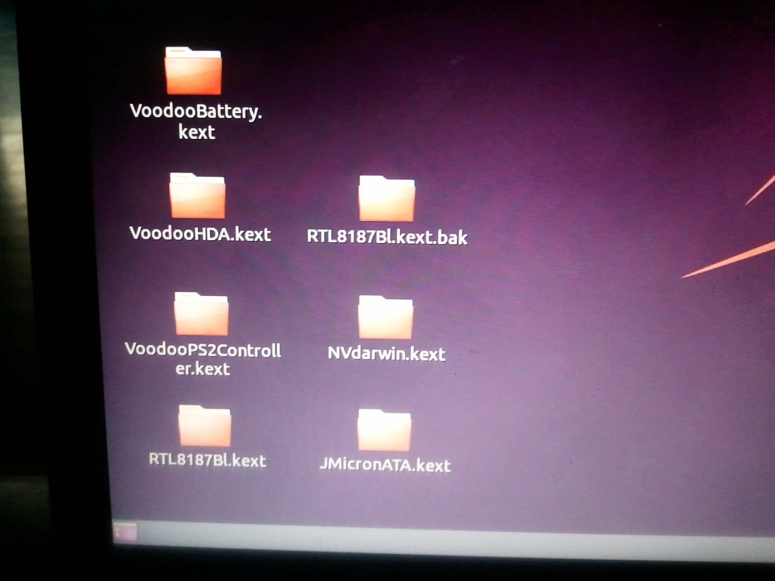

shoobirdy Posted July 29, 2011 Share Posted July 29, 2011 Hiya Hoping someone might be able to help (who doesn't wonder that!). So basically after not using OSX for the last 6 months (mainly because of having to use a USB dongle for wifi) the release of Lion made me want to switch back again. I was running 10.6.7 and completely forgot that I was about to be an idiot and started to software update to 10.6.8. So that all "went ok" until startup and now it just hangs on the apple logo screen. My knowledge since I installed OSX has pretty much disappeared but I'll try to give you what I know and attach some pics to help explain :-) I'm running vanilla OSX originally from the 10.6.3 disc on an Acer 6930g. It's always been stable whilst running it and most stuff works with the exception of ethernet and wifi (hence the dongle). I used Empire EFI 1.08 to boot and MyHack to add stuff IIRC. Anyways, I remember last time I updated sleepenabler.kext gave me trouble and reading nawcom's blog it seems the same for 10.6.8? I couldn't remember what kexts I had added so I used Ubuntu to access my OSX hdd to view what was in my extensions and extra folder (I think those ones are correct at least). I've attached a couple of photos showing the ones that I added (to my knowledge) in the hope that someone can help me track the conflict (I'm wondering about the legacy kernel since that was also on nawcom's blog). With regard to solving the problem...is there any way I can "inject" the required kexts onto my hdd without booting into osx? Maybe using Ubuntu or something? I wonder if I can boot Empire EFI > retail disk and use terminal from there but I wouldn't know where to start with the codes of how to actually get the kexts "delivered". Sorry, pain in the ass I know, but hopefully someone can point me in the right directions Thanks EDIT: Just added the verbose mode screenie. Basically single user mode, ignore caches mode (-k?) and single user mode all give this result. Seems to stop after mentioning Fake SMC or RTC so I'm guessing they could be the problem? Link to comment Share on other sites More sharing options...
Foxic Posted July 29, 2011 Share Posted July 29, 2011 Use MacDrive 8 from windows to update any kexts you need, but this seems to be related to RTC (real time clock). Is the time and date set correctly in the BIOS, also is sleep set to (S3)? You could try swapping AppleACPIPlatform.kext and IOPCIFamily.kext in S/L/E for the ones used in 10.6.7. That worked for alot of people, myself included. Link to comment Share on other sites More sharing options...
shoobirdy Posted July 29, 2011 Author Share Posted July 29, 2011 Use MacDrive 8 from windows to update any kexts you need, but this seems to be related to RTC (real time clock).Is the time and date set correctly in the BIOS, also is sleep set to (S3)? You could try swapping AppleACPIPlatform.kext and IOPCIFamily.kext in S/L/E for the ones used in 10.6.7. That worked for alot of people, myself included. Thanks for the reply Well my BIOS clock is set to the correct time. But I remember now that I always had the problem that when I booted into OSX and then back into windows the time would go back by an hour...or maybe forward. I never knew the problem for this. Since then I've moved to New Zealand so my time zone has changed considerably(!) which I changed in windows but never in OSX. I don't know if that could have any bearing at all. With regard to sleep set to (S3), I can't find any option for anything like that in BIOS, unless I'm misunderstanding you completely MacDrive 8 won't install on my computer for some reason, just comes up with the setup.exe loading and then exits out. I though maybe it's because I use Win7 HP 64bit but according to the MediaFour website ver8 is compatible with 64 bit systems. Oh and one other point I forgot to mention...Win7 and Mac OSX are installed on separate hard drives on my comp. I don't know if that's relevant at all lol! Link to comment Share on other sites More sharing options...

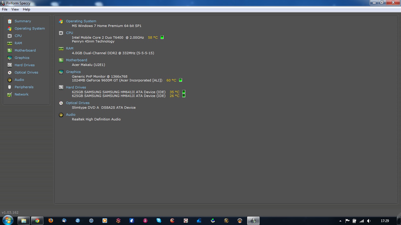

sid. Posted July 30, 2011 Share Posted July 30, 2011 You need to backup your graphics drivers from 10.6.7 if you're using an ATI card like I am.. plus sleepenabler.kext.. Look for SleepenablerNG.kext.. that one kext works with all versions of 10.6.x ... then probably a IOPCIFamily fix.. you know you should post your hardware config.. Link to comment Share on other sites More sharing options...
shoobirdy Posted July 30, 2011 Author Share Posted July 30, 2011 You need to backup your graphics drivers from 10.6.7 if you're using an ATI card like I am.. plus sleepenabler.kext.. Look for SleepenablerNG.kext.. that one kext works with all versions of 10.6.x ... then probably a IOPCIFamily fix.. you know you should post your hardware config.. I attached a screenie of my system specs in 1st post Geforce 9600m GT 1GB. I replaced all the kexts suggested in the 2nd post by hacking the Macdrive installation a bit lol. Then I was still not booting and tracked that down to PdaNet which I previously had installed. The I was still not booting so removed the NVDarwin.kext I was using to get my card supported. After that I managed to get booted and all seemed well. Then I tried to download Lion and got the app store problem I've tried editing my boot plist and stuff but now getting the RTC problem again. Can't really be bothered to do any more this weekend....wasted a whole day on this and the girlfriend is moaning lol! Thanks for your input anyway Link to comment Share on other sites More sharing options...
