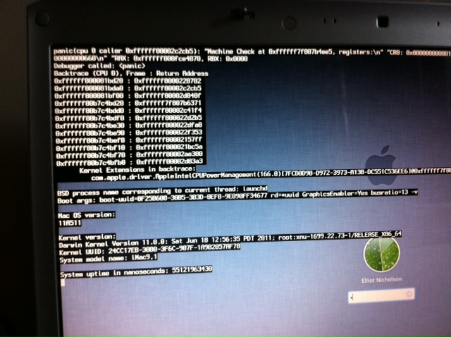

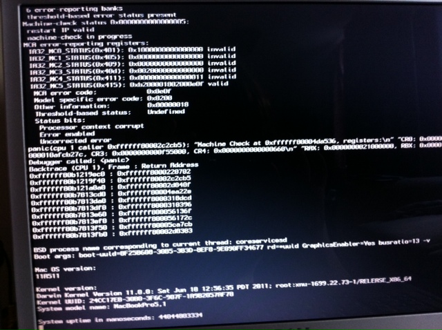

ellnic Posted August 1, 2011 Author Share Posted August 1, 2011 If I use the 5,1 plist, I get a KP. I have been having a weird issue since I changed CPU's and it would seem to appear that the CPU is faulty, but I have tested it thoroughly in Windows and it's working fine. Also, I do not get the problem with SL. I thought this may also be a DSDT issue. A more detailed description is here but I have had no replies...: http://www.insanelymac.com/forum/index.php?showtopic=263545 I have attached the KP... Any ideas? It seems like it's the CPU power management kext... could this be under powering my CPU? I had no problems before I changed it... but I am sure I didn't damage it in the process. I used Intel's own test suite, Dell's test suite and a few others and they all say there is no problem with it! I don't get this error when I use a 4,1 plist, but then it's really slow unless I use nullcpupowermanagement.... Link to comment https://www.insanelymac.com/forum/topic/263792-dsdt-patching-required-for-inspiron-1720/#findComment-1727435 Share on other sites More sharing options...
