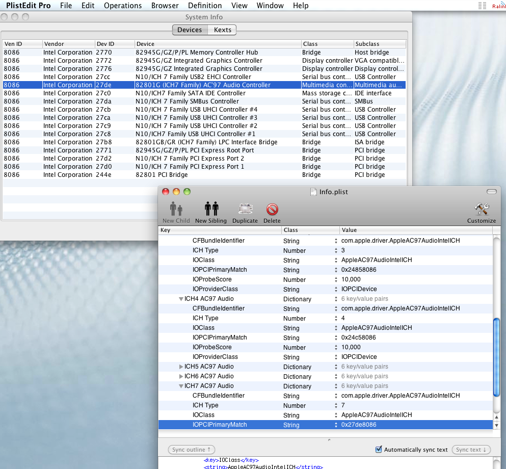

Ed24135 Posted May 22, 2011 Author Share Posted May 22, 2011 OK I checked the plist and the ID in System Info (Class ID: 0401) isn't there so, what do I put in and where? Link to comment https://www.insanelymac.com/forum/topic/255495-snow-leopard-1067-issues/page/2/#findComment-1687322 Share on other sites More sharing options...
Dellmantt Posted May 23, 2011 Share Posted May 23, 2011 Example for ICH7 chipset Vendor 8086 Device 27de The ifo.plist to be edited is "AppleAC97Audio.kext/Contents/PlugIns/AppleAC97AudioIntelICH.kext/Contents/Info.plist" Link to comment https://www.insanelymac.com/forum/topic/255495-snow-leopard-1067-issues/page/2/#findComment-1687352 Share on other sites More sharing options...
Ed24135 Posted May 23, 2011 Author Share Posted May 23, 2011 I checked again and it's identified as ICH5 ID:24d5 8086. Does this mean it's identified correctly, or if not, what ID do i replace it with? This is my audio from the Documentation: AC97, Sound Blaster Emulation, ADI 1980 audio controller with 2.1 implementation EDIT: I think I found the correct ID (AC'97 Audio Controller CardVendor 0x1028 card 0x019d) will try editing it and seeing what happens Another EDIT: Tried it and no longer have audio. I don't think i did it right. Link to comment https://www.insanelymac.com/forum/topic/255495-snow-leopard-1067-issues/page/2/#findComment-1687361 Share on other sites More sharing options...
Dellmantt Posted May 23, 2011 Share Posted May 23, 2011 That ID is already in the plugin info plist <key>ICH5 AC97 Audio</key> <dict> <key>CFBundleIdentifier</key> <string>com.apple.driver.AppleAC97AudioIntelICH</string> <key>ICH Type</key> <integer>5</integer> <key>IOClass</key> <string>AppleAC97AudioIntelICH</string> <key>IOPCIPrimaryMatch</key> <string>0x24d58086</string> <key>IOProbeScore</key> <integer>10000</integer> <key>IOProviderClass</key> <string>IOPCIDevice</string> Sorry no other suggestions apart from keep searching OR try VoodooHDA Are you still using the 8400GS, if so does it also show as an audio device in "System Info App" Mine does_ "10de;nVidia Corporation;0be3;High Definition Audio Controller;Multimedia controller;Audio device" Link to comment https://www.insanelymac.com/forum/topic/255495-snow-leopard-1067-issues/page/2/#findComment-1687367 Share on other sites More sharing options...

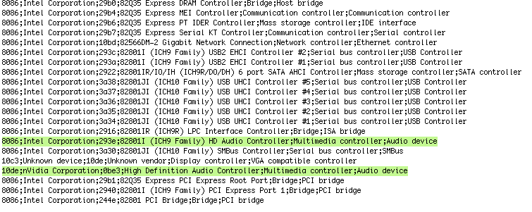

Dellmantt Posted May 23, 2011 Share Posted May 23, 2011 What I meant was that if the Nvidia card was being also being identified as an Audio device, it could interfere with the on board audio like this post http://www.insanelymac.com/forum/index.php...t&p=1511103 Output of "System Info App" for optiplex 755 with 8400GS VGA/DVI (no HDMI). As you can see it Identifies the card as both a video & audio device. Just wondered if it was relevant to your problems. Link to comment https://www.insanelymac.com/forum/topic/255495-snow-leopard-1067-issues/page/2/#findComment-1687379 Share on other sites More sharing options...
Ed24135 Posted May 23, 2011 Author Share Posted May 23, 2011 Nope, it's only identified as a display controller. Link to comment https://www.insanelymac.com/forum/topic/255495-snow-leopard-1067-issues/page/2/#findComment-1687381 Share on other sites More sharing options...
