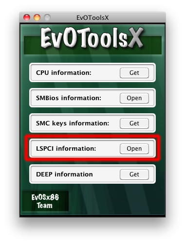

use EvOToolsX
http://www.insanelymac.com/forum/index.php...st&id=87693
and see where the patch should be applied

Can you please give me some advice how to use EvOToolsX?
How can I check very the patch (for firewire I guess) has to be applied?

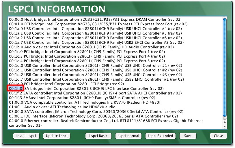

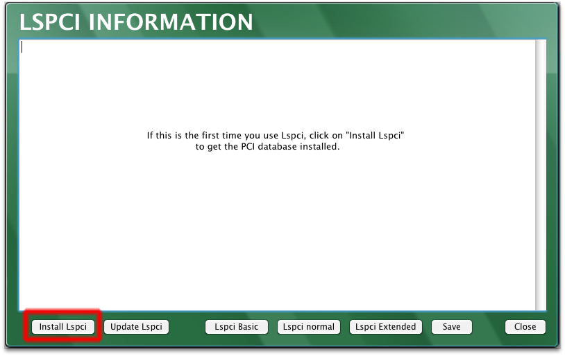

Example device Lpc
how to locate the device
my mobo has no firewire :D
Device (LPCB)
               Name (_ADR, [b][color="#FF0000"]0x001F0000[/color][/b])
               OperationRegion (LPC0, PCI_Config, 0xA4, 0x02)
               Field (LPC0, ByteAcc, NoLock, Preserve)
                   AG3E,   1

I have tried to follow you suggestion.
If I have well understood the trick was to identify the address of the device (Firewire) using DSDTToolsX. Correct?
So I have done. Extracted the DSDT from my system, applied the patch changing the correct address then recompiling.
