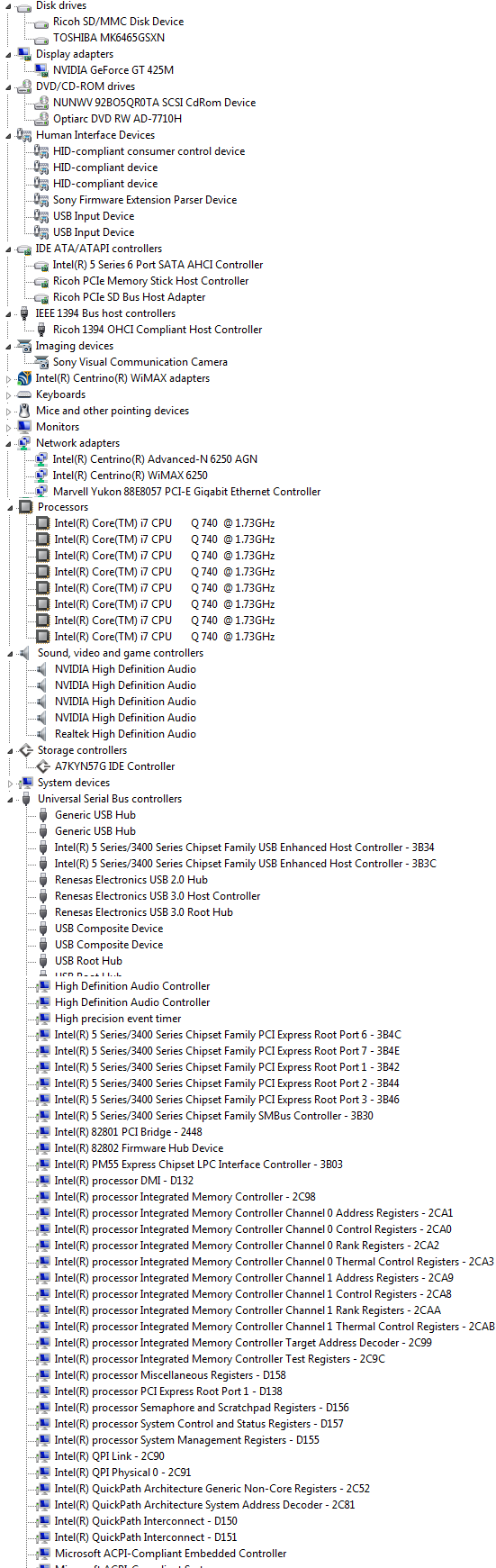

I have a Sony Vaio VPCF13YFX laptop and am encountering a few problems in my install. I am used to installing and am a pretty good computer user, but am quite stuck when it comes to identifying errors that need to be changed on the Mac Os.
My computer specs are:
Nvidia Geforce GT 425M (1 GB DDR 3 Dedicted VRAM)
Toshiba Sata Drive (640 GB)
Mac parttition is 40 GB.
6 GB DDR3 Ram
Intel Centrino Advanced-N 6250 AGN (wireless)
Intel Yukon 88E8057 PCI-E Gigabit Ethernet Controller
Intel Core i7 Q740
Nvidia High Def Audio / Realtec Hi Def Audio
Intel 5 Series/3400 Series Chipset Family PCI Express Root Port
Intel 82801 PCI Bridge - 2448
Intel 82802 Firmware Hub Device
Intel PM55 Express Chipset LPC Interface Controller - 3B03
MOBO:
Sony VPCF13YFX
FSB:
Intel QPI

I eventually got macOSX 10.6.6 snow leopard going on this computer. It even boots without any command arguments.
The only things i cannot get to work are:
Marvell Yukon 8808E57 ethernet card (which seems to not be made yet or not well known)
Hardware ID PCI\VEN_11AB&DEV_4380&SUBSYS_907A104D&REV_10
Nvidia Geforce GT 425m
Hardware ID PCI\VEN_10DE&DEV_0DF0&SUBSYS_907A104D&REV_A1
(I have installed the Nvidia drivers from the site, and the Mac CUDA drivers but idk how to ensure it recognizes it to its full potential)
Realtec Hi-Def audio
Hardware ID PCI\VEN_10DE&DEV_0BEA&SUBSYS_907A104D&REV_A1
(I am unsure how to determine exact model, like ALC88 or whatever)
Hardware ID PCI\VEN_8086&DEV_0087&SUBSYS_13018086&REV_5E
USB and keyboard worked when i selected the right kexts, ill post a kext list after my class, but at first it did not recognize the keyboard.
